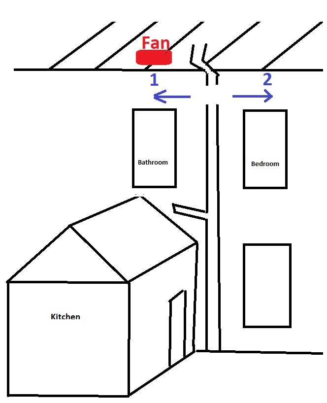

If I have a Vent Axia inline fan installed in the loft above the bathroom, I could relatively easily have it vented via expanding pipe across the attic until above the bedroom and out there (location 2). It means only a ladder is required to cut the hole.
However, a shorter route, meaning the expanding tube is *not* positioned above the bedroom means having to construct scaffolding to try and get to the location to cut the hole (location 1).
The additional distance is about 2.5m
Do you think the shorter route will make any particular difference to noise emitted from the tubing? I'm not sure how noisy these things are once activated, if they're not particularly noisy then it may not make any difference.
Thanks.

The fan itself will be the noisy thing. Plus if it is the usual minimum airflow as required by building regs it'll struggle to push air through a longish duct of any type. Better off using rigid pipe where you can (reduces drag within the pipe which thus reduces any noise from airflow)

What I was wondering is if the outlet is positioned as location (2) then that means the tubing is over the bedroom and so is the outlet, and so would this produce more noise for any occupant below. Though it sounds as if it won't make much particular difference.
the vented inline fans are generally significantly quieter than the cheap builders fans, as well as more powerful.
Furthermore it is not in the room, but up in the loft.
You can mount it on a piece of ply, isolated with thick carpet or rubber mat, to deaden the sound still more.
You will be using insulated duct, or wrapping it in mineral wool quilt, to prevent condensation, which will also muffle noise.

the ducts are full of steamy air, and the loft is cold, so unless insulated, the ducts are prone to condensation.
Slope them slightly down towards the vents outside. Rigid ducts are less of a problem than flexible, which can trap water and fluff.

I think your query is whether the outlet itself is noisy? So running it over a bedroom may disturb someone?
Imho just mount the fan on neoprene or something so that the entire loft doesn't vibrate and get it high enough so that any condensation naturally drains out . You can insulate the output duct for warmth but it shouldn't actually make much noise
Choose the vent output carefully as the one in my kitchen rattles. You may be better to just have a hood and install a weighted back draught stopper in the loft
