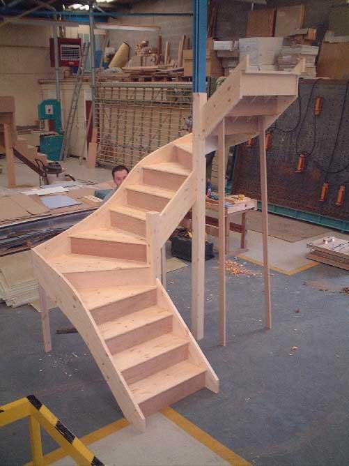

I've been thinking about doing something similar, and have the same issues as you.
I don't want to lose the third bedroom at first floor level as it will then be used as an office / guest room, but also, it's unlikely that I will fit a staircase into the existing landing space.
My idea is to make the third bedroom slightly shorter, but then steal a bit of space from the adjacent bedroom (which is much larger), so it's still usable.
It will still be tight though, so I think I need a double winder staircase, which will allow for more treads in a shorter space. Making the staircase narrower will also help if using a double winder, but you have to think about the practical aspects of using it and getting furniture up and down it.
Something like this:
mr vander, it certainly looks like you will be better off reducing the size of that front room. it seems as though you will have a hard time trying to keep the clear head height of the lower staircase otherwise.
The other problem you are going to run into is that the stairs will end up coming up right in the middle of your loft space. I am assuming that your roof pitch is lowest at the left and right of that image... this means you are using the tallest usable spaces for the stairs, when you ideally want this for the room. Now, this may not be a problem as long as you are able to put in a dormer... and of course depending on the actual roof heights you have...
I suggest you need to appoint a designer to come in and have a look to assess the feasibility and take a proper measured survey to work it all out.
