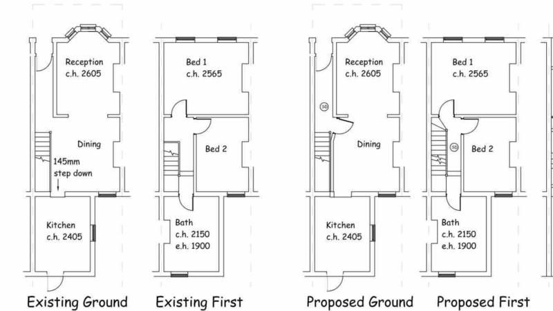

    I am currently mid-loft conversion build in Brentford, Middlesex and have just been informed by my builder and architect that they missed out telling me a crucial piece of information. Apparently to meet building regs we must close off our Ground Floor open plan living/dining room as part of the works. This has a huge impact on what we wanted to do with the property and completely changes the dynamic of the house (AKA we wouldn't have done the loft if we had know about this). My architect is useless and of no help at all. Can anyone think of a clever alternative than to what my architect has suggested in the plans below?

    I hope your "architect's" professional indemnity insurance is up to date. That is probably one of the worst mistakes I have ever seen. What a numpty and certainly not a qualified architect or architectural designer.
    Not used them myself but I believe you can have an open plan ground floor on a 2 storey with second floor loft conversion with a small domestic sprinkler system. Probably not cheap.

    A friend had a very similar experience. It comes down to the need to protect the escape route from the loft to the outside of the house. The stairs have to be closed off from ground floor rooms to prevent the spread of smoke and / or flames into the stair well and thus preventing them being used to evacute the building. There is a possible exempton if there is a safe way to evacute people from the loft via windows to the loft and a safe route from those windows to the ground. Sliding down a roof is NOT considered to be safe.
    As with the case of my friend's loft conversion your architect was negligent in not pointing this out to you before work started

    Sprinklers are around £2-4K though actually not all BCO's will accept them. Occasionally a mains interlinked smoke detector in every room will get you an approval but depends on the inspector and layout.
    Presumably this is being done on a Notice? That's the risk of doing it on a Notice but agree its a cock up by the designer, assuming the order of events is as simple as its been described.

    Or build the wall, put in mains inter-linked smoke alarms (this bit is vital), get BC sign-off. Remove the wall. Put the wall back when you come to sell. Incidentally, I grew up in a house just like your existing plan. The District Surveyor (as we called them back then), grumbled but in the end was happy that my parents provided a smoke alarm (battery powered of course). They live there still (my parents, not the DS).

    Thanks for all your comments guys. Our building control company has suggested that they will give sign off if we have a sprinkler system installed on the ground floor to compensate. We are now looking to install a Plumis Automist system. It looks expensive but we will see what happens. In regards to the architects professional indemnity insurance. What legal action can we take?

    Check with the insurance company for their opinion about sprinklers instead of a fire proof wall. Check that they will pay for water damage after a false triggering of the sprinkler system
    Also considered the effect a sprinkler / mist will have on people evacuting the building in the dark.

    Have a look at mist suppression systems. I've not used one, but they start at about £500 for a (very) basic installation. But check with your BCO if this is acceptable to them.

    Just fit a Grade B LD1 or LD2 fire detection system
