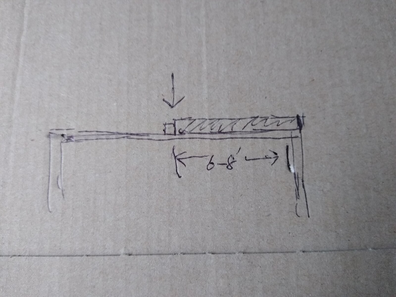

Also, if they only span from spine wall to binder they're going to be too short for a loft conversion anyway? Full length joists cantilevered over the spine wall might be better and could be repositioned if you convert and won't interfere with your loft insulation as much:

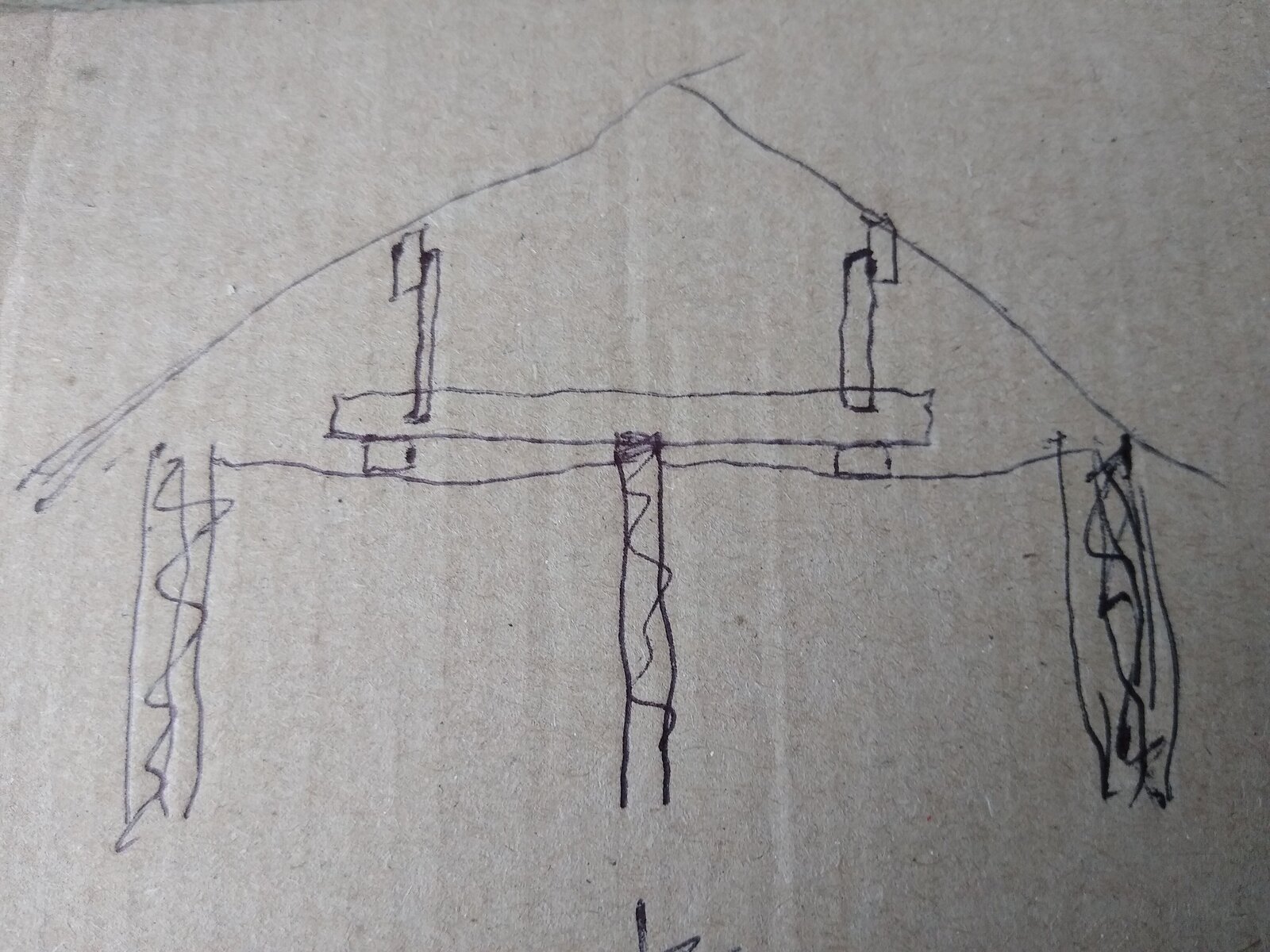

Full size joists spanning across is probably your best option but it really depends whether you can get in at the eaves to sit them on the wall plate - I guess this is why most people just stop short and hang them off the steels, also the shorter span may allow smaller joists and gain a tiny bit more headroom.
Obviously though, the steels (you'll probably still need them to carry dormers/dwarf walls if not the floor) can go above the joists - I did this on mine because the stairs came up the side under a steel and I needed the headroom.
In another house I built a platform like the one I drew, I had a lot of heavy stuff to store
and also didn't want to load my poor 3x2's either, (they already had nearly 50mm of deflection mid span!) I screwed the outer ends of the joists to the ceiling hangers and added a few more - I did wonder if it might sway a bit but it was very rigid.

If you shove a length of 4x2" down to the eaves then you can forget about resting things on the binder and rest your new floor joist on that, that will be stronger due to its location and if you chamfer the ends of the new joists to suite the pitch then you could also screw them to the rafter tails.
Yeah I’ve seen that suggested before. You mean just wedge the 4x2 as far in to the eaves as it will go? Then screw into ceiling joists? What’s the best method for getting around the 7x2 binder at mid span? Notch it out and attach it to new joists?
