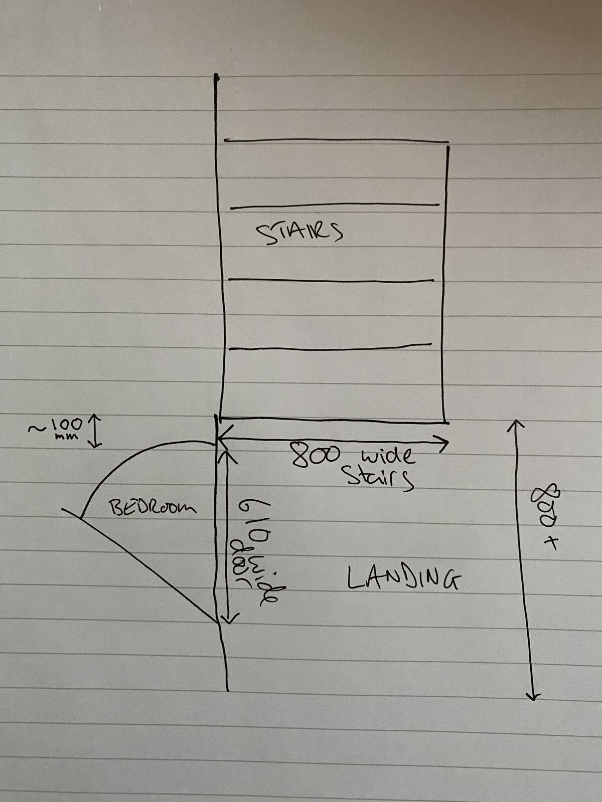

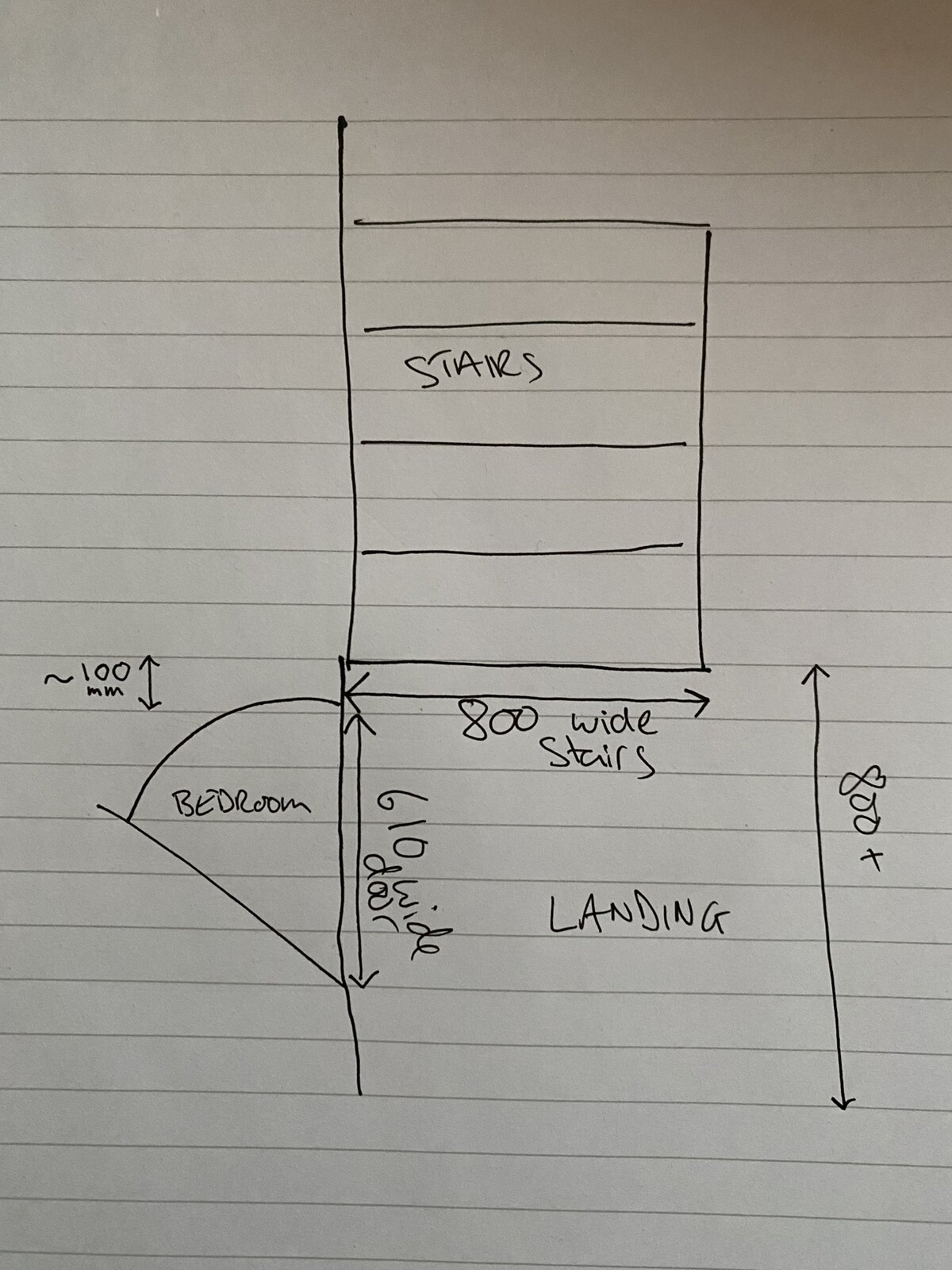

Hi,

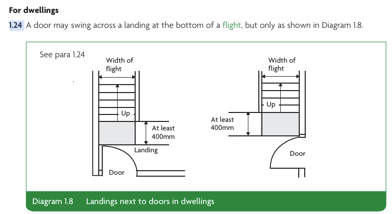

I’ve read through article K in some detail and also trawled through LABC articles and comments and I can’t find a straight and direct answer. So I’m hoping there may be someone here in a particular role, able to help.
I have an 800 wide stair case rising to a loft conversion. At the top of the stairs in an open landing space plenty big enough. At the top of the stairs, perpendicular to the right, is a bedroom wall and door framing. The door opens into the bedroom, away from the landing.
Ive seen the regs around dimensions for doors opening over the landing but nothing to clearly state a distance between the top of stairs and a door frame for doors opening away.
I’ve attached a diagram.
Anyone got any first hand experience of this?

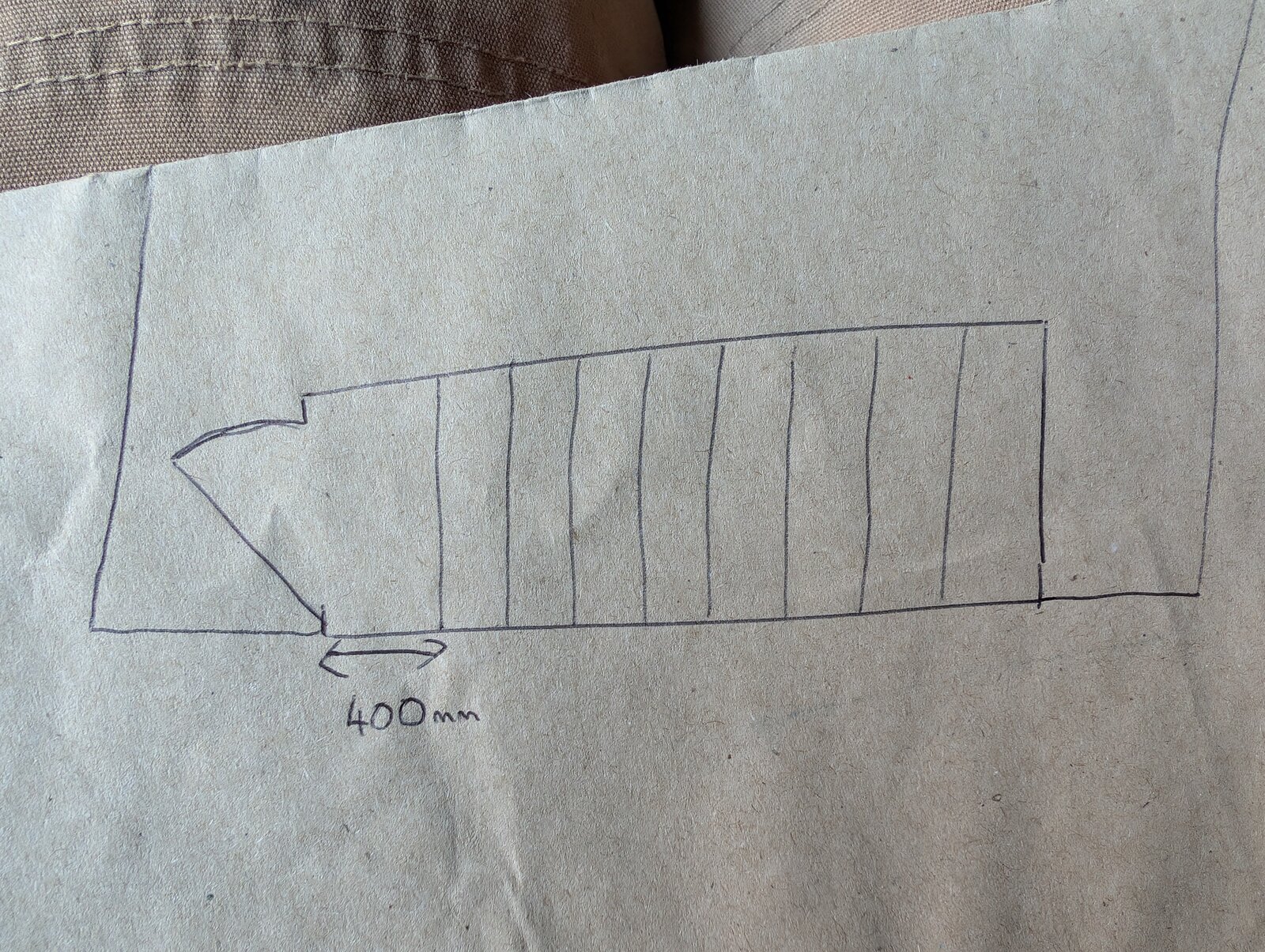

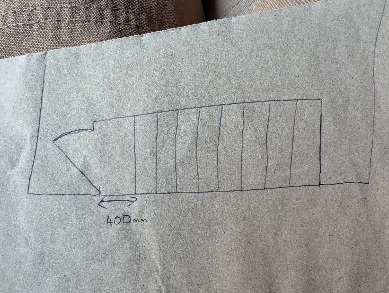

Hey everyone, I'm in the same situation (struggling to interpret Doc K and the much conflicting info out there). Would someone be able to advise me on whether the following layout would be ok please (please excuse my rubbish drawing!)?
My interpretation of Doc K is that I need a stair width, not 400mm, but I have seen conversions with 400mm odd where the door opens into the loft.
I am having proper plans drawn up, but I want to be informed in advance of this because I am doing the floor structure now (all structural calcs have been done by an SE already), and also so that I can be armed with the correct knowledge if I come across some opposition from the tech or council.
As always, thanks for your help guys, invaluable!
