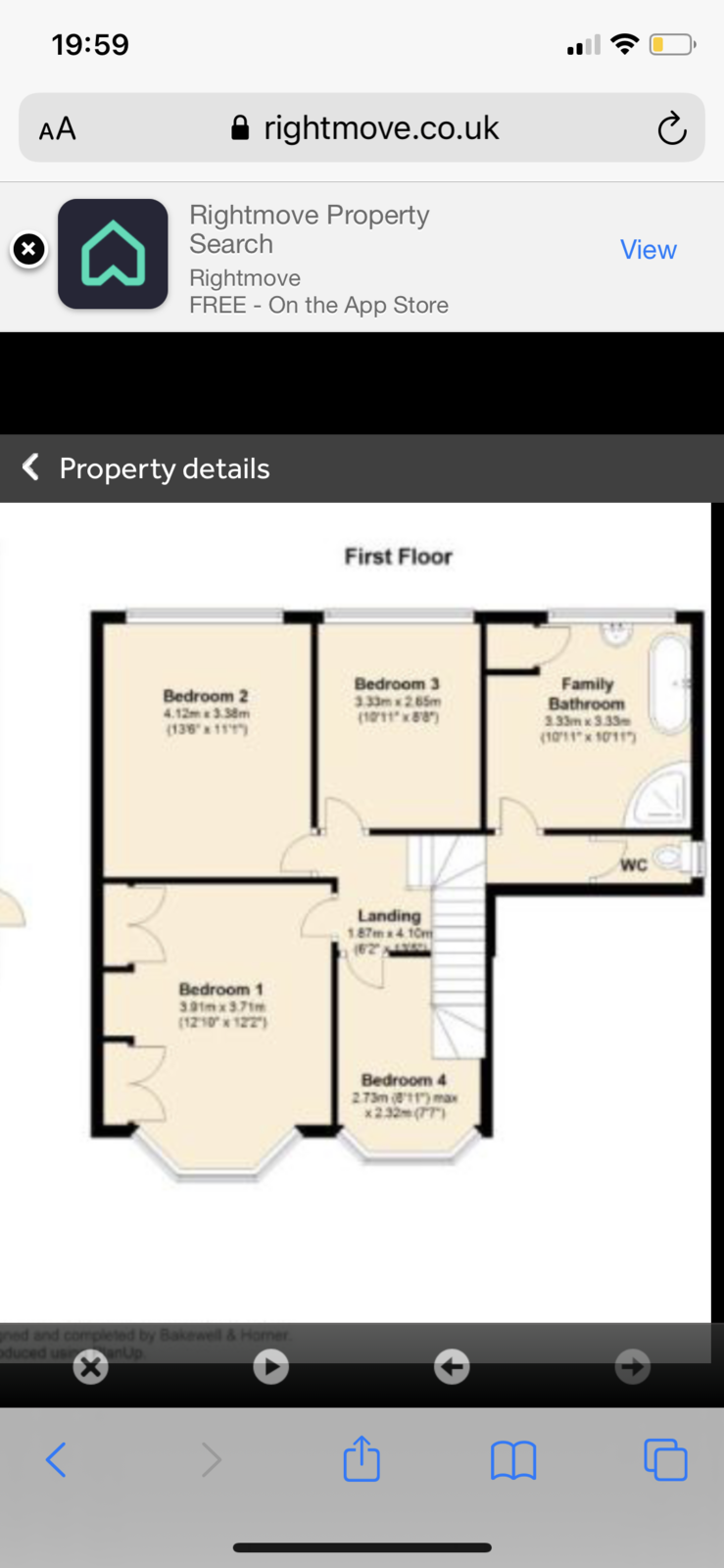

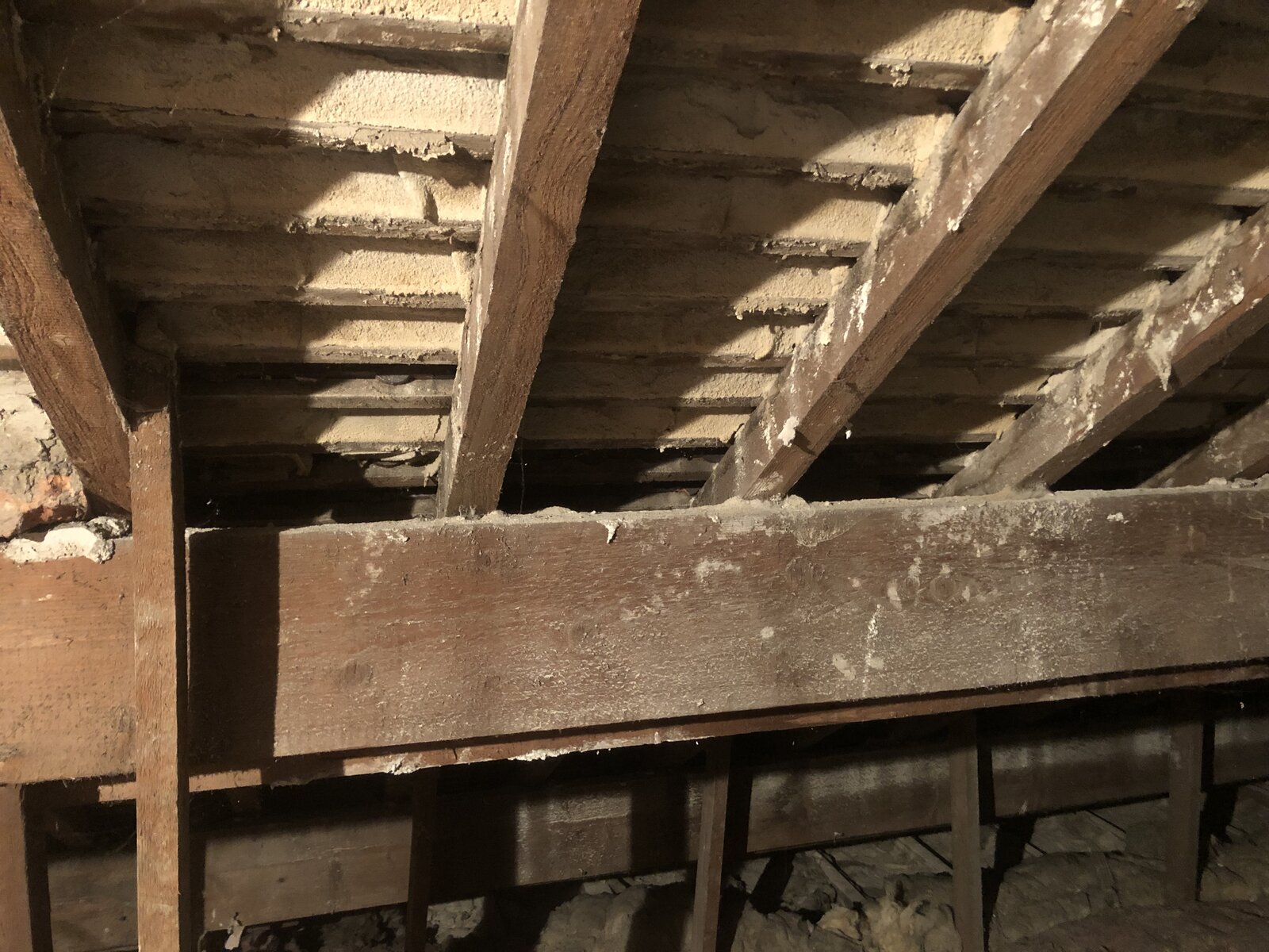

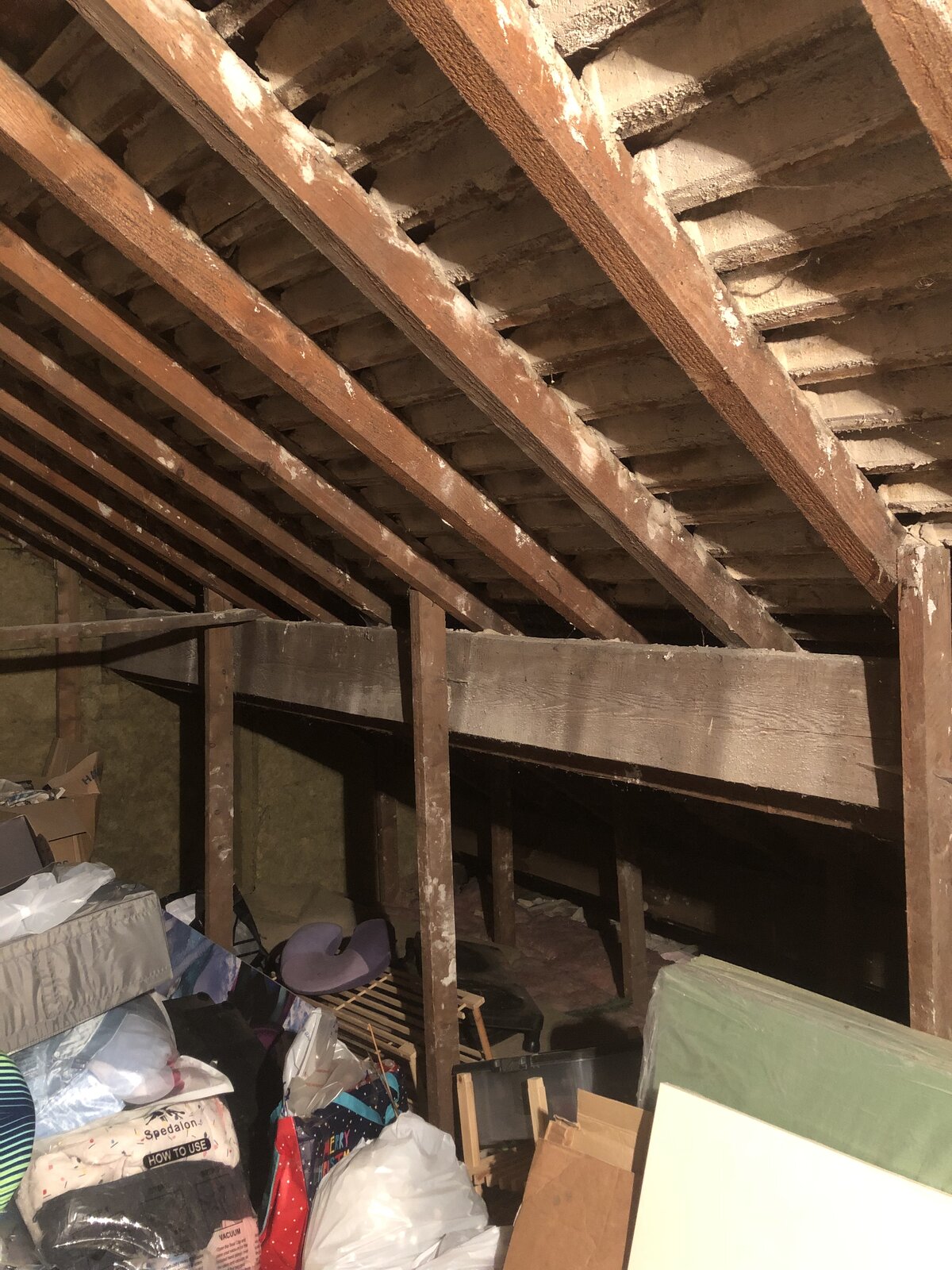

Loft joist are 30mm X 70mm and 400mm apart across the loft. Lengths from supporting walls am not 100% sure on this below is the layout of upstairs.
Roof hasn’t got any felt/membrane it’s just tiles. Below are a couple of pictures, we just need it for storage space and will be walked across every now and then to put stuff up/take down.
The loft ends between bedroom 3 and the bathroom. Bathroom has its own small loft above it.
32 X 50mm joists are the minimum recommended size for the Loftzone system.
So yours should be fine.
...and if you want to keep stored items as free from dust as possible, you can tack a breather membrane below the rafters.
An alternative method is to run timbers across the joists, running lengthways. Decking timbers are easy to find and quite cheap. If these are screwed down tightly, they will help spread the load when you are clambering about, and stiffen the floor. You can screw down large sheets of ply onto the battens, it will give you quite a stiff deck and reduce the risk of cracking the ceiling below. You can run mineral wool insulation between the joists, and another layer between the counterbattens.
I would put a floor in the area between the purlins, you can't walk beyond that into the eaves. But keep a spare piece of board to kneel on if you need to work in that area.
