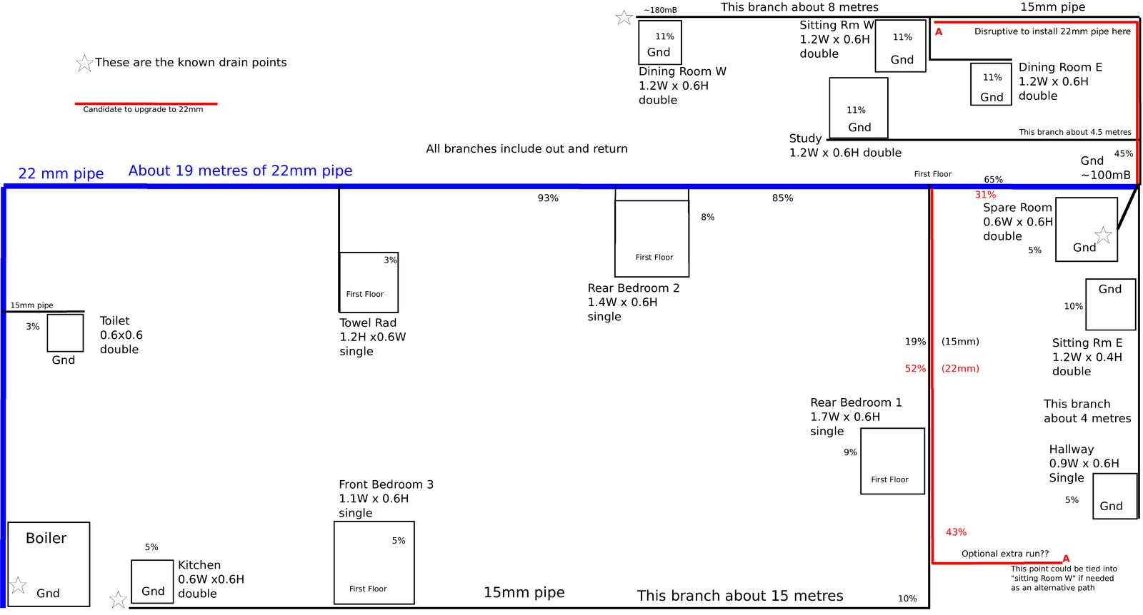

using that and the nominal figures of power for each rad I ended up with is as the pressure loss each way to drive the heat through the rads, I know that at max bypass pressure I can get 350mB from my combi pump, your figures may be different.
I have worked out there are two places where I could extend the 22mm spine of the system, both choices reduce the max pressure drop, so would help but will cause cost cost and upheaval to fit.
You could do your own version of the diagram.
this site goes into a lot of theory, and also discusses that occasionally you might need a 15mm out to stop it taking too long to heat up, but a 22m return helps keep the pressure and lifetime pumping costs down a bit.
