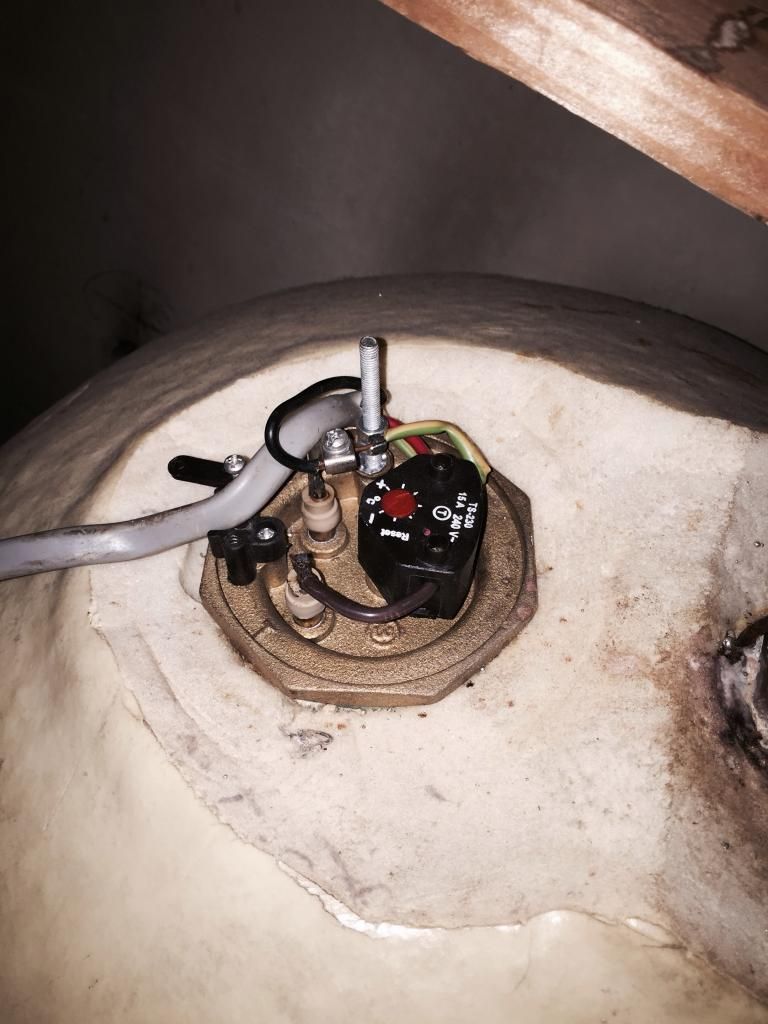

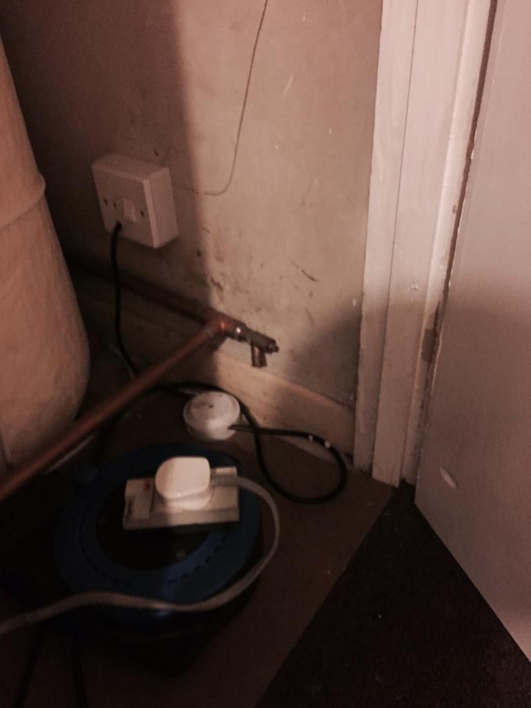

This is a Emerson heater at my dad's house he has just got fitted by some plumbers
They have plugged twin and earth into a plug top. Shouldn't this be heat resistant flex? It has burn the plug out
Or should it go straight into the fuse spur, the fuse spur on the wall used to feed an old power shower but is no longer used.
Also they have used red/black cores t+e
Thanks in advance
Well i hope their plumbing is better standard than the electrical work ! Otherwise expect a flood :shock:
Get an electrian to wire it properly using heat resistant cable and wire it into a DP Switch.

Yes should be wired in a heat resisting cable and direct to spur. The thermostat is only permitted with a metal header tank or a plastic one specially designed to stand boiling water. Not permitted with a thermal plastic.
The reset is required where there is another form of water heating so a fault with for example a back boiler could over heat the water. If only electric heating then non resettable is used.
Idea is if thermostat fails once it may fail again so once it has failed it wants replacing. But if the over heat is caused by gas or solid fuel heating then you don't want to replace thermostat because of a fault with the other system.

The OP has a high limit stat built in to his rod stat.

This looks like the sort of thing my plumber does to get the hot water back on over night before I come and wire everything up properly for them.
Are we sure that isn't what's happened here and an electrician is due to wire everything up properly?
Is my interpretation of the picture correct
an immersion heater wired in T&E?
plugged into some kind of block (maybe a plug in RCD? maybe a timer?)
plugged into an extension reel (is it fully uncoiled? I doubt it)
extension reel wired into a junction box sitting on the floor?
connected via another peice of flex to a FCU.
YUCK.
What exactly was it that burnt out? if it was literally the plug pin and the thing it was in contact with then I suspect the most likely explanation is a bad contact. If it was the extension reel then I would expect the cause to be heating from the cable not being fully uncoiled.
