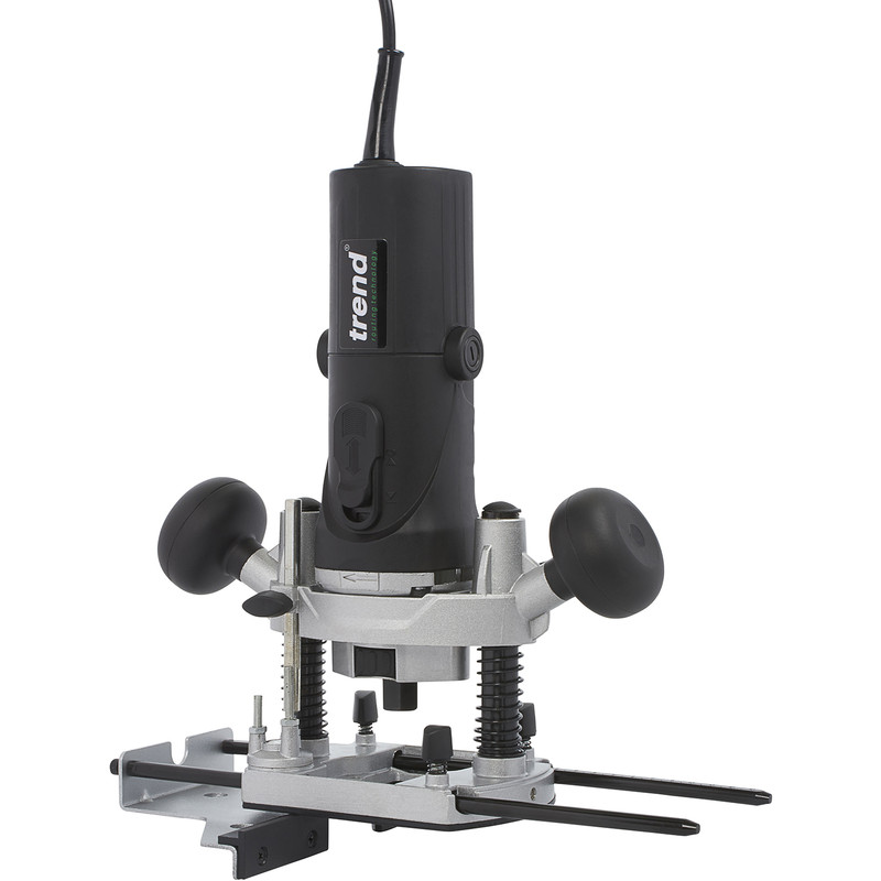

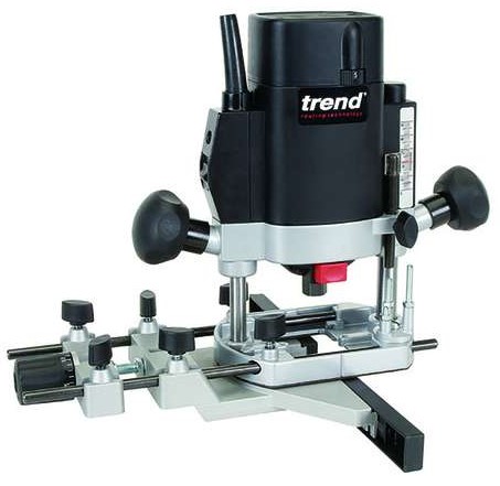

Trend T5 or alike:
or a Trend T4:

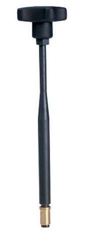

with a Trend vertical height adjuster, one of these (this is the one for the T5 - Trend do others for different routers):
They replace the depth flag and screw into the top of the depth stop turret to turn your plunge router into a screw adjustment router, for use in a table. Readily available in the UK with spares available (the T5 is fundamentally a deWalt DW615/Perles OF808e/Virutex)

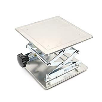

Another vote here for a trend T5. I've also had satisfactory results using a cheap ebay "lab jack". nice little things!
Nozzle
Yes, I was going to mention the other way - using a car jack beneath the router to effect a rise and fall, but the lab jack is far more appropriate

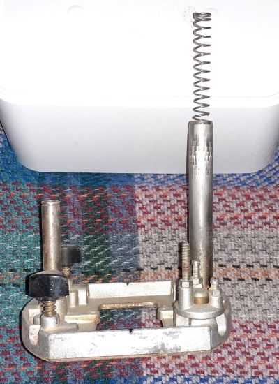

The T5, like the deWalt DW615 it is based on, and the original Elu MOF96 that was the origin of both, has one spring (it's actually a fairly light and compact router and doesn't need two). It can be a pain to remove and replace because you need to strip the top of the router off to get at the fastenings. Once you've got the spring out there is no way you can take the router our of the table and use it hand held without reversing the process. In any case with the Trend fine height adjuster there really isn't any need to faff around doing this as the adjuster allows you to wind the router up and down readily against the spring which also means no chatter whatsoever, although it is advisable to lock off the rise and fall when running the router to prevent vibration causing the depth to change (which is no different from any other router in a table)
I still have an old Elu MOF96e (currently in bits, see below) with the little Elu miniature router table and I have never had any need to "despring" the router when used under the table with the fine adjuster. Here is the column and spring from my MOF96e, which is the same arrangement as the T5, albeit over 30 years older than Conny's tool, note the single spring:
