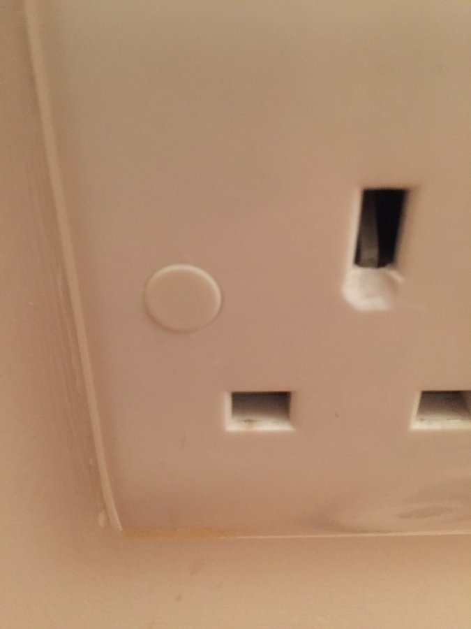

I'm looking to buy this small round screw sealer in the electric socket, I'm missing quite a few around the house.
I couldn't find it online but very possibly because I wasn't looking for the right search term (unless these get sold with the socket only?)
Usually supplied with the socket, I don't remember ever seeing them on sale alone. Some socket manufactures give you spare ones though, attached to little pegs on the rear of the socket, so worth a look there first.

Yes, I only fit them if the customer insists, otherwise they stay on the little pegs as supplied.
best way I found for removing them is a piece of blu tack and stick it on and twist it a few times until the grease comes off, then it'll pull out after that. Or just jam a screw driver through it and chuck it.
Hager actually will sell you 100 spares, with the brilliant part number SCREWCOVER
I'm aware this socket is not Hager, but other manufacturers might sell you them, just need to determine what brand it is. Could be BG/LAP but can't see enough of it
