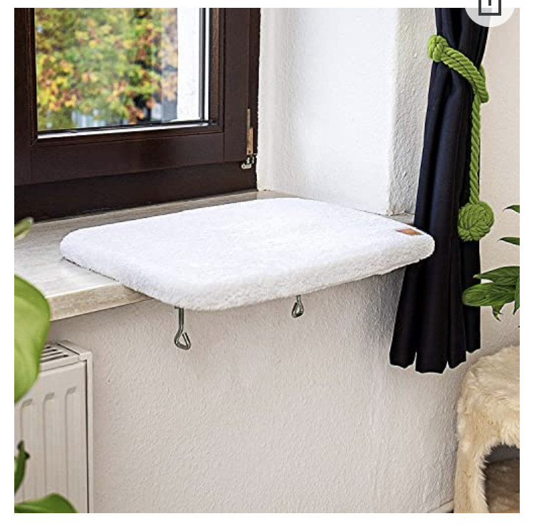

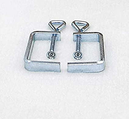

I’m looking to make my own cat perch for a fat cat on a narrow window. I know the type of clamps I need, yet despite searching for weeks cannot find anything suitable, a caveat being I’m new to DIY, so probably lack the language to accurately describe what I need.
So I’ve attached an image and hope those with more experience will help.

That was one of the terms I searched for (and g), but I could only find clamps with a curved top, and I need flat unfortunately. Unless you know a place (UK or online) that supplies flat topped ones.
Although it’s good to know the proper name, thanks.

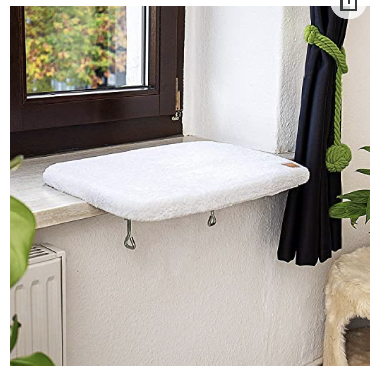

I’m trying to reverse engineer a fancy perch I can’t afford. I have the other parts laying around having just done some chair reupholstering. (Plus this solution leaves space for plants).

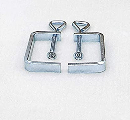

This, but it needs a bigger diameter. Like 50mm, to be sure. I’d also prefer a reputable (known) manufacturer. I have a Petzl carabiner on his harness because they’re load tested. Are they called Table force screw clamps?

This one will. My dwarf sunflowers are in danger from his weighty presence. Sorry, as I said in my previous post, I messed up the quote thing. It’s almost the one, just needs a wider diameter.

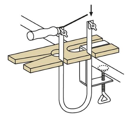

@freddiemercurystwin - those aren't "table clamp force screw clamps" (effing Chinglish!), they are fretwork clamps, and from memory were available in 1in, 2in and (sometimes) 3in sizes, but they are really weak and bend very easily (being made from bent mild steel strip and designed to hold only small light pieces of timber or thin plywood whilst it is sawn with a fretsaw). I think they would be utterly useless to hold anything of any size or weight for any length of time without the jaws opening, after all they are only thin, bent mild steel

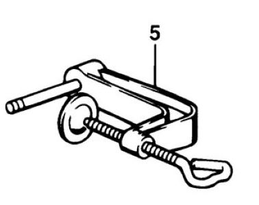

The nearest thing I can think of which are strong enough to potentially hold any amount of weight are those machine clamps with cast aluminium bodies where the top of the "G" is an 8mm diameter rod and are designed to go into an 8mm hole drilled into the edge of something like 18mm MDF

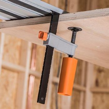

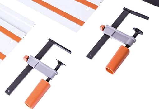

One difficulty is that I don't think these are made any more (Elu disappeared about 22 years ago and deWalt ceased selling these maybe 15 years back when they stopped selling the Elu-designed router tables). I for one have been unable to find an alternative manufacturer, although there surely must be one (in Germany). A modern equivalent might be the saw guide rail clamps such as these cheap ones from Evolution:
What you can't see in the above photo is the long, flat top of the "G" which is hidden inside a slot in the guide rail. To hold a sheld ther would need to be a hole drilled through the platform (no need for anything fancy, cats really aren't that fussy in my experience)
The issue, however, might be weight and overhang. The greater the weight of the cat and the greater overhang of the platform, the bigger and stronger the clamps will need to be. Frankly, I'd just make the platform out of 18mm MDF so that it runs right across the window board to the window and I'd screw through it into the window board with 3 or 4 no 4.0 x 40mm screws, as @foxhole recommends. When you leave, unscrew it, fill the holes with 2-pack filler and touch in with a bit of gloss paint

what is the gap under the window cill to the wall it looks like 20mm mark ??
if so clamping to the front lip will not be secure enough for a jumping cat unless the overhang is minimal perhaps 50 mm ish
just realized its not an actual picture off the window so need to know the actual overhang
@JobAndKnock Unfortunately I have uPVC windowsills, so I can’t drill and fill. I was going to drill a hole in the mdf (as you suggested) and slide the clamps in there. Can I get around load issues using extra clamps?
@big-all The windowsill itself is about 150mm, with an additional overhang of about 100mm. I hoped that by drilling holes for the centrally positioned clamps I could avoid load instability.
