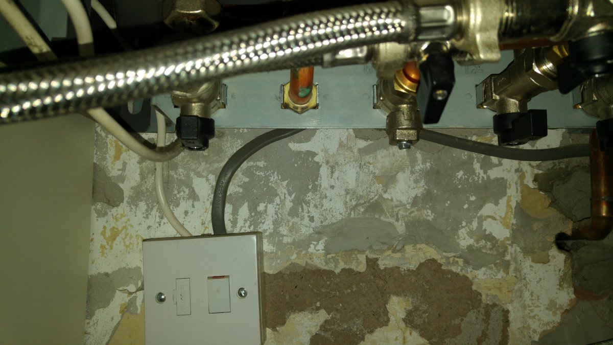

Hi,
Have been losing pressure constantly for a while now and recently have to top the boiler up every few days. There does appear to be a leak from a valve on the back left of the unit - would this be as simple as changing a washer on this? Also, today the hot water won't go on - the heating however works just fine.
Any help would be appreciated. Thanks
Without seeing the boiler I cant be sure what is wrong but if you have been topping the pressure up constantly then the system water will be contaminated, havent a clue what is leaking without looking at it but the no HW scenario, best case the DHW diaphragm needs replacing worst case scenario diverter valve service kit or new diverter valve, think it best you get an experienced RGI in to have a look, doubt it will be a quick fix
"A valve" is a bit too vague to get useful answers.
A photo might help.

Had a guy round and the micro switch for hot water plus the diaphragm have gone. I'll add a pic of the valve (far left) - but he reckons that needs replacing and was the cause of the pressure loss issue. Any ideas how much I'd be looking to pay for the job
? Cheers
Diaphragm on these very common to go but have never heard of the micro-Switch faulting doesnt mean it couldnt though but a very easy test to find out
The engineer showed me how it wasn't switching but it did if he did it manually. ie with his finger - seemed to add up
well if it switched with his finger its the DHW diaphragm and nothing wrong with the micro-switch

Very common issue with the 105E and HE but a simple and inexpensive fix
