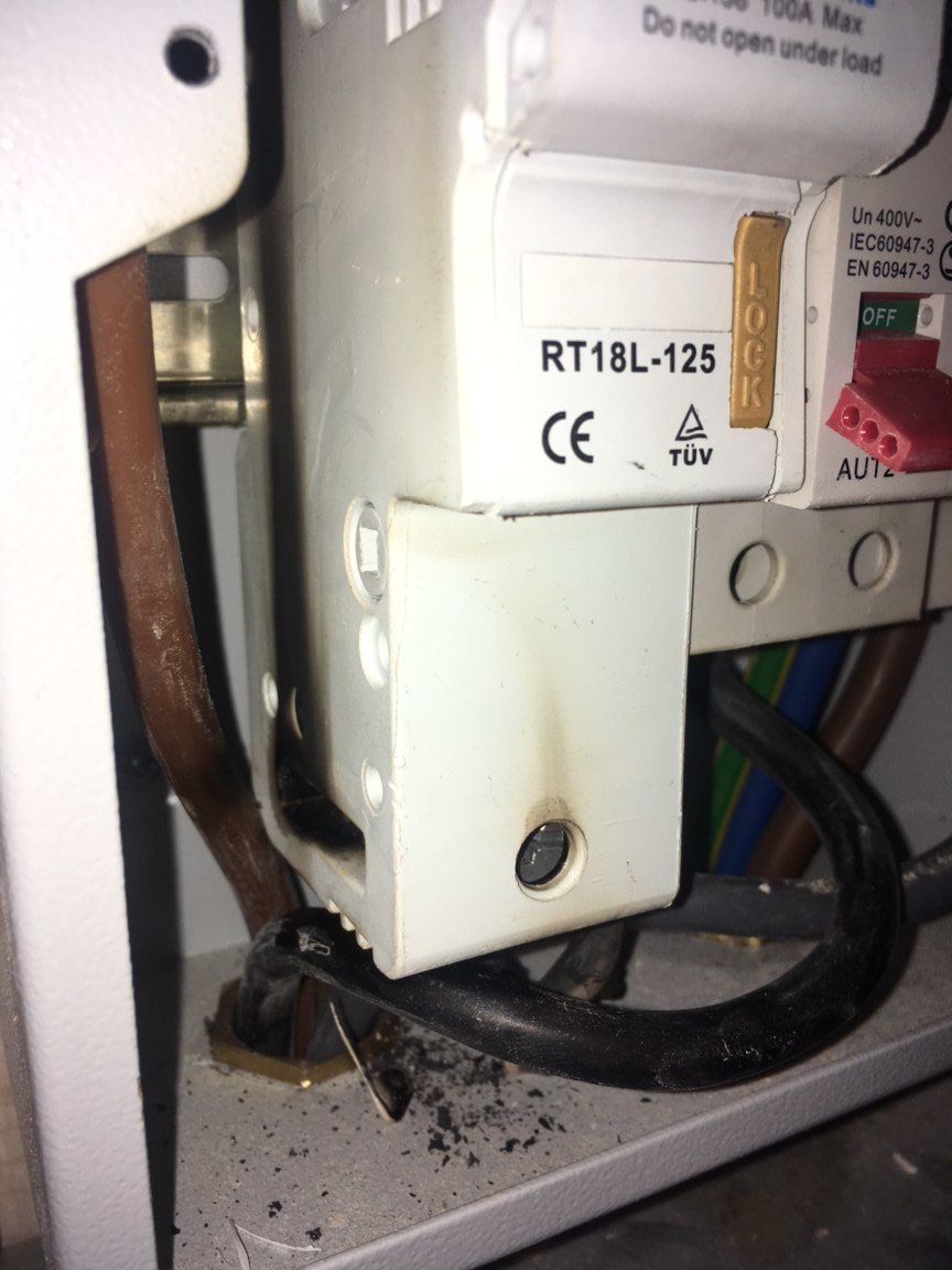

Hi,
I’m not an electrician so won’t pretend to understand anything. But I’ve just lost all power to my flat, nothing tripped off but the power had been intermittent on and off when ever it rains. I’ve visited the meter boxes and there were a smell of burnt plastic like when a capo blows and the sound of a staticy/arcing sound coming from the meter box. It’s worth noting my meter box was warmer than all the others so I just flicked it off.
What could cause this? I just can’t find anything online or find much documentation on the matter. It can’t be a power cut because all the neighbouring flat spots in the building are fine.
There’s no other switch boxes in between the meter and the flat that I know of.
Thanks in advance!
Phone your electricity supplier. There will be a number on your bill. Tell them what you just told us. If you see any signs of a tarry material leaking out, tell them that too.
It would have been interesting to see photos of your "meter box" and the cables around it, especially to gauge its age and condition, but that does not affect my advice.
Thanks JohnD, I needed up getting NG out last night to make sure it’s safe, the wires supplying the box were loose and had melted all their insulation. I can tell you the box is about 2 years old as it’s a newly refurbed building that had 1 meter for the whole building previously. I’m wondering if this could explain my £1,500 electric bill since December in a 1 bed flat that’s in barley ever in!
Got an electrician coming today so I’ll take some photos for interests/evidence sakes. (My energy bill is an ongoing argument between the lettings room, edf and myself)

Wow that’s serious.
Can you describe what that is a photo of. Also a picture of the whole thing and what it connects to will help.
I suggest you send it to the letting agent, building maintenance and environmental health. Maybe the fire brigade too!
It looks like the sheathing of the tails is damaged or the neutral is arching, get the Elec Board in to pull the main fuse the tails will still be live .

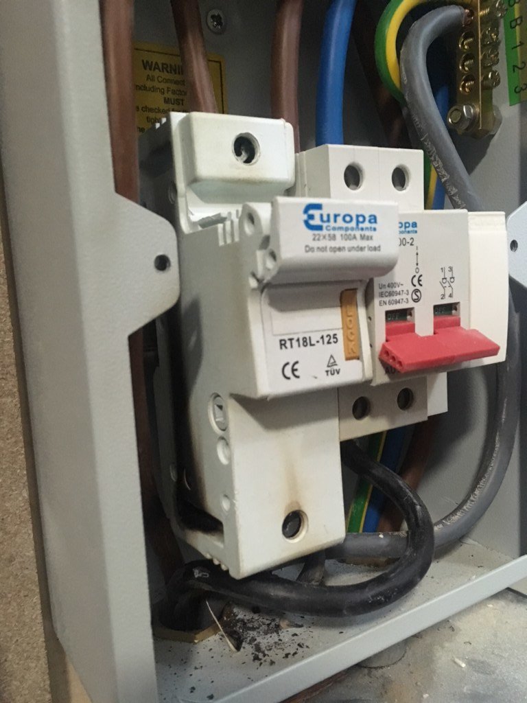

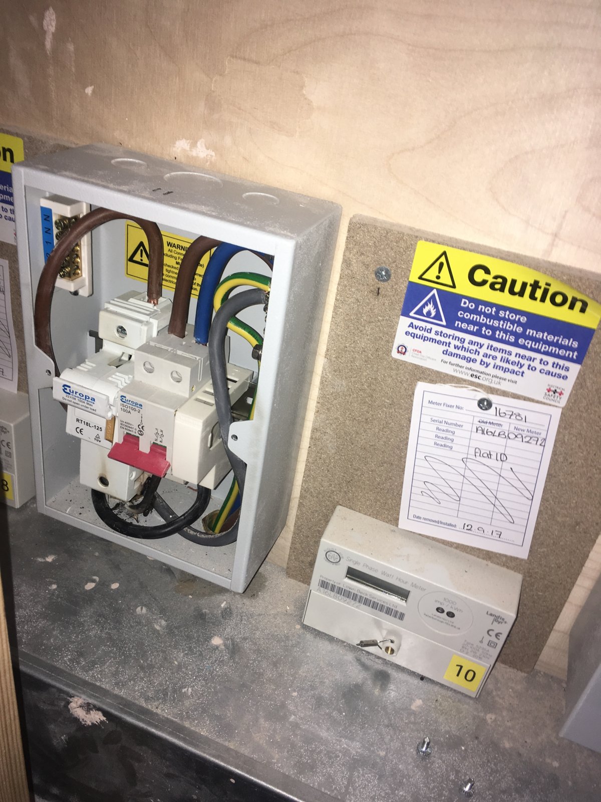

These are the best images I can provide as there is usually a case covering the internals. It’s basically a series of meters like this spanning the wall.
NG have visited and removed the fuse.

Ok. That photo shows it is the responsibility of the management company to fix that.
