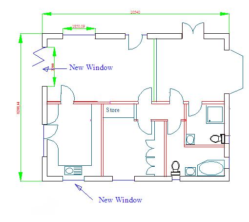

I have a problem in that I want to install a 2400mm bi fold door . The return is about 600mm, the return in the adjacent wall to the next window is 1100mm. I suspect that the rules wont let me do this. I spend hours on t'net, can't find any sensible info. on this subject. Can anyone help?

A quick sketch or some pics to clarify things will hep. With regards to the flue, take a photo of the opening and then tell us where you want to stick the flue.

Do a sketch by hand and take a photo of it, add the photo to an album in your profile and post it here, it doesn't need to be anything fancy, tony set the bar pretty low so don't worry if it looks like a three year old did it.

A 600 return should be fine, particularly if it's a two-storey house.
(official guidance says 665 IIRC, but don't worry about that).

Actually, the position would be better if the house was two-storey rather than one-storey. This is because the additional weight would bear down on your return and enhance its' stiffness.
But still, 600 should be OK - I would be concerned if it was down to something like just two full bricks-length (440mm).

The return to the north is 1100mm, to the side (where the bi fold is) 760mm. So looks OK then?
