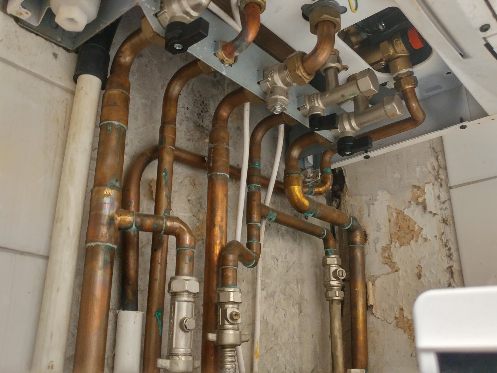

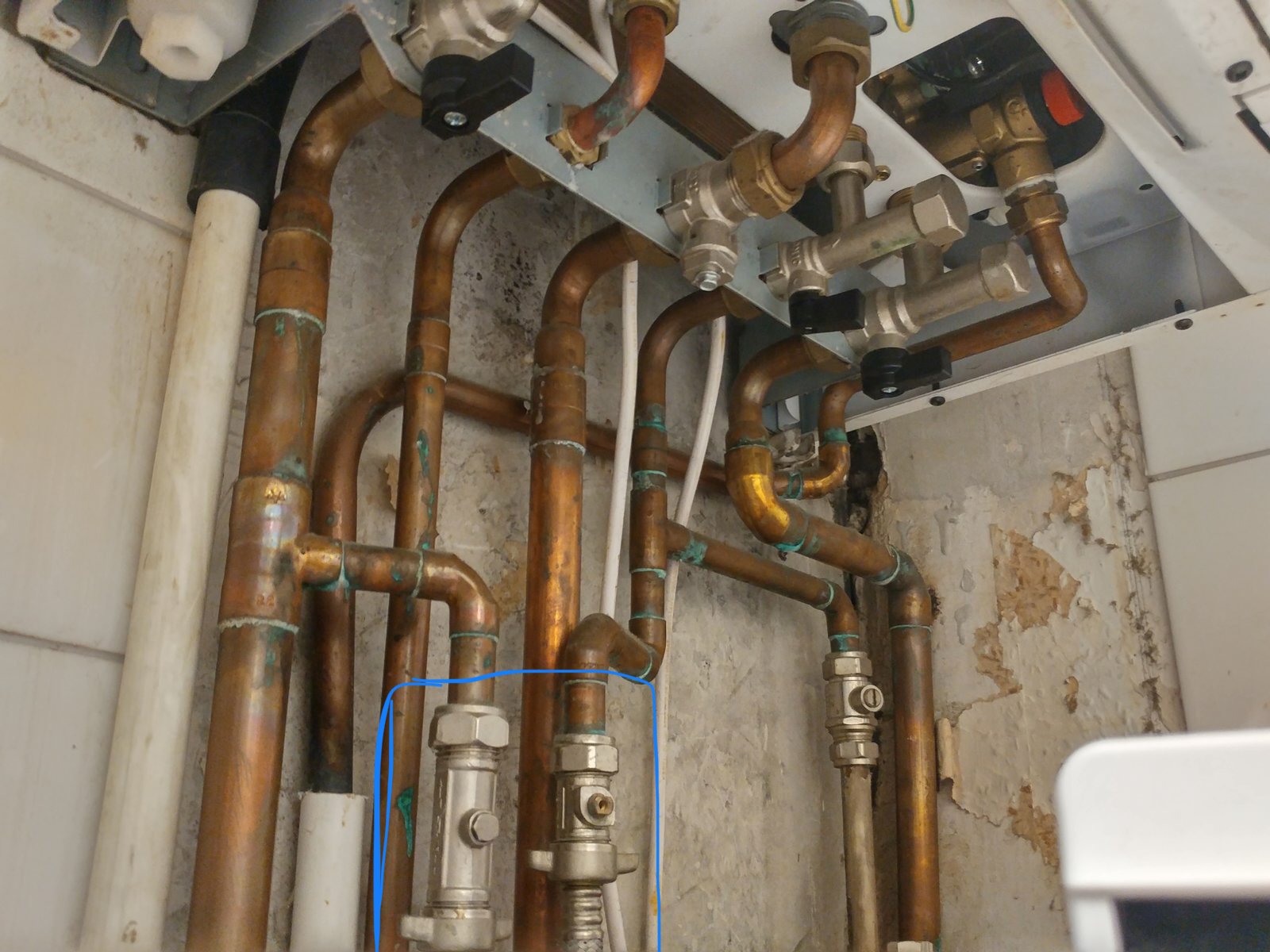

Hi there. I had a radiator that wasn't getting up to temperature so I bled it as it had trapped air.
Now that I done that the pressure on my boiler has dropped. Does anyone have an idea as to how I can get the pressure back up? Its a Baxi Combi Eco boiler. There is valves underneath but I dont know which one I am meant to operate to get the pressure up. I have attached a photo if anyone can give some insight.

Yes, the 2 I’ve circled look like they form part of your filling loop, the left one is a double check valve, the right one should have a handle on it. Use a pair or pliers/grips/spanner and turn it, get he gauge up to approx 1.5 bar and close it.
Thanks very much back in business. :)
