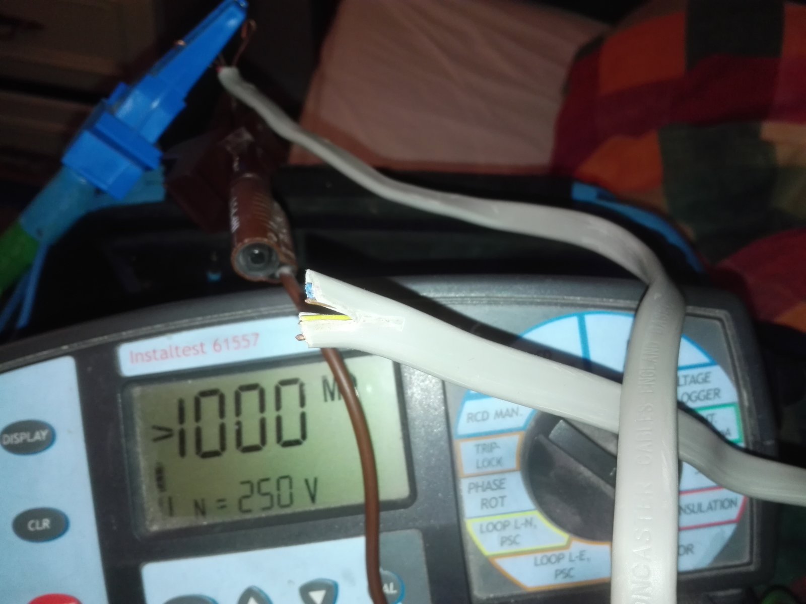

I have just tested the remains (about half) of a roll of old colour 3C&E I bought in 2004 and put in the shed in 2005.
I tested the MFT and it showed open circuit with the crocs apart and dead short with them together. Tested the cable on 250 and 500V and it showed >1000 meg.

I have just tested the remains (about half) of a roll of old colour 3C&E I bought in 2004 and put in the shed in 2005. I tested the MFT and it showed open circuit with the crocs apart and dead short with them together. Tested the cable on 250 and 500V and it showed >1000 meg.
Indeed, and I can 'better that'. I've just tested the (small) remains of some old-colours T+E which was already pretty old when I moved to my present house in 1987, and which has literally been continuously in my (detached) garage since then. Again, >1000 MΩ at all voltages, including 1000V - and that probably dates back to 1980 or thereabouts.
