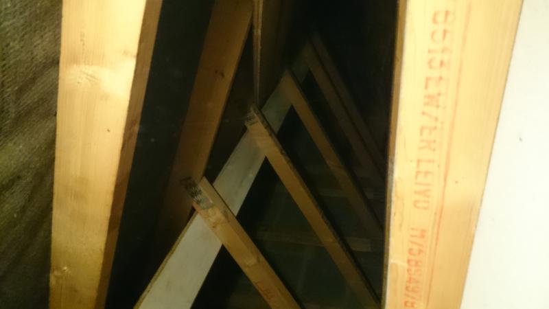

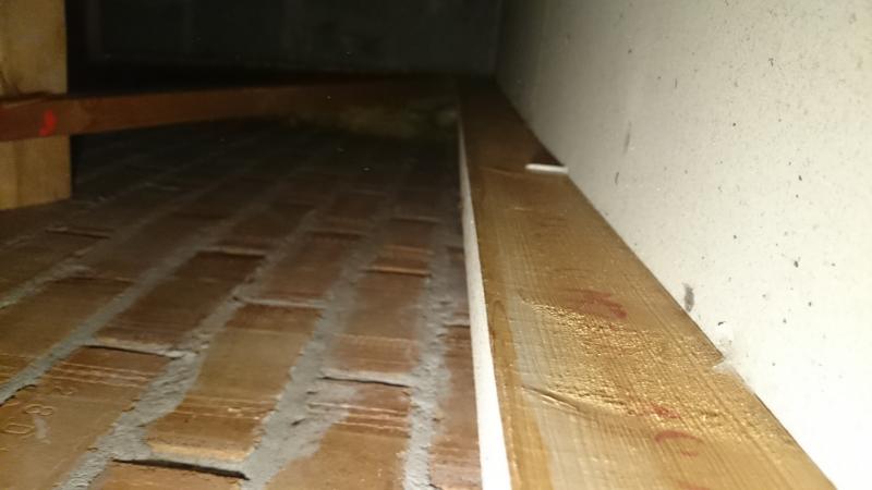

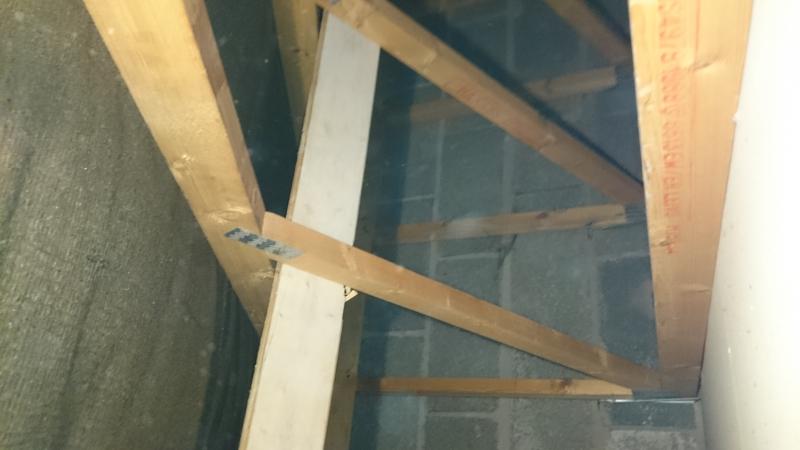

I am not sure you will get much extra space, that void will have a lot of wood in it.

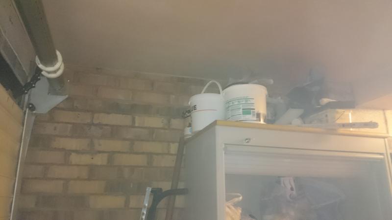

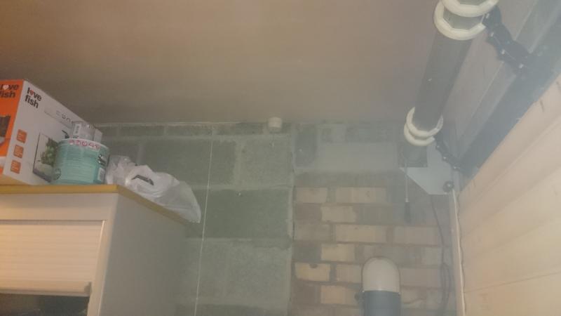

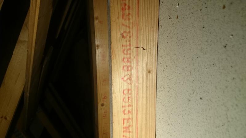

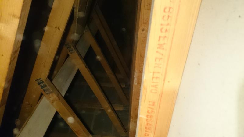

I would start by locating where the fixings are for the ceiling, use a stud locator,mapping compass or a magnet. mark their position with a bit of "post-it " label or tape. I would then cut a 6" square spy hole through the ceiling now, select a point right in the middle between the fixings, somewhere in the centre of the door. Drill holes a the corner of your square and a chain of holes from diagonally opposite corners for about an inch down each side. Do not let the drill penetrate too far as there could be a cable laying on the plasterboard. Cut the sides of the square out and poke a camera or mirror through the hole and figure out whats up there. Come back here and report your findings.
Frank

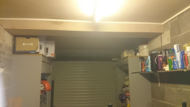

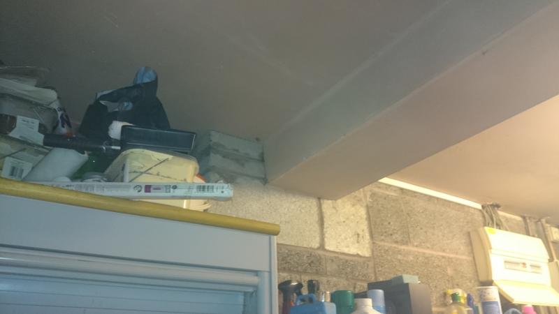

thanks for the advice, i made a small hole yesterday, but only just the size of my phone, so ive taken some pics, not sure they atr great, i can try again later.
current ceiling hight from floor is 257mm, apporx 8 & 1/2 FT
now looking at the "breeze blocks" i estimate another 3 -4 ft of space at the highest point
so i was thinking about 6 and 1/2 ft hight for my new ceiling/storage beams hight?

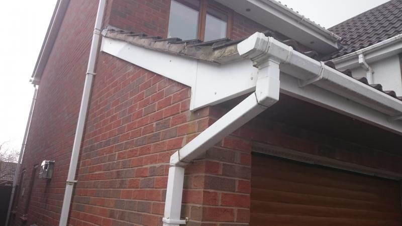

Garage - fire regs ? I'm not sure but that ceiling must be plastered for a reason :wink:
my loft is pants, i can get up there but only on my knees, and its already got all the kids old toys and things the wife wants to keep till they are older.
the point here is im trying to make floor space for home gym in garage. the inlaws have the same build property, when the purchased the property the old owner had put over head storage in the same manner im planning.
not sure about fire regs, i spoke to a chap doing next doors roof tiles and he seems to think its fine to remove the plasterboard from the first quarter, garage is too small for a car, well maybe an old mini
anyway, simply put we are talking about create overhead storage.
please have a look at this, as this is what i would like to create in general
