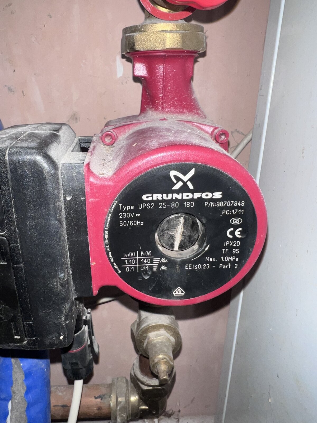

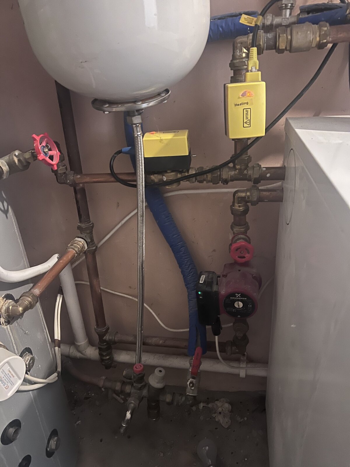

If you can locate the circ pump, post its make/model/mode/setting, it may be close to the boiler or upstairs in the airing cupboard if you have a Y system with a 3 port mid position valve.

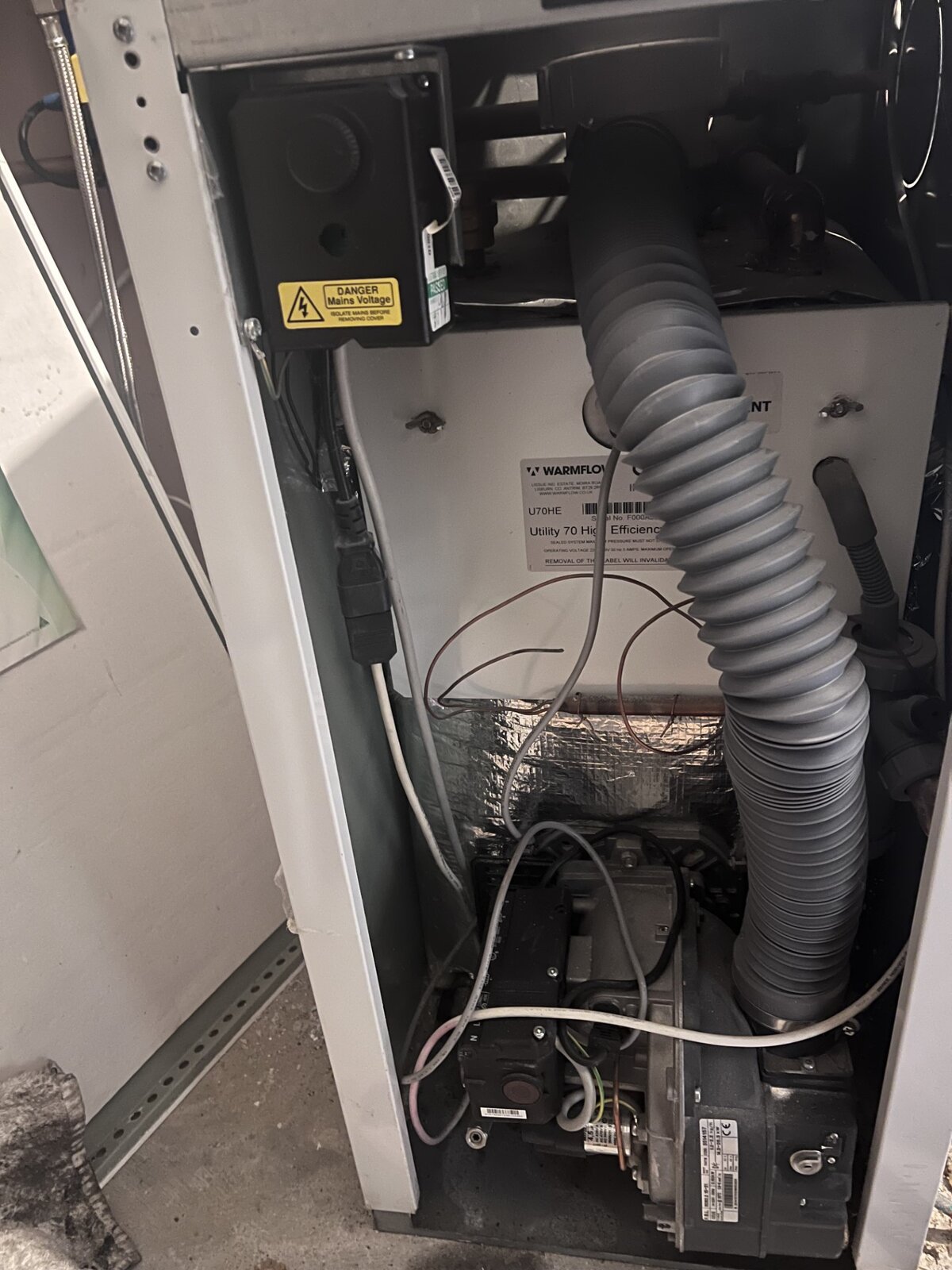

Thanks for the reply guys, this is what I have. I checked the copper pipes and they are warm but definitely not hot

If the boiler is only firing for a few minutes or less then looks like a circulation problem.
Can you hear the pump running?, you can remove the (vent) screw on the pump front, a small trickle of water will come out but nothing to worry about, you can then see if the pump shaft is turning.
If you feel the flow pipe between the boiler and pump is it very hot??.

boiler is firing continuously. pump is running- I just opened it , small trickle of water as you say and I can see the shaft turning. Speed can be adjusted too. Flow pipe between boiler and pump is a little more than warm but not hot and definitely not very hot.
Check that any valves in the area of the boiler are fully open and maybe a powerflush.
It looks to be a rubbish installation, I'd get an oil engineer to look it over for you.

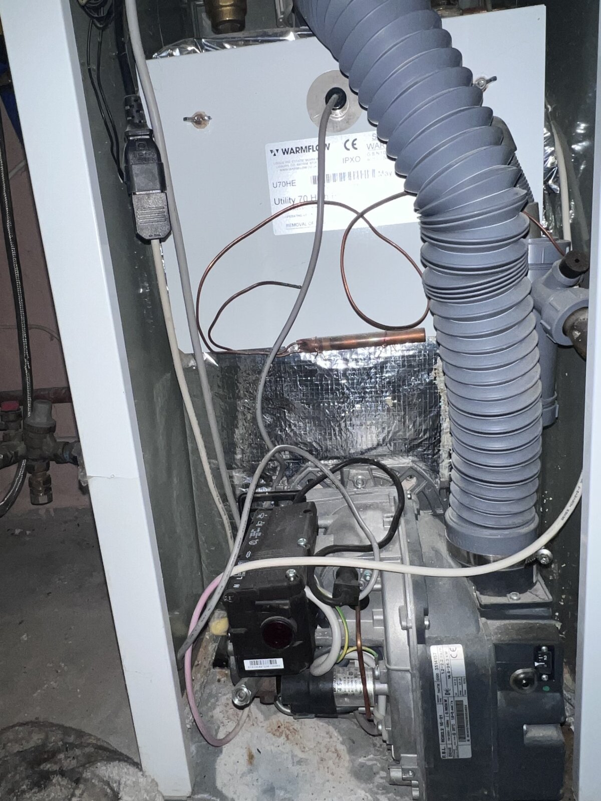

Looks like something in the combustion side, a 20 or 30kw oilf fired boiler doesn't modulate so can't see it firing continuously without heating the water to cut out point, can you see a flame through the viewing port?.

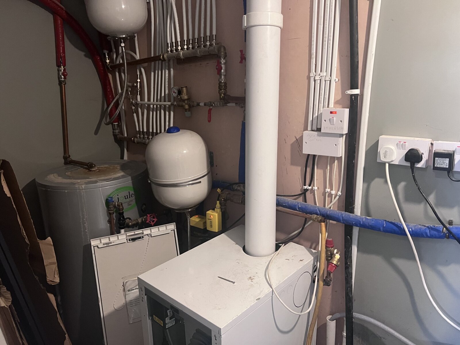

How many rads?, doubles & singles.

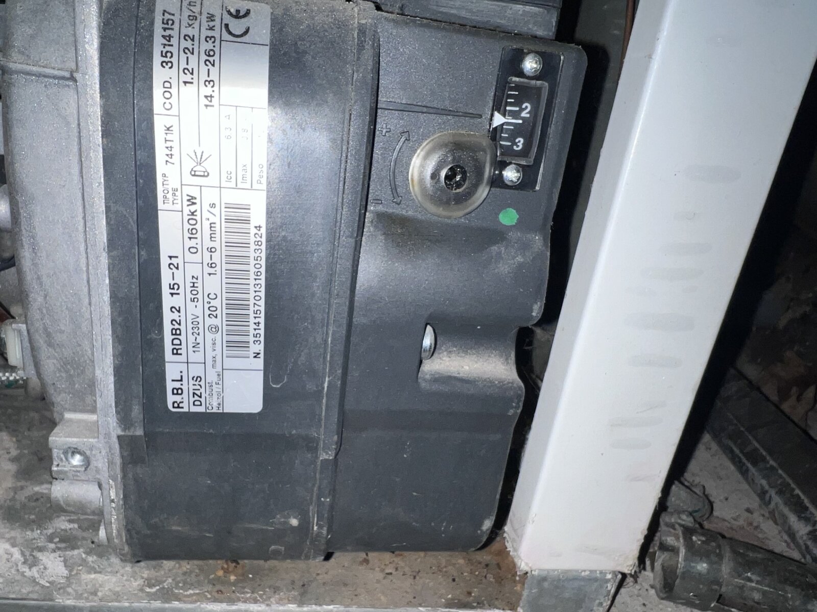

What is the make/model of the boiler? if there is a label on the boiler, post a photo of it.
Also model of Grundfos pump + setting.

25 radiators- mostly doubles.
Output from the boiler directly is very hot but the return feels fairly cool. I would assume boiler would switch off once the return reaches a certain temperature?

Ok, assume 25 rads have a total outpout of ~ 32kw.
Boiler max output is 70, 000BTU, 20.5 say 21kw.
Burner output can give, depending on jet size, output 14.3kw to 26.3kw, boiler output ~ 13kw to 23.7kw.
I would get someone to check the nozzle size is sufficient to give the maximum boiler output of 21kw as a start.
Boiler is undersized, the rads would need flow/return temps of 75C/65C to emit their full rated output.
If the boiler flow temp is set to 65C (or equivalent on the index) and the pump speed set to lowest (6M) then the boiler should get up to that temperature and then cut out as the demand will be ~ 20kw, it may take 30/40 minutes to achieve this, if it doesnt then I would suspect the jet sizing.

You can check/change pump speeds yourself, try minimum, if not allready set.
