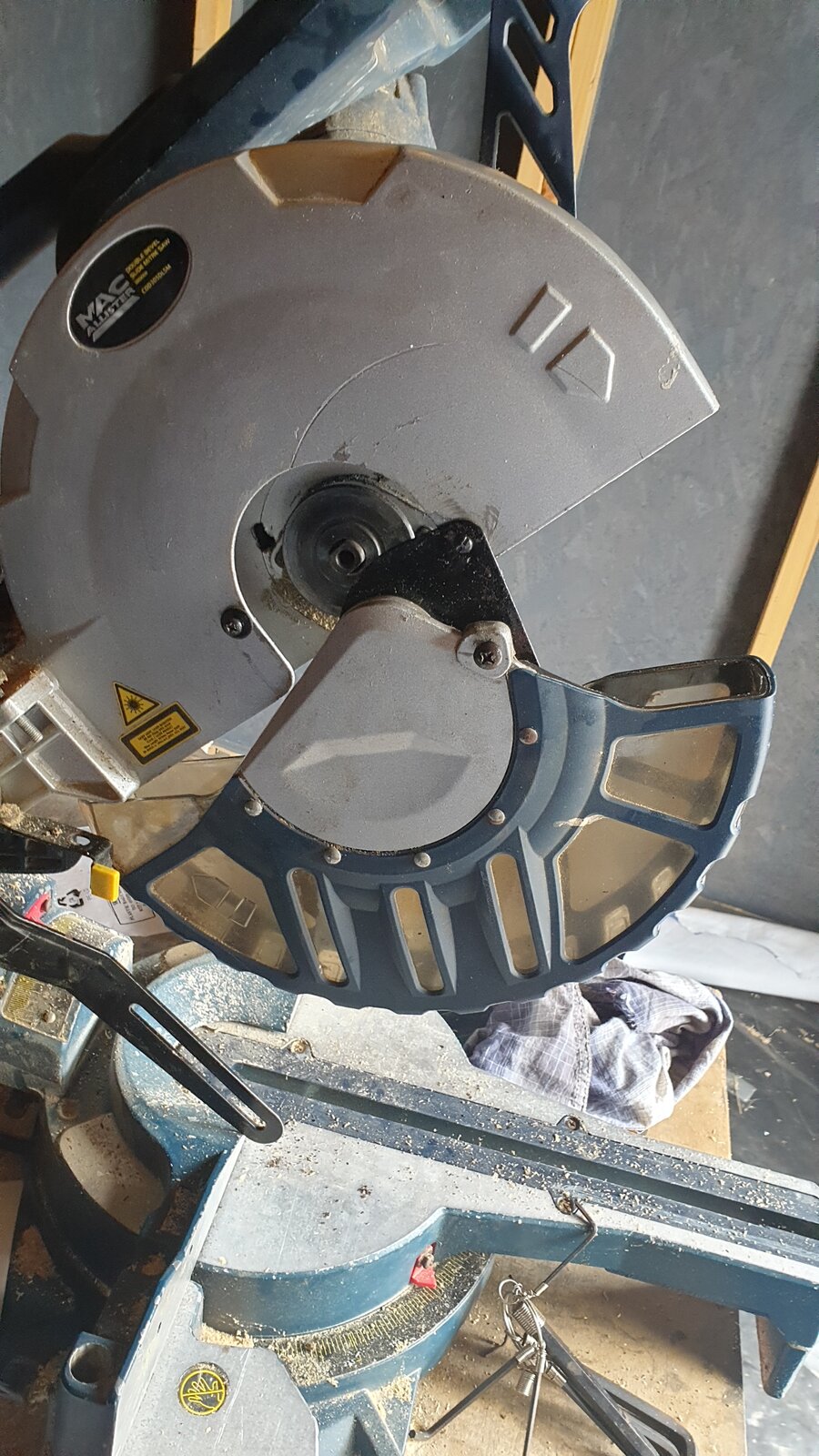

...removed the saw blade guard on my MAC Allistar bench saw buv unable to fit it back on. anybody helped?

That looks quite like the guards Makita use on some of their saws. If so, you need to pivot the blade guard round anti clockwise and over the upper guard, revealing the black plate. By jiggling round a bit, the black plate can be pivoted clockwise to where the securing screw (visible on the upper guard) can be used to secure it. It always seems to require 3 hands
Hello JobAndKnock thank you for your reply I wont be home untill Saturday and will follow your instructions shall let you know how I get on
...sorry for the late reply, I was waiting for my fingers to heal so I could message you, it does indeed need three hands but I managed it after a struggle by following your advice thank you
