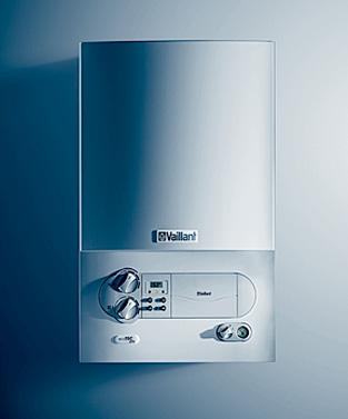

I've just moved into a flat with a Vaillant ecoTEC pro combination boiler.
I was astonished to learn that the system has no room thermostat, however apparently the radiators all have "thermostatic radiator
valves".
Additionally the boiler has a knob called the "maximum radiator temperature control" that makes the overall system run hotter or cooler. I control it by raising or lowering that.
I have 3 concerns:
1. some parts of the flat are real warm, and some are real cold. How difficult is it to adjust these radiator valves individually to get more even heating? Any tips about doing that?
2. is this a sensible setup? Seems slightly mad to me. Without an actual room thermostat, how does the central heating know when to ignight?
3. I notice in the installation guide that it seems easy enough to add a room thermostat. Should I? What's the gain? For example: Am I wasting energy by not having a proper thermostat?

The idea is that you control each room by the thermostat radiator valve.
But they take up to 40 min to take effect.
You should have a room stat to turn off the boiler. Its required under the Building Regs when a new boiler is fitted.

If you are going to the trouble and expense of having a thermostat fitted, I would go for a Programmable one. This will cost £40 or so, unlike a bog-standard wall stat at £12 or a Wireless stat at £120.
A programmable stat allows you to set different temperatures at different times of day and days of the week, and also (usually) enables you to tell it you are going on holiday for nn days, whereupon it will run the heating very low until the day before you return, when it goes back to normal and gets the house warm for you.
My suspicion of wireless stats is that they are one more thing to go wrong, and less easy to test when they do.
Getting the judgement of experts is the main aim of my post. Would you want to have no thermostat in your home?
I consider a roomstat vital, and especially a programmable model will greatly enhance comfort.
A roomstat will also save you some money, and eventually pay for itself.
I agree with JohnD, a programmable thermostat for me every time. This gives some control over the whole home. If you still find you are fiddling with TRV settings during the day, you can get programmable heads to fit most TRVs for about £30 a pop. If you keep the old TRV heads, you can put them back and take your programmable heads with you.
As you say, the radiator in the room should be controlled by the new room thermostat and not the TRV. I think the room thermostat needs to be at least 1.5m off to the side of any radiator.

To be pedantic the Guide does not specify a room thermostat but a boiler interlock, which it defines as controls wired so that, when there is no demand for heating, the boiler is switched off. In the majority of cases this means a timer/programmer and a room thermostat. But there are boilers which have flow sensors incorporated which turn off the boiler when the flow reduces due to TRVs shutting down.
