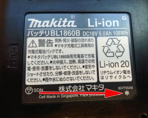

Batteries with the star-protection marker are balance charged. The B suffix is on models with battery indicators and sync-lock compatibility. The snow flake marker (won't be on any of our batteries yet) indicate rapid charger compa tibility with the DC18RF.
