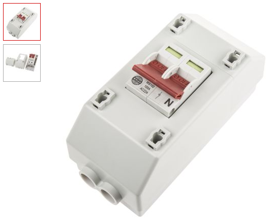

Hi there. I've got a simple question about isolator switches like this Wylex 100A one. Their datasheet says:
"It’s safer because the supply tails are fixed and finalised in a sealed unit – instead of being left hanging loose ready to connect to the meter."
but their diagram shows it between the Meter and CU. I'd prefer it to be placed before the Meter as then everything can be isolated. Is that OK or are they going to worry about tampering?
I'm aware how hairy all of this is so the profesionals will be used, but I like to understand the layout and it sits on the interface between sets of professionals, so if I can have it before the Meter, I'll buy it before UKPN come and connect the main feed and ask them to terminate to the isolator switch.
Thank you for your help.
From Wylex datasheet:
full

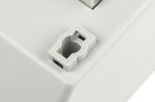

Thank you bernardgreen. I see that the switch itself has security features on the screw holes that presumably allow the sealed twisted wire tamper detectors. I've copied a couple of pictures below. These would stop tampering of the isolator (REC) switch, but not stop someone putting something else in-line before the meter I guess.
Is the ensured Live Therefore Dangerous method really the right anti-tamper approach. If you are inclined to tamper then you'd probably be brave enough to do something else stupid with live wires.
I would hope safety out ranks security. Not the safety of some unlikely tamperer, but the safety of all the likely people that will benefit from an isolated meter and everything else.
Photo of whole Wylex 100A REC switch:
full
Close-up photo of anti tamper feature on screw holes:
full
