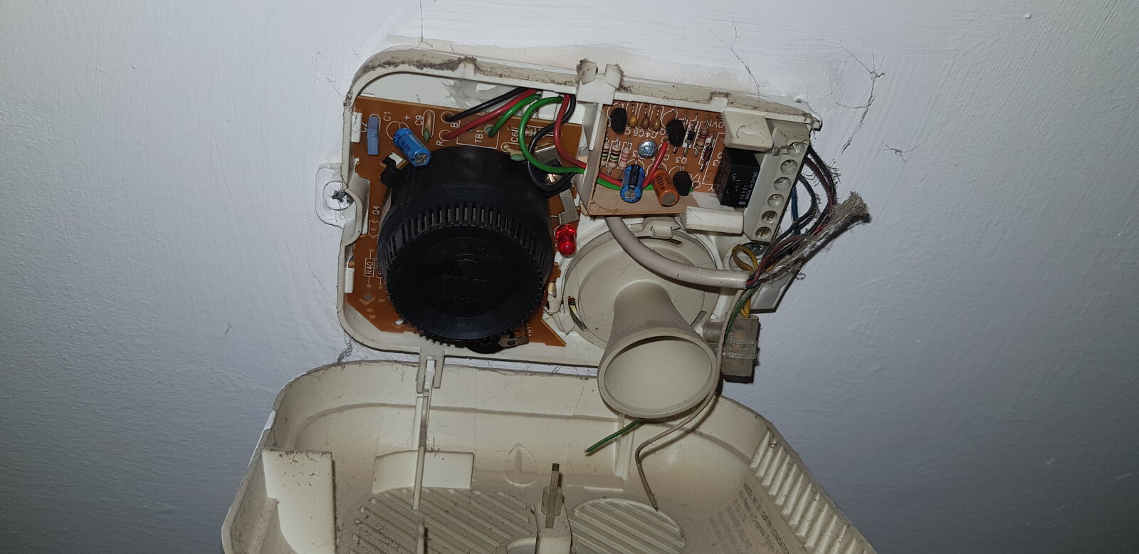

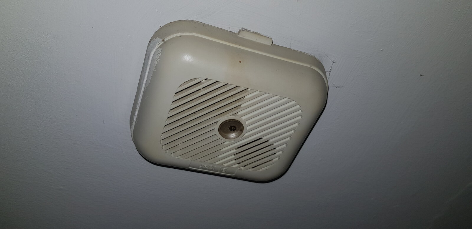

I have now had a good look at this smoke alarm.
I opened it and found that it has no trace of any mains voltage in it. Neither does it have a back-up battery. So I assume I was right in the first place that there is a transformer somewhere up the line.
All I can assume is that it is somehow tied in to the house alarm system. I must look closely through the documents.
I'm glad that I didn't go out and buy a replacement mains-powered smoke alarm as that wouldn't replace this directly!

You're not correct. There is no transformer.
Well there is no battery.
And a circuit board where the battery would normally fit.
Maybe a master unit has a battery ?
