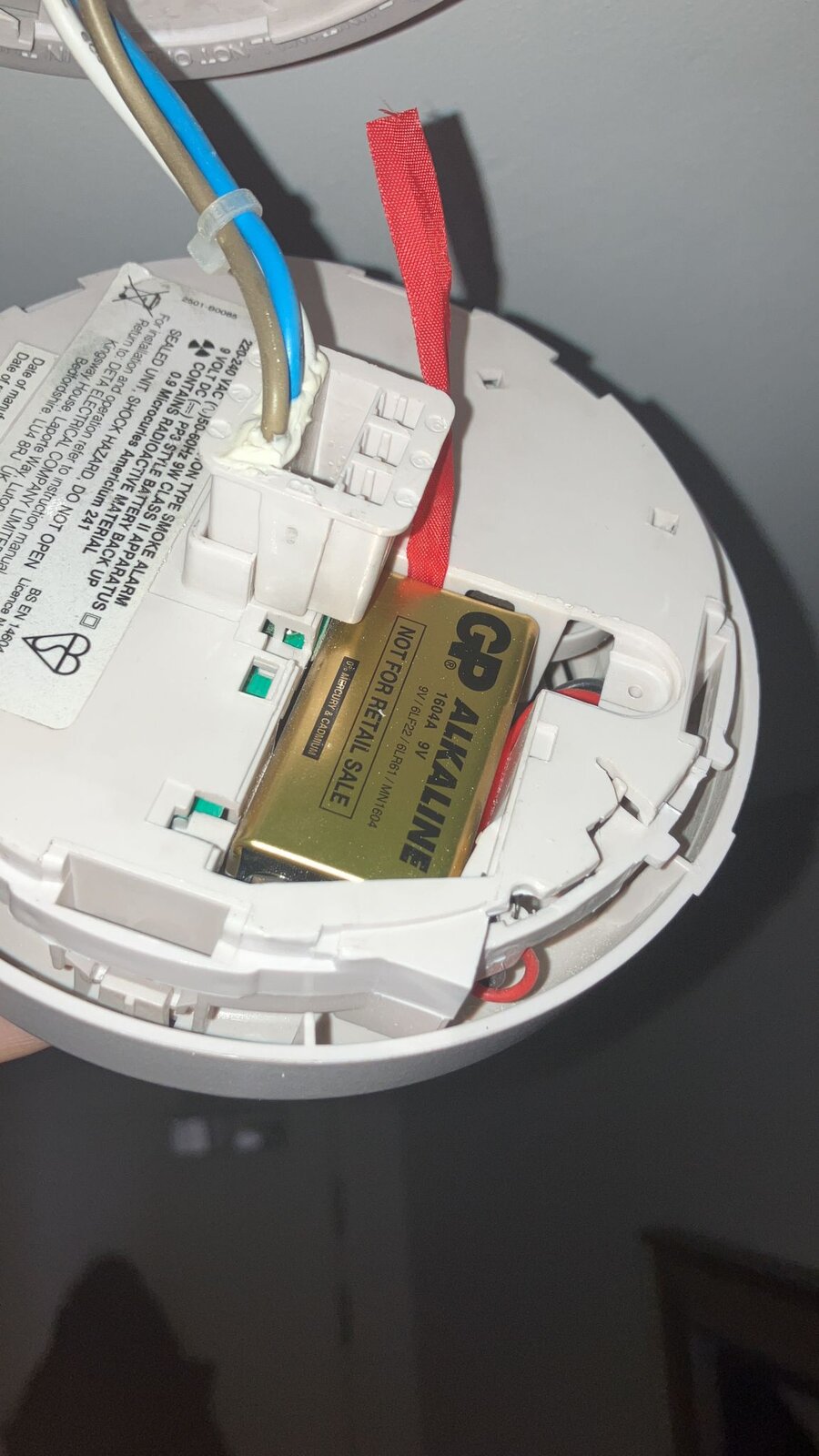

Can anyone tell me how to remove this battery?
You may need to disconnect the mains plug with the 3 wires first.
Also check the expiry date on the label. The whole alarm may need replacing.
Looks like there’s more than one alarm. Probably they all are of the same age and
-if so- all need replacing.
Thank you for your input JW2, if only it was that easy
Apologies - I hadn't looked carefully enough - but when I did, it was pretty obvious that one would have to pull out the mains connector before pulling the red tape!
Kind Regards, John
As they say, “hope springs eternal”
