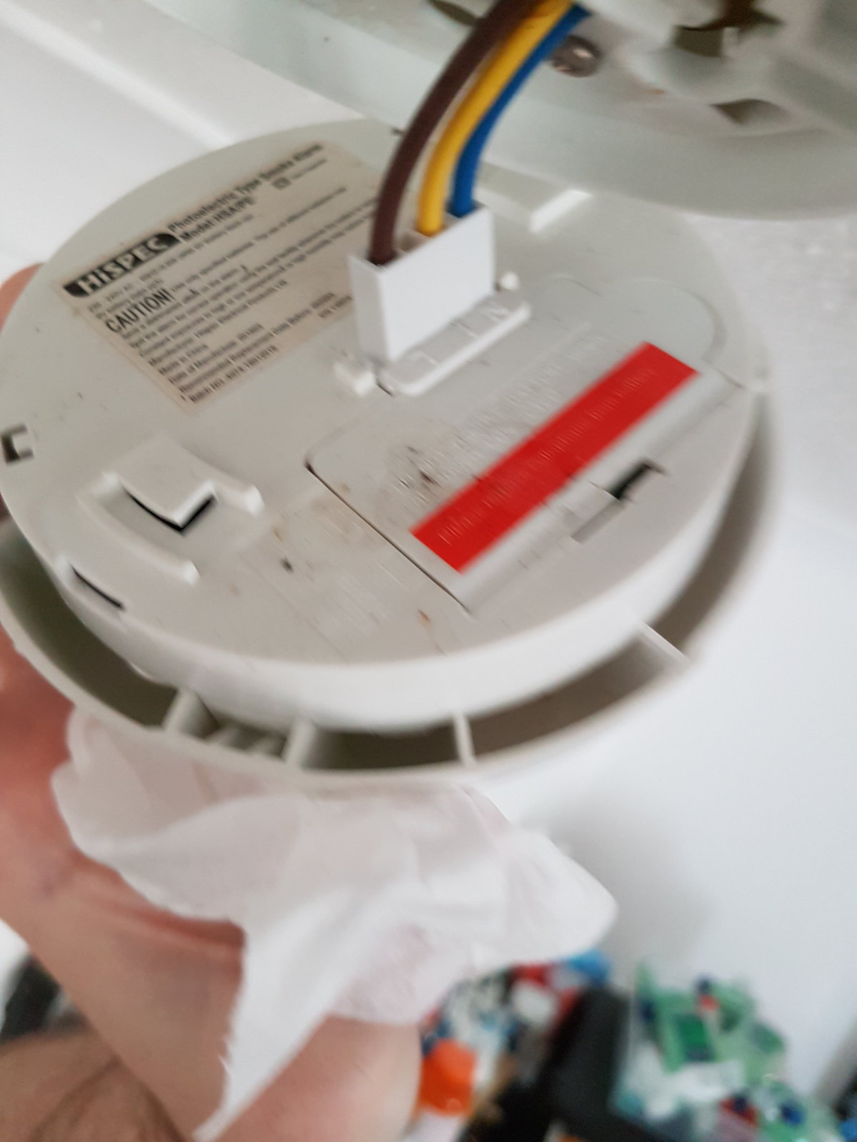

At 4am last night and 3 days ago a 4am again one or both, hard to know if it was just 1 or 2, went off for about 15 seconds.
Its not beeping or anything like that, no smoke, no moisture, nothing that I can see is around it.
can anyone tell me what it could be. Ive opened them up and doesnt seem to be any insects in there.
Only difference is that 4 days ago I plugged in a new extension lead for something unrelated. Could this be the cause of it?

Battery failing warnings are more often a single beep, repeated maybe every few minutes - so 15 seconds especially if all alarms fired, suggests they were triggered. Are there any kids in the house, who might have perhaps pressed the test button unknown to you?
Impossible to reach without ladders so nope. Everyone was sleeping.
