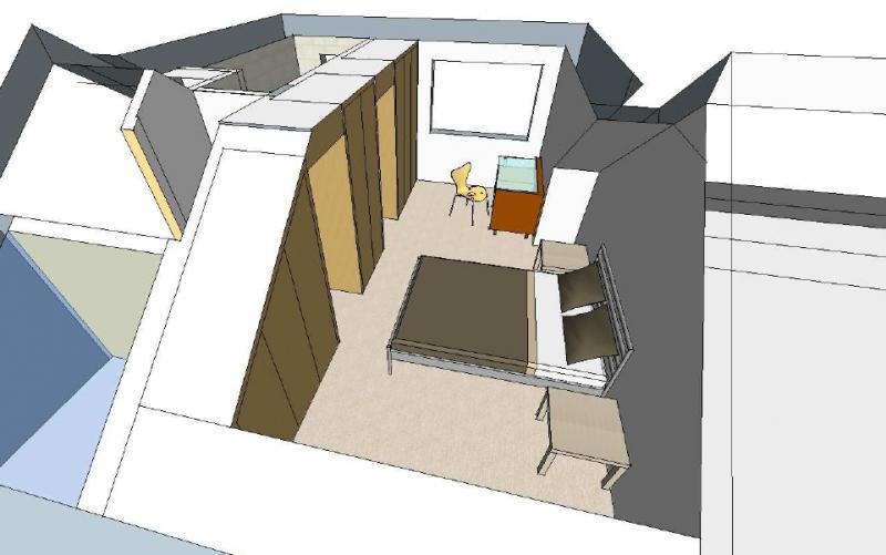

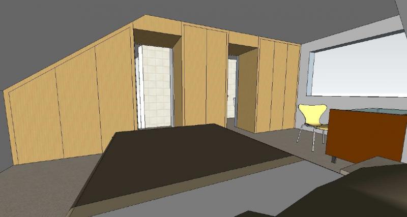

I'm drawing up a loft conversion at the mo, out of interest is it possible you could give a (very crude) ballpark cost to produce something like this in a loft, 600 deep wardrobes with a few shelves in each wardrobe and a mid-range veneer. overall length of the room is 8m. I'm in Plymouth so don't get excited! :p
