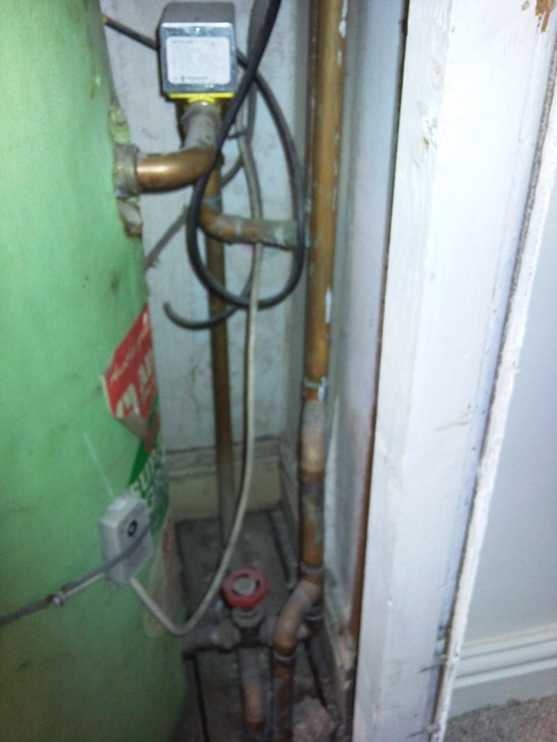

The system comprises a system boiler at front of house in bedroom cupboard, cylinder in back bedroom - linked via pipes through loft. The pump and 3 way valve is adjacent to the cylinder. From the cylinder cupboard, the central heating pipes go down and horizontally under the floor. Above the cylinder is the header cistern.

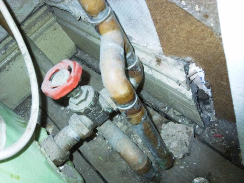

update: 20 mins later and I have turned off the HW and running just the CH. There is NO air noise. Air noise only exists with HW ON. The noise appears to be coming in the main from the cylinder outlet at the bottom.
So what is causing this noise? I have bled everything I can find. Could it be an imbalance between the cylinder and the rads? There is a gate valve on the cylinder outlet.

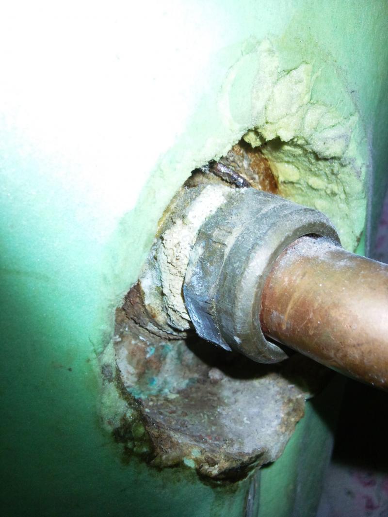

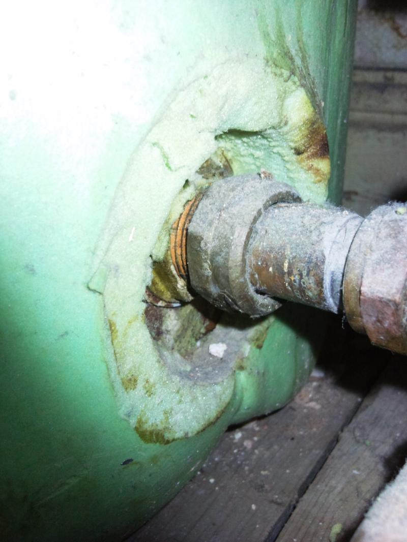

The cylinder is an "albion supalag green 900x400 indirect (ref2)" apparently. It is showing signs of corrosion, and has leaked at the inlet and outlet holes for the heat coil, but a plumber said he wouldnt touch it with a bargepole in case he tears the cylinder. And I cant afford a new cylinder. But could this be the problem? A slightly corroded cylinder?

no, that isn`t the problem - or much of one either :wink:
Judging by the picture of your motorised valve, it would seem there is no vent on the h/water flow. Personally, I crack the nut going in the cylinder and release it that way.
Yours has leaked and sealed itself but any plumber worth his salt would never worry about tearing the cylinder. Worst that can happen is the washer sealing the domestic water can get dislodged and then its a PITA job. :x
Ok, a couple of questions, what would this vent do? release air from the cylinder coil? Is this my problem? I realise there is no way for air to release from the cylinder at the moment because all pipes from the motorised valve go down. Is it a similar principle to a radiator bleed valve?

I would open the gate valve a bit more, its may be restricting the flow a bit to much.
