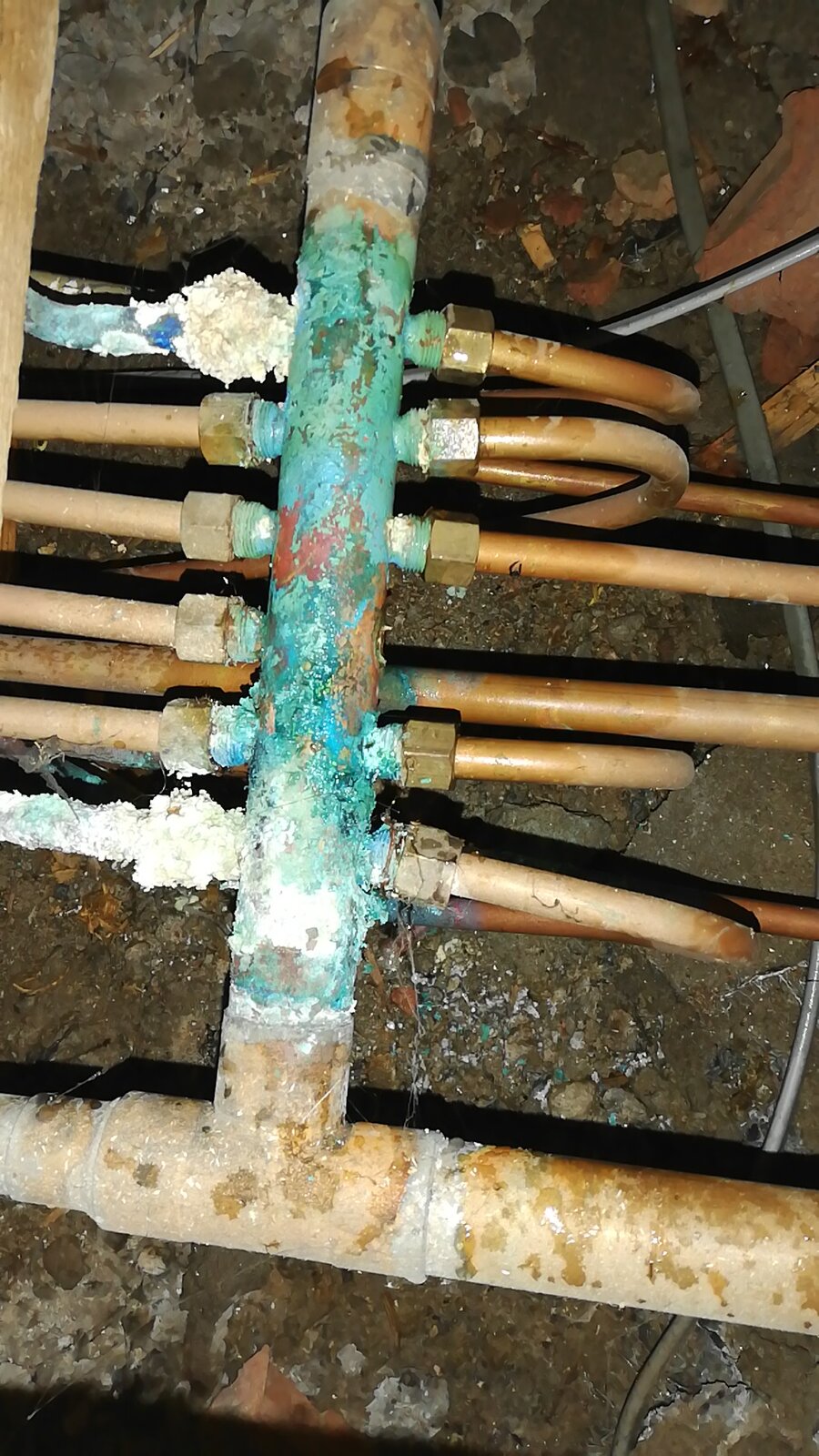

Hi, can anyone tell me where I can purchase one of these or what they are called? I've tried Googling and only reaching forums of people battling with them. I've got quite a big issue with mine and it needs replacing...
All the major manufacturers of push fit (Hep20 - speedfit- polypipe) do a push fit 22m x 10mm manifolds.
Either use those and adapt as required or I would get some 22 x 22 x15 tees 10 x 15 reducers and fabricate what you need.
