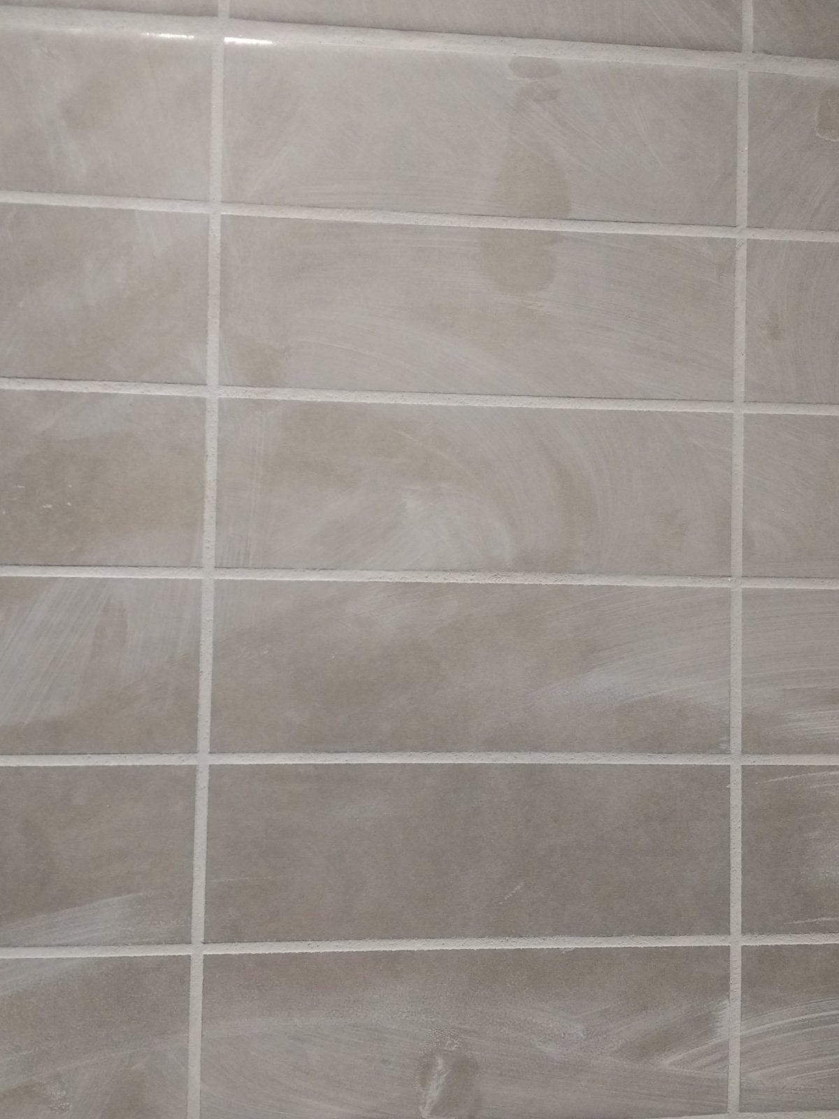

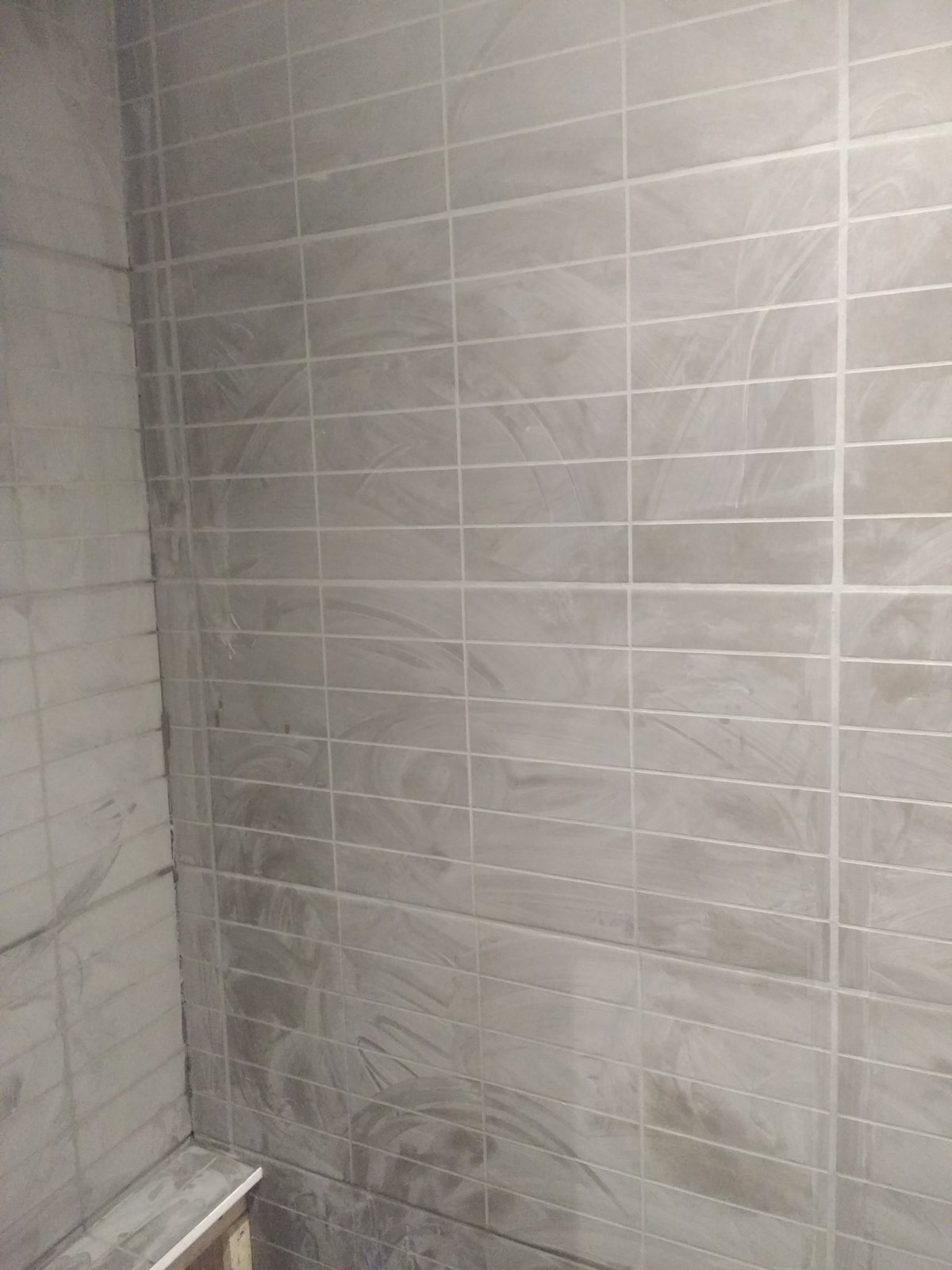

I've just done a bag of exactly the same (mapei) stuff yesterday, mixed 1kg at a time (kitchen scales). Started with 200ml water, ended up with 250ml plus a splash more at the second mixing stage to make it barely wet enough - I was reluctant to add even more water!. Even so it was still drying on the tiles almost on contact and my rubber squeegee was a waste of time so used a bendy scraper/filler knife.
View attachment 142880 View attachment 142881
Looks very messy . It’s going to take a lot of cleaning .
