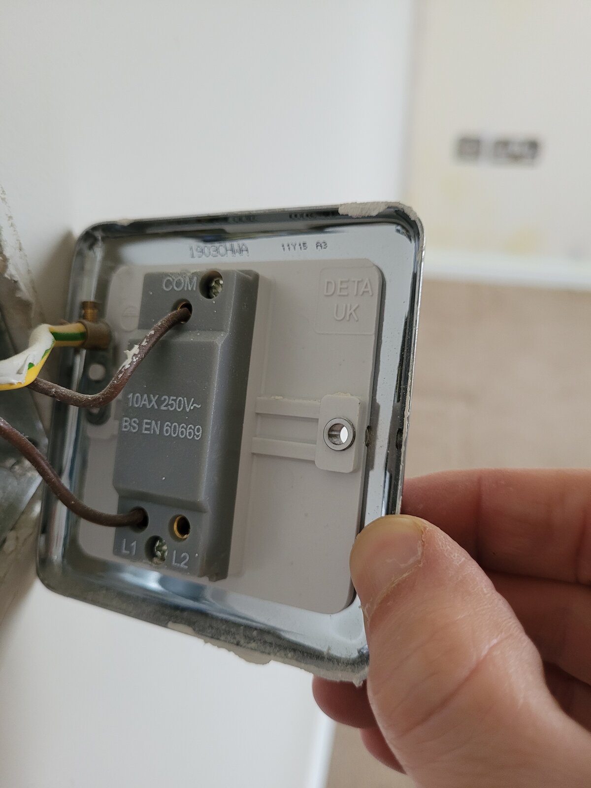

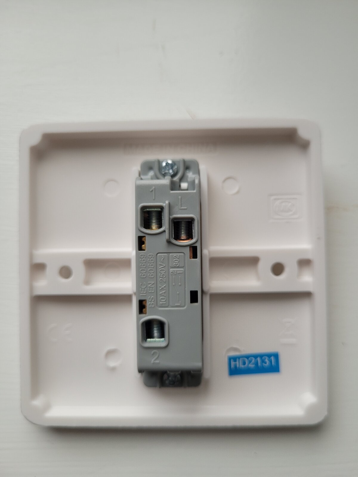

Hi,
I am replacing some old 2-way light switches (first pic attached) with new 2-way light switches (second pic attached).
I am slightly confused about terminal 1 in the new switch being close to "L" (i.e. common), given that the layout of the old switch is different. Also, the wiring diagram printed on the new switch shows a connection to 2, whereas the old switch had a connection into 1 / L1. Shall I connect the new switch like for like but following the wiring diagram printed on the new switch, i.e. what went to common in the old switch goes to L in the new switch and want went to L1 in the old switch goes to 2 in the new switch?

Good point, and also as to if 1 or 2 should be used, depends on which way up the switch is mounted, so as long as L has one wire in it, it will work. Does not matter if other wire goes to 1 or 2, although most would as default put it in 1.
"Does not matter if other wire goes to 1 or 2, although most would as default put it in 1." unless using Mk switches when putting it in 1 will mean the light on with switch "up" and scolmore is the other way round DAMHIKT
