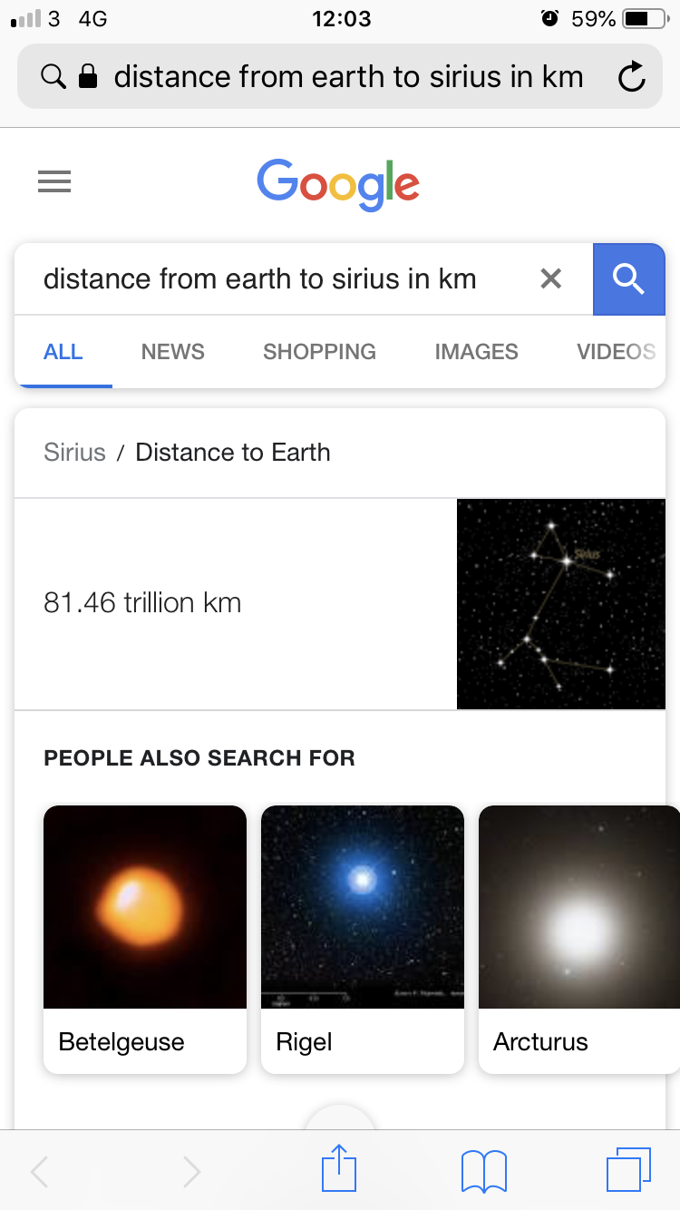

Mine was the first thing that came up on google but I don’t know if that’s correct:

Ian with his 81.46trillion km presumably got his number from a difference web source.
