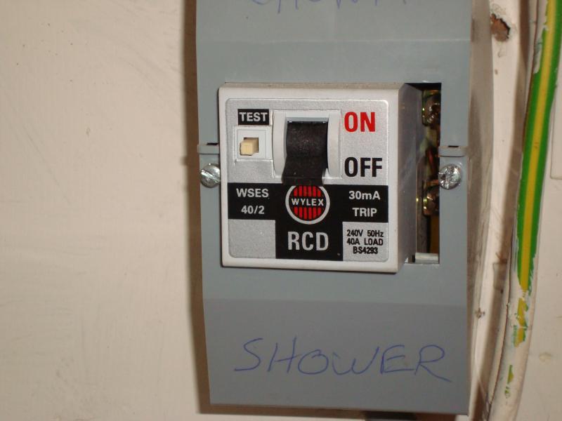

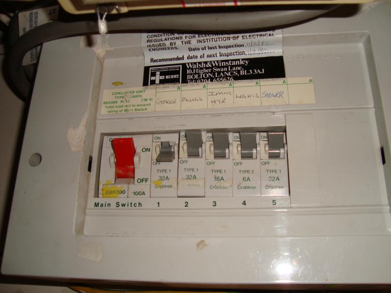

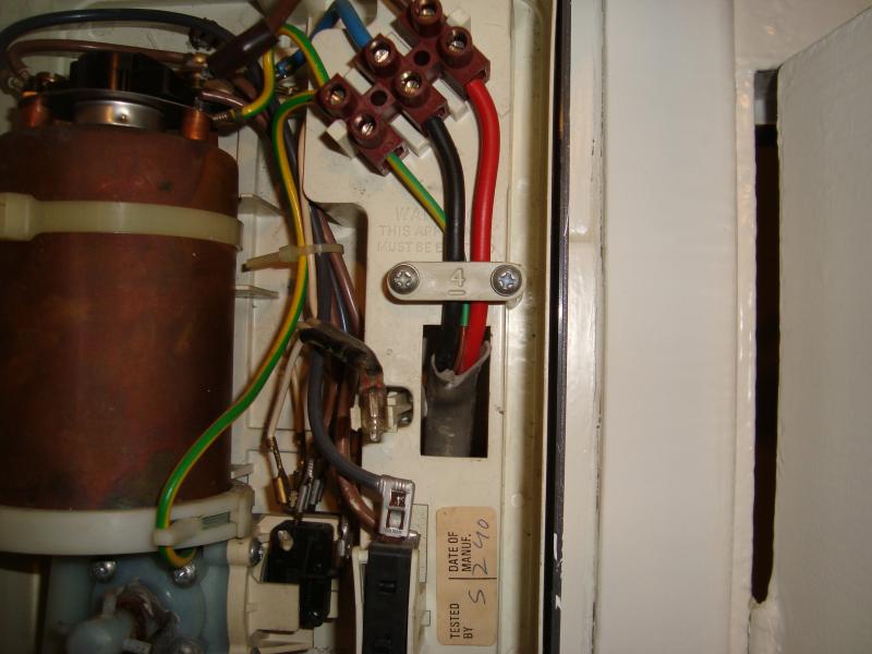

So im updating my shower this ones probably been in for about 15-20 years. Because my current 1 is so old im not sure what the maximum KW shower I can have or if I need to get someone in to upgrade my electrics.
Heres some pictures of my old shower, fuse box and RCD.

that sorted, the cable looks to be about 6mm², but without something for scale it's hard to tell..
it's 30mA protected, so that's a plus, but the breaker at 32A seems to confirm it's only 6mm², so you're limited to...
32 x 230 = 7360W..
since we use 240V here, then that's 7.5KW... not a great shower by any means, and you might struggle to find one that small nowadays..
If the cable is 6mm, it may be possible to fit a 40A MCB, in which case a 9.5kW shower could be fitted. This will depend on the cable length and where it is installed.
40A MCBs for that board do exist, but they will be very hard to find, and probably ridiculously expensive. (Seach for Crabtree SB6000 if interested).
Probably cheaper to have a new separate board fitted if the cable can be used at 40A.

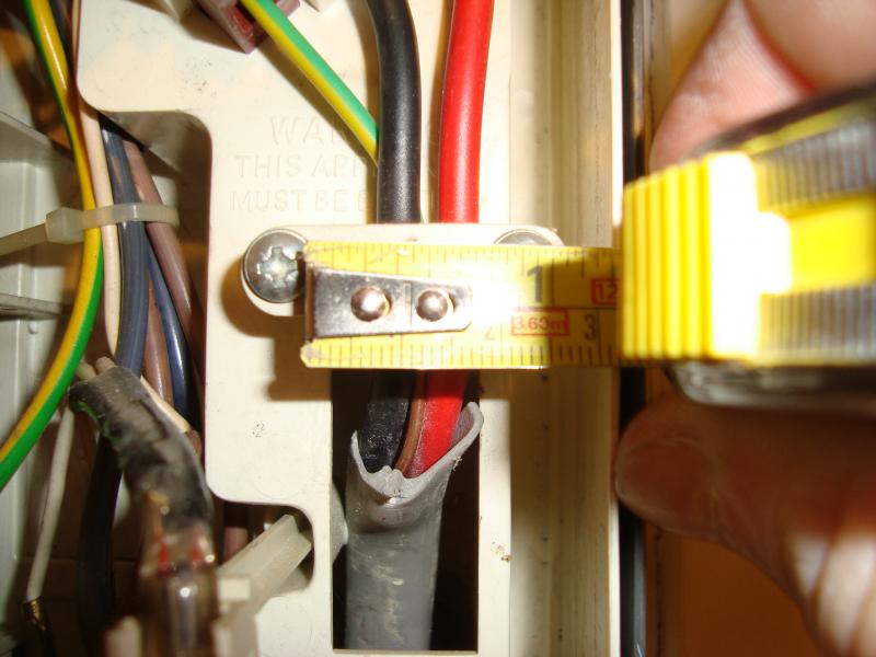

There is a picture of my cable next to a tape measure below.
This is aprrox length of my cable from board to shower unit
2.8 m through wall
4.8 m through plastic trunking
0.6 m through wall behind shower
Total 8.2 m
What will be the most cost effective way to upgrade?
