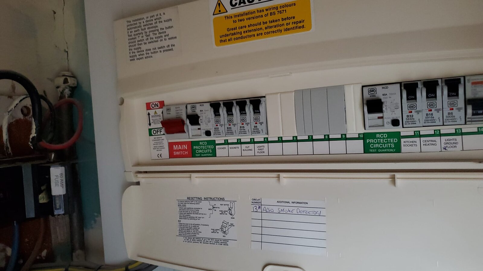

UPDATE: We've blocked the guy and run. We sent him the photo (At that point to see what he'd say) and replied back it would be £400 PER outside socket. The socket wouldn't be wired into the mains (As we requested) and would simply be a wire coming through the wall and plugging into the socket.. Basically this.. I can literally do this myself lol
He also said "Your Bored [sic] doesn't have an RCA Breaker so we will need to use RCD built in ones which will be more expensive. You are also required to have one fitted to your board which I will also do while im there. This will be extra you understand"
needless to say we blocked him and moved on. Thank you to everybody that helped <3
This may be an odd question..
We've moved into a house and we need an electrical job carried out. We're in contact with an electrician and he's pricing up a job. He's E-mailed and asked us "Does your board have an RCA Breaker".
Here is a photo of our board. Does it have an RCA breaker? I believe it does (Where it says RCD protected) but wanted to confirm before messaging back.
Additional: the reason he wants to know is it's for fitting an outside plug. He said we won't need an RCD Breaker plug outside if the board already has RCA breaker.
Additonal: He keeps calling it RCA but everything i've read online says it's an RCD breaker.. Should i maybe be worried? he has Great reviews on Check a trade..

No but it does have 2 x rcds, send him the photo.

Not sure what an RCA is but your outside sockets wont need to be rcd sockets.

It's an RCD - as printed on the front of the two devices in your consumer unit.
There is no RCA device and never was.
Even for something such as adding an outdoor socket, there is a lot more to check before installation than just whether RCDs are present.
They really should attend and look for themselves.

There are some accredited electrician registration schemes for qualified electricians. They are a better source than Checker trad, which is an advertising site.
