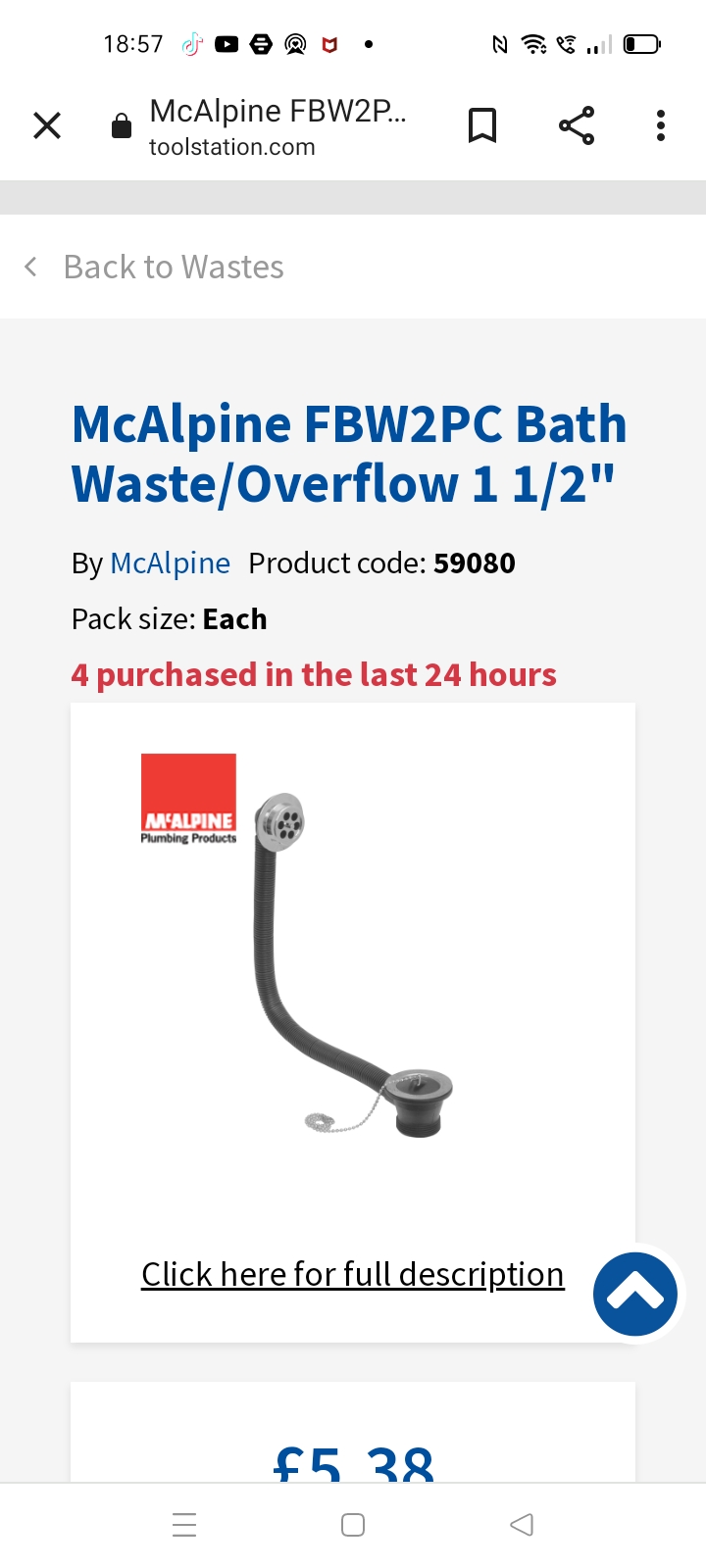

Are these any good? The part of the waste you screw the screw in to is plastic thread? Could see this being an issue with crossing/over theatening

I find McAlpine products to be the best around.....with careful assembly they last very well and are superior to most other makes.
John :)
I’ve used some cheaper types, not really had any problems, so can’t see the same with McAlpine.
Only my opinion as a DIYer - I junk the supplied wastes that come with Ikea and Victoria gear etc and have McAlpine stuff on standby....chances are you are going to need it anyway!
John :)
Doesn't need to be super tight and a smidging of sealant on the seal will add belt and braces depending on how well the underside of the bath's waste hole has been finished.
I once used the overflow and waste a customer supplied. The overflow used internal o-rings and pushed together. About 2 years later, the top part of the flexi fell off the overflow fitting. Showering wasn't an issue but if the customer had a bath the water would come out of the upper part of the hose when the bath was emptied. I now use jubilee clips for piece of mind.
