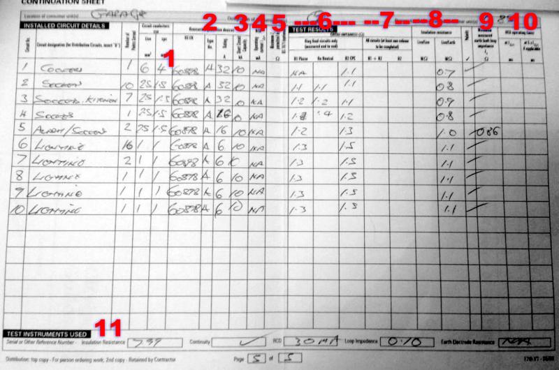

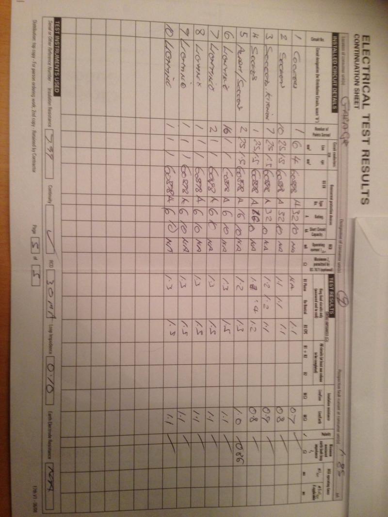

Do you have a certificate for the CU replacement? It mat show the relevant values.

One of the most incorrectly filled out certificates I've seen in a long time. I wouldn't trust a single word of it.
Never seen a type A 60898 device either :lol: and they're all 6kA devices in the photo of the cu. Also never seen 6.0mm² cable with a 4.0mm² CPC.
1. This is the size of the CPC (earth) within the cable. 6mm cable usually has a 2.5mm cpc.
2. This column is the type of device, for MCBs generally B or C. Possibly D. Maybe even K or Z in some unlikely installations. Certainly never A.
3 The breaking capacity. Usually 6 for domestic boards, 10 for others. Highly likely these are 6.
4. The RCD trip current, 30mA in this case. Other values are available. NA is not one of them.
5. Maximum loop impedance values. Generally copied from a table supplied with the certificate book. The newer versions of this certificate do not have this column.
6. These columns are for ring circuits only. The socket circuits 2 and 3 are probably rings. The others are not. In any case, the values would be totally different for each circuit - unless all of the circuits use the same cable sizes and are the exact same length.
7. Continuity in ohms, one of the two columns must be completed for all circuits.
8. Insulation resistance. Typical values for new or decent circuits would be in the many 100s. Old, damp, dirty etc. ones perhaps in the 10-100 range. 1.1 and below indicates they are totally wrecked and unsuitable for use. These figures are wrong.
9. Measured loop impedance. Why the alarm gets a value and the others do not is a mystery. If the 1.2 and 1.3 figures in the other columns are to be believed, this value can't be 0.86 anyway.
10. Trip times for the RCDs, which were apparently not tested at all.
11. Serial numbers of the test equipment used. Obviously used for some other purpose here.
