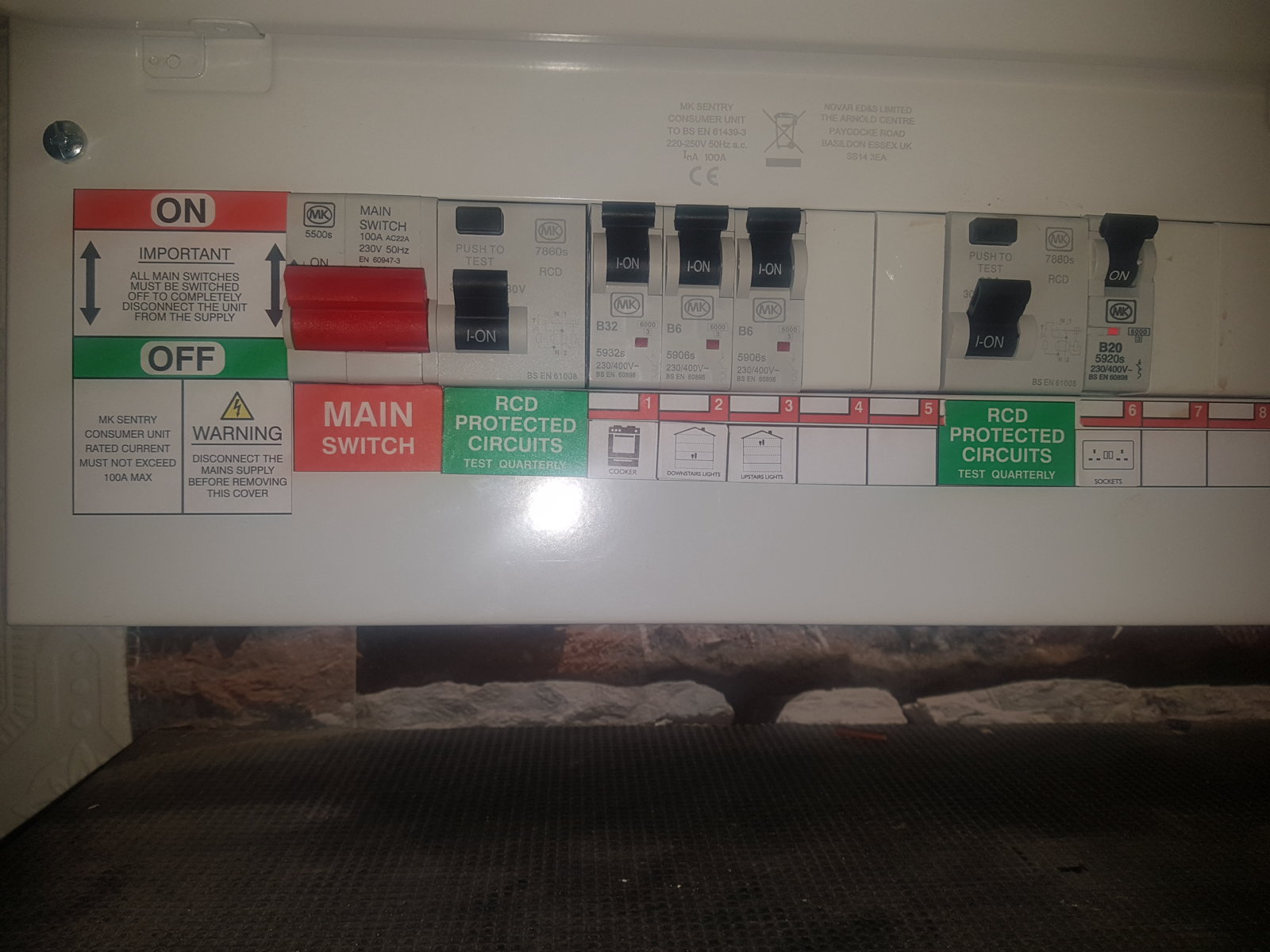

A bit of background: I own a flat (ground floor and basement). I lived here previously years ago and had no problems with the electrics. Then I rented it out for 5 or 6 years. I moved back in last week. The 15 amp fuse (old fashioned. Fuse wire) blew 4 times on the first day. Then blew a couple of times during next few days. I paid to have a modern fuse box installed a couple of days ago. Ever since then the MCB keeps tripping and on occasions the RCD tripped too. The electricians who installed it came back yesterday. And waited around expecting the MCB to trip again. Which of course (sod's law) it didn't. They seemed unable to think of what other tests they could do. It was left that I would try and diagnose the problem myself (ie try to identify what socket or device was causing the problem) over the weekend. The whole flat is on just one 15 amp ring circuit. After many hours of only using electricity in certain areas it dawned on me that the MCB trips even if nothing is plugged in.

Can you scan and post a redacted copy of the test certificate so we can see what his test readings were?
Are you in the same place ( room ) each time the MCB trips ? If yes then suspect a cable trapped between floor board and joist being quashed and shorted when you walk on it.
If an MCB trips then it will be a Live to Neutral short circuit or Live to Earth fault.
As it is intermittent, this could be in an appliance or in a cable being moved somehow, as said, under floor boards being stood on.
If you can't recreate the fault at will, then it will be difficult to find.
You can only note what you were doing and using when it trips.

Sorry did you say the Whole Flat is on one Ring that's 15 Amps? Is that before or after the new Consumer unit or both? I'd hope these Electricians did some kind of insulation resistance test before they replaced the Board which one would hope would highlight any issues with the existing wiring.

Seems odd to say the least if you've a ring circuit on a 15A Fuse (unless it is actually a Radial) and even odder that it's been replaced with a 16A MCB if it is a ring, if it were a radial then I'd expect it to have been replaced with a 20A MCB/RCBO. How many sockets have you actually got in total ?
In basement there are 2 bedrooms and a hallway. 2 double sockets in one bedroom plus a switched spur to a fan in the window. But the fan has been disconnected. 1 double socket in the other bedroom and 1 double socket in the hall. On ground floor lounge with 3 double sockets (1 of which is dead and seemed to be on its own circuit). Ground floor bedroom has 2 double sockets. Kitchen has 3 double sockets plus a fused spur for the washing machine. Plus another cooker socket.
Now that you mention it ...20 amp was mentioned in conversation (but so was 16) so it might be 20 amp..
There are 2 RCDS. 1 for the cooker MCB and the 2 light's MCB and the other RCD for the MCB causing me problems.
not sure how to use this forum ... I am trying to include a pic of the new fuse box ..
