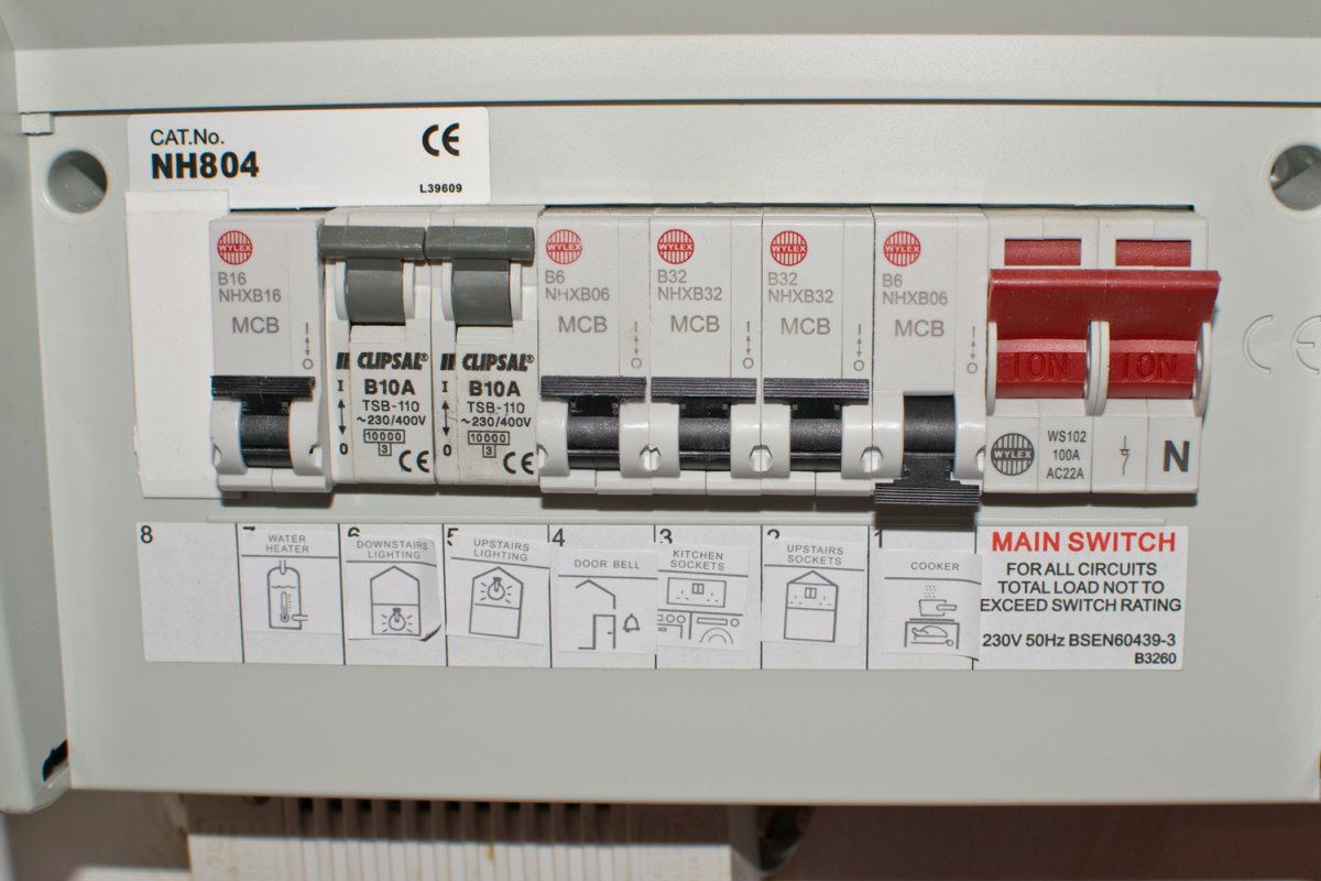

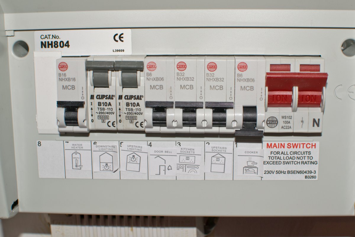

I must be much more cautious than you, Winston.
I wouldn't advise anybody to just change MCBs 'willy nilly '
Need answers to these key questions first:
1. Why is the cooker MCB only 6amp.
2. Why did the crusty old electrician find it necessary to crowbar those 10A MCBs on the two lighting circuits?
I do not believe he has done that as a mistake, or because that was all he had in his car.
We don't know but maybe:
1. The previous owner had a gas cooker and only used the circuit for electronic ignition.
2. Loads of halogen spotlights, or perhaps he previously worked in industry where 10A lighting circuits are more common.

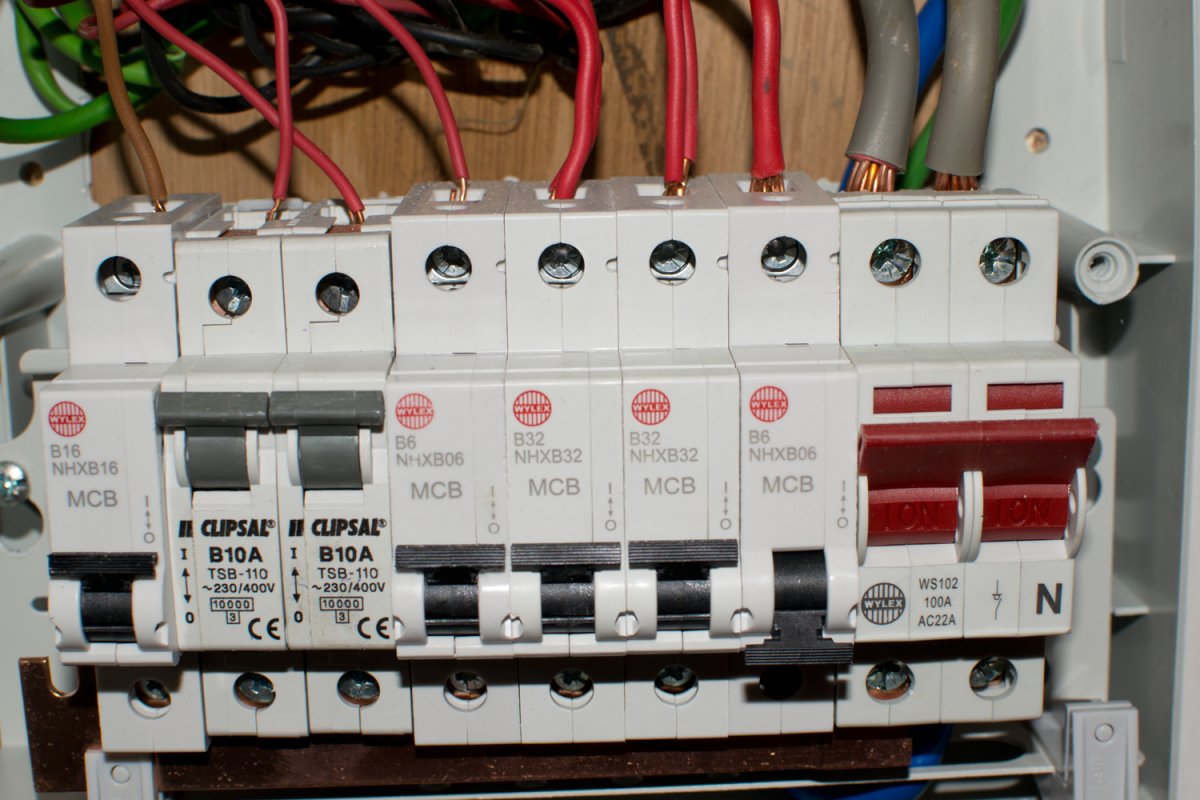

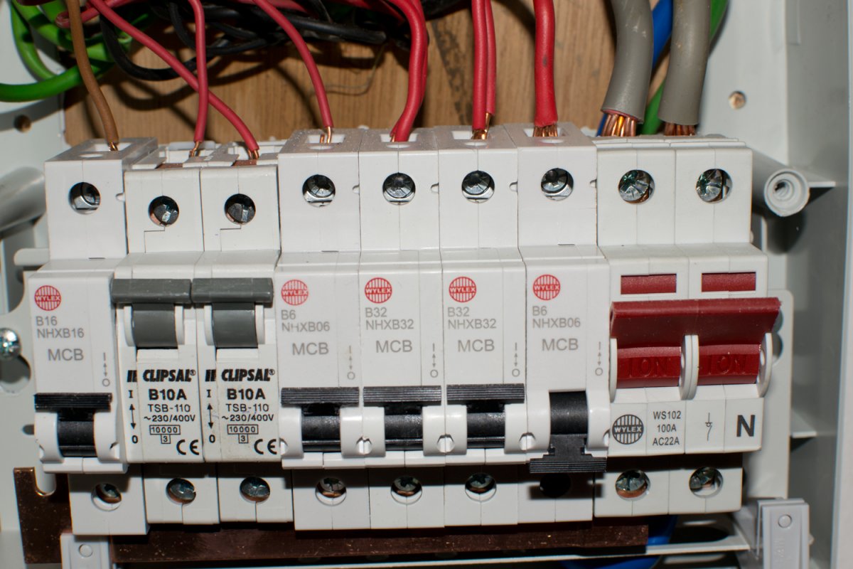

You probably do understand this, but just to be sure: do you realise that with the front off the consumer unit and the main switch on, as shown in your photo, all of the screws, exposed bits of wire etc. etc. are live? You really should turn off the main switch before taking the front cover off. Even when the main switch is off, some of the wires and screws remain live i.e. those going in to the top of the main switch.

Thanks endecotp, I did assume that anything metal would be potentially live, so I was ultra careful (obviously not *quite* careful enough to actually shut off the main switch! But I had wanted to keep the lights on to enable me to take the photos! D'oh!).

The busbar in that CU looks wrong. Appears that the silver coloured screws for each MCB are behind the copper bar - they should be in front, as the screw head clamps onto the front of the bar, the threaded part of the screw being in the U shaped slot.
