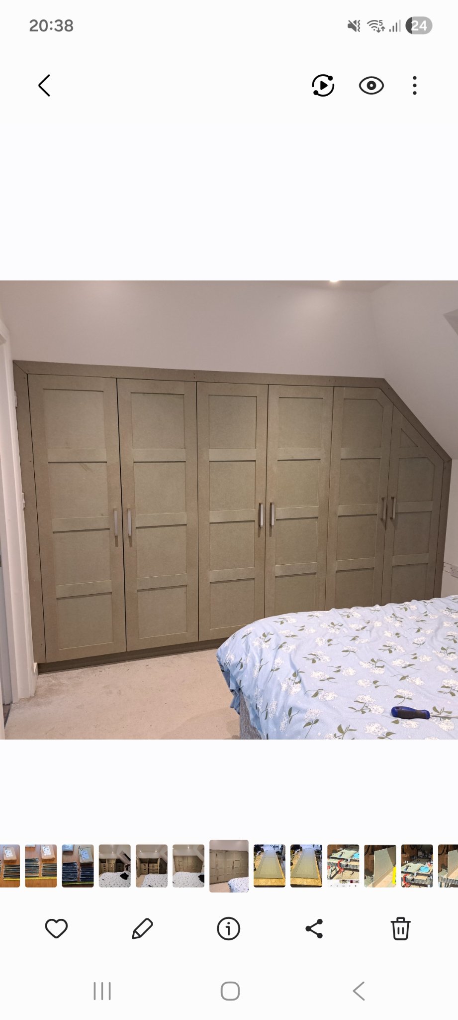

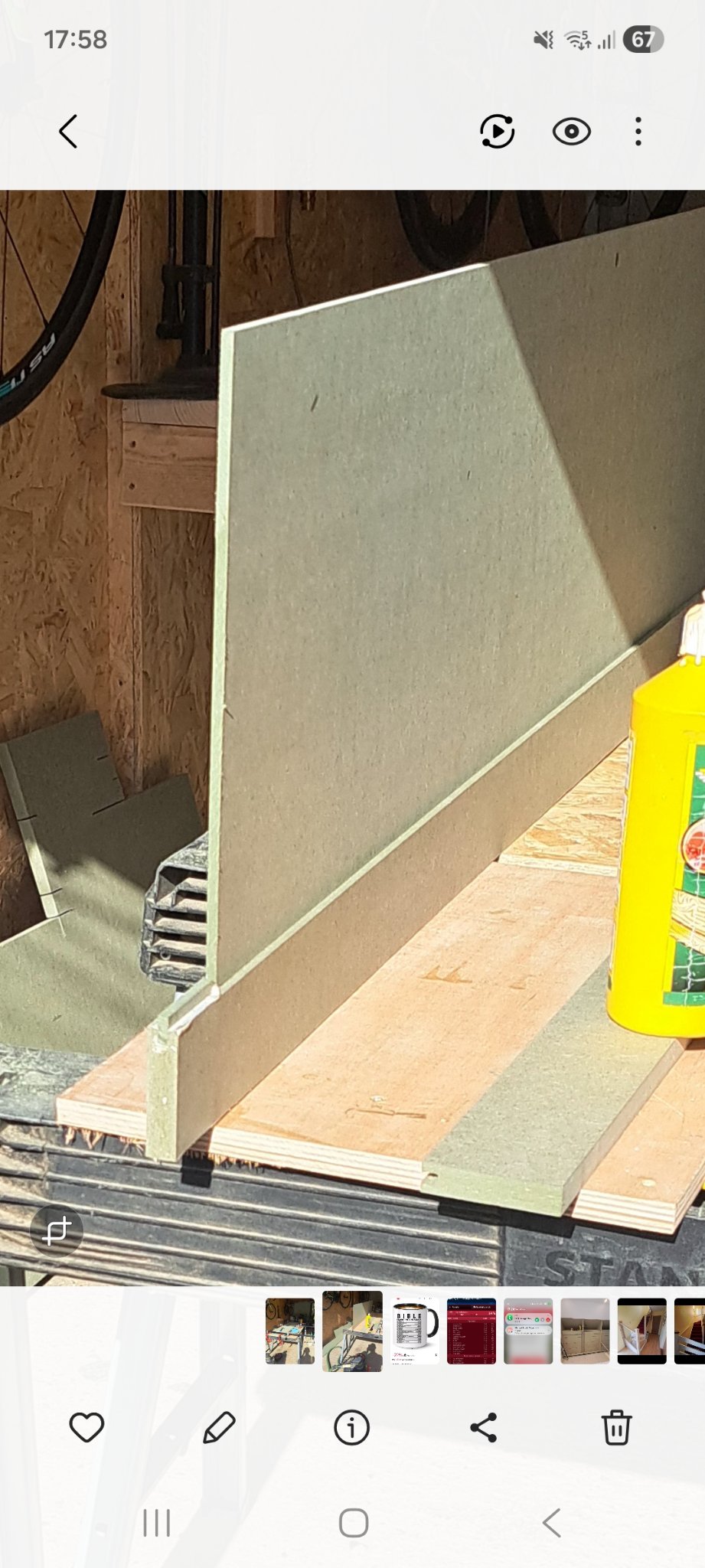

Last week I made some mdf shaker doors, ive always known the theory of making them, so i had a go - ive got all the gear "tools".
I could of made faker shakers, which i find to be amateurish, so bought some cutters and rebated the stiles and rails and glued in 6mm inset mdf panels.

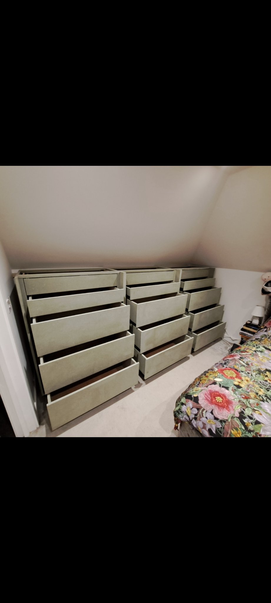

I'd already made the drawers a few weeks ago.
I am happy with the outcome, but im not happy with the flimsyness of the doors. I used 18mm & 6mm Moisture Resistant MDF.
I'm wondering if 25mm and 9mm MR MDF would give less flex?

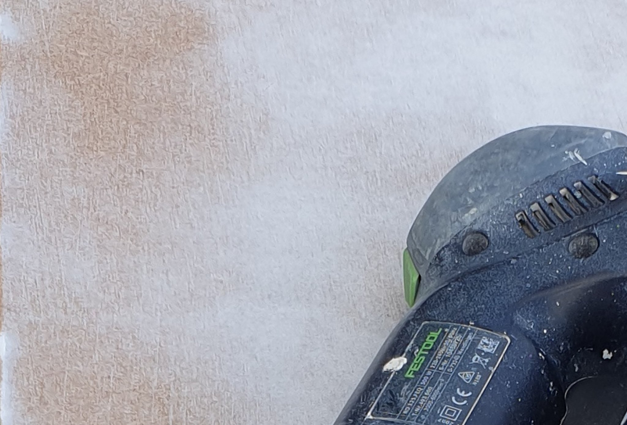

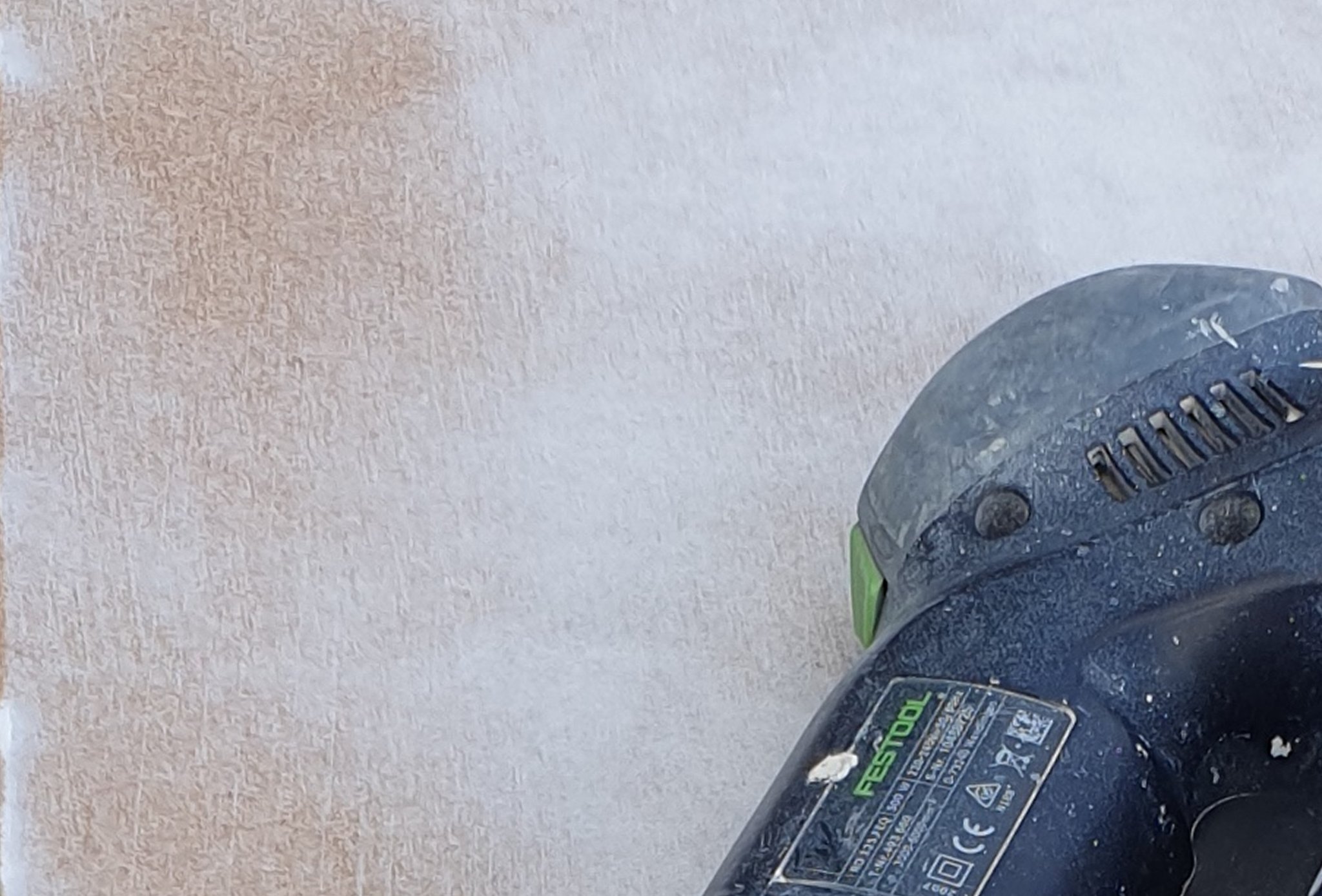

To be honest, as the painter, I was indifferent when it came to painting MR and non-MR. In some respects I preferred the latter. If I could see a slight ridge in the rail and styles after the primer, it was slightly easier to sand flat (in situ) when regular MDF.
From a painter's point of view, MDF is not "flat", it has factory sanding grooves in it. I assume each sheet goes through a large drum sander.
When painting, I apply a coat of primer and sand it until I can no longer see the grooves. The paint acts as a "search" coat.

Im now looking at changing to 22mm Finsa, it takes paint better than MR MDF and im going down the route of taping, but Finsa is £72 a sheet whereas MR is £39 a sheet. Which considering the picture above required 15 sheets of mr mdf the price difference is nearly double.
