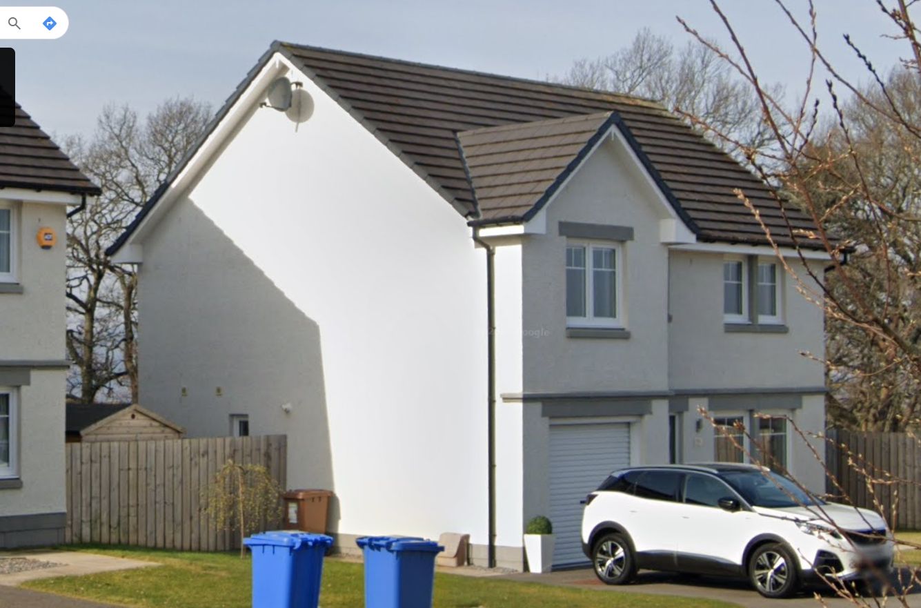

Stand back and take a photo, with something in the photo of a known height, you can use that as a scale and count the height
(you might even be able to do this off streetview)
Here's a totally random house I just found on streetview.
Look at the brown wheelie bin by the wall. 240l bins are approx 1m tall. So the gable end up to the top of that ridge is approx 7.5m high
