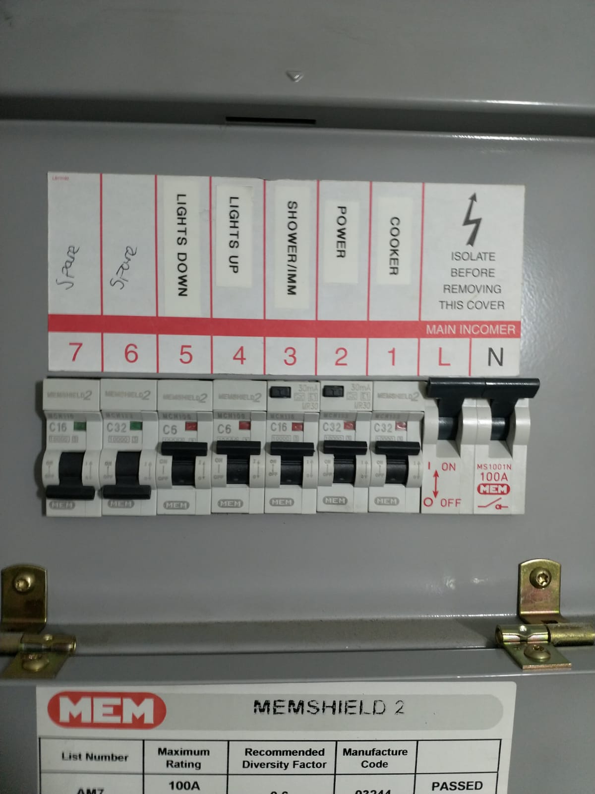

Hello,
I am looking for memshield 2 rcbo 6A, currently there is a memshield 2 fusebox (AM7) and there is 6A MCB (MCH106) i need to replace them with RCBO. Please can someone help where can i find them, I believe i will need MCH106r30 please can someone suggest where I can buy these?

Please show some photos of your distribution board/consumer unit "fuse board" and the devices currently inside it, and the space where you want to put the extra or replacement ones.
Who will fit and test it/them?
Please show some photos of your distribution board/consumer unit "fuse board" and the devices currently inside it, and the space where you want to put the extra one.
Who will fit it?
An Electrician will fit this in. As per image i need rcbo in Slot 4 & 5.

Memshield 2 RCBOs could be bought either preassebled or as seperate field-fit pods to add to a MCB. The item you have linked on ebay looks correct to me, the MCB part having the same spec as what you have in there already.
Whether it's a good idea to buy safety devices from the likes of ebay is another matter. The more paraniod would probablly avoid it but on the other hand people seem to have few qualms about buying used houses or cars.
P.S. a little note on testing, the memshield 2 RCBO pods (whether pre-assembled or field fitted) use the outgoing live wire for sensing, so they can't be tested by probing on the outgoing live terminal.
