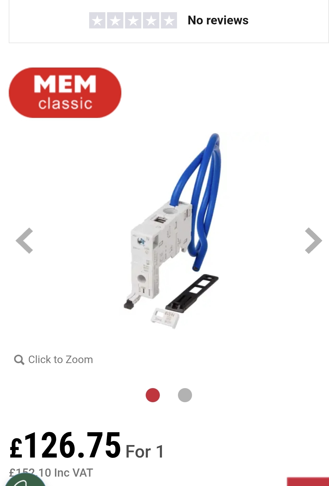

Hi, does anyone know if Eaton Memshield do a 32A C curve type A SPSN 10kA single module width RCBO to fit their TP+N DB.and if so, the part number?
I've searched every supplier I can think of and can only find solid neutral version. We'd need 9 of them.
Looking at Eaton's web site just adds to the confusion.
Failing that, a different make that would fit (it's not a consumer unit, this is a commercial premise).
Our electricians don't seem to be able to find them either.
Thanks.
Solid neutral (the description is "1-pole and neutral" not "1-pole + switched neutral")
There's memshield 1, 2 and 3 all different, memshield 2 used pods.
I believe mem 1 and mem 2 were sold off to Kempston control who now make current stuff to fit
Pods might be the answer, I'll check the exact part number of the MCBs. They've been in for over 15 years, I think (no sign of an EIC)
I've never been aware of a DP Eton RCBO in a single width module - but I'm not in anyway saying they don't exist! Not pretty but one solution to retrofit is add an additional enclosure filled with RCDs.
It's not gonna be cheap
Yeah, they're about £100 inc. each. So £900+ labour. Not actually that much in terms of the amount of other work needed on the building in preparation for a new, fully repairing, lease.
I'd be tempted to go for sunrays idea... separate enclosure filled with rcds
Saying that by the time you've messed about it'll probably cost as much.
There's a faint chance I might have an old MEM catalogue somewhere.
I used to use pods in the Memshield 2 days (the RCBOs also fit in Memera 2000 and AD). Going back around 25 years.
They look like the one in your pic. IIRC they have no breaker inside, just a trigger that flicks off the MCB you attach them to.
