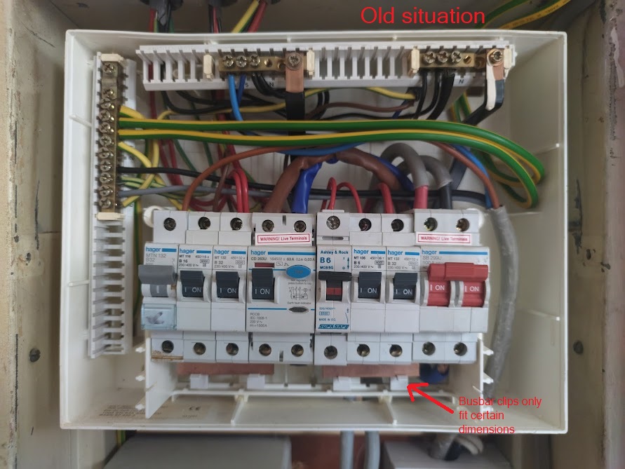

Hi DIYers!
I just moved in and I needed additional breakers in the Hager Consumer unit (VECOS33-6H), but there was no space and no way to replace the unit with a larger one.

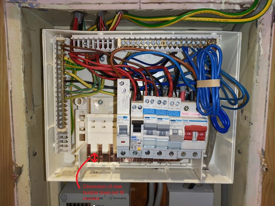

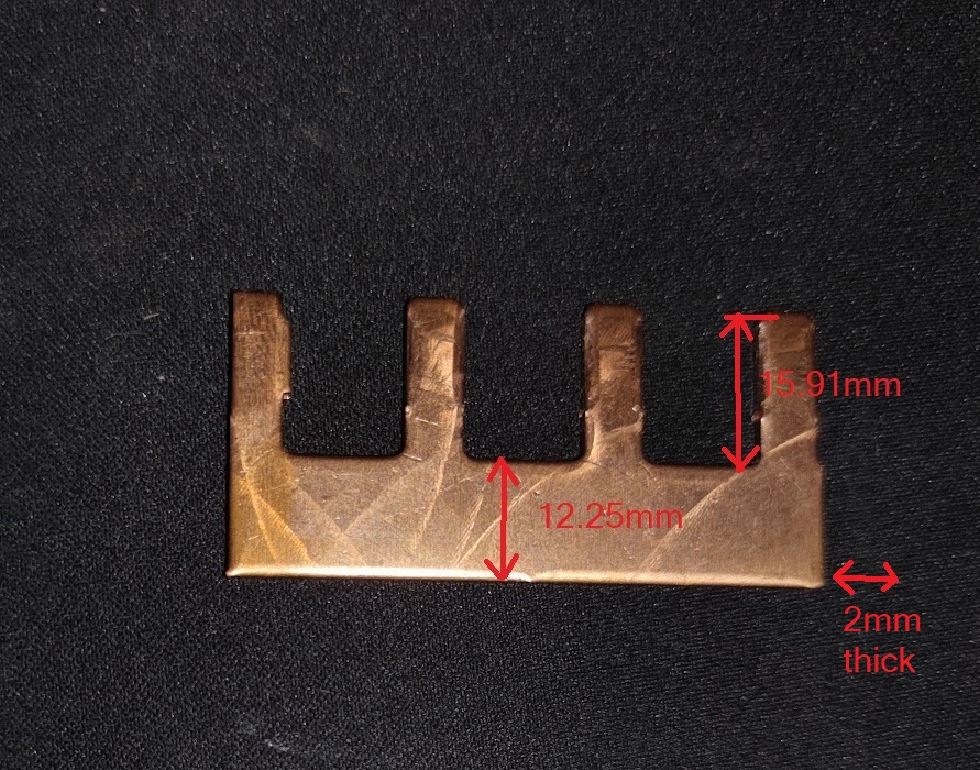

Since it's a split unit, I freed up space for additional breakers by replacing the existing ones with RCBOs and removing the RCCB. However, the split unit used two small busbar so these needed replacing with one long one. I picked up a long BG busbar from Screwfix and cut it to size. I thought they're probably standard sizes, but the bottom part of the bar is too tall for the clips that hold it in place. And since I can't use the clips, currently it's only held in place by the breakers themselves, which is not ideal (See pictures).
I think the only solution is that I need to find a 9 way busbar whose bottom part is approximately 12.25mm and is rated for 100A. Google has so far given me a few results for busbars, but there are no dimensions included. Hager doesn't produce these flat types of busbars anymore and googling the model number didn't yield any results.
I prefer not to order a bunch of busbars hoping that one of them fits. Any ideas?

Disclaimer: I just moved in, not very happy with the location with the consumer unit nor the cabling situation. BG electrics RCBO will be replaced with a Hager equivalent soon. Large Type B RCBO is needed for solar panels. It's a work in progress but has already improved a lot.

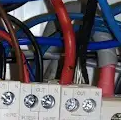

A genuinely competent person would not leave exposed tinned copper Neutral conductor
It's a photo from a few days ago. It was dark when I was writing this post. As I mentioned at the bottom of my original post, I was improving the previous situation and this photo was taken while I was working on it. Having the neutral conductor exposed during testing is quite different from leaving it exposed generally.
Having the insulation on the conductor chewed off like that is not desirable at any time.
