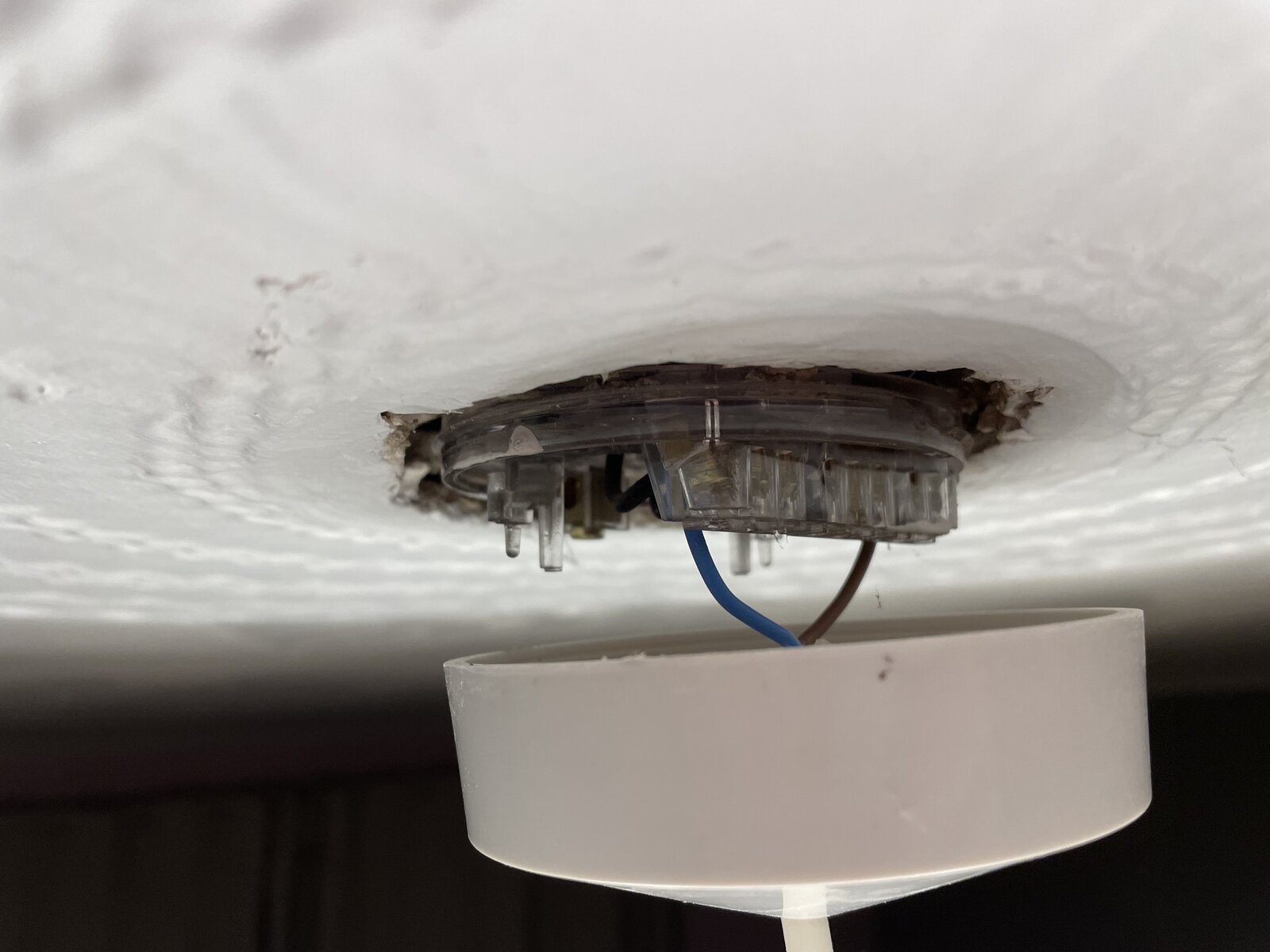

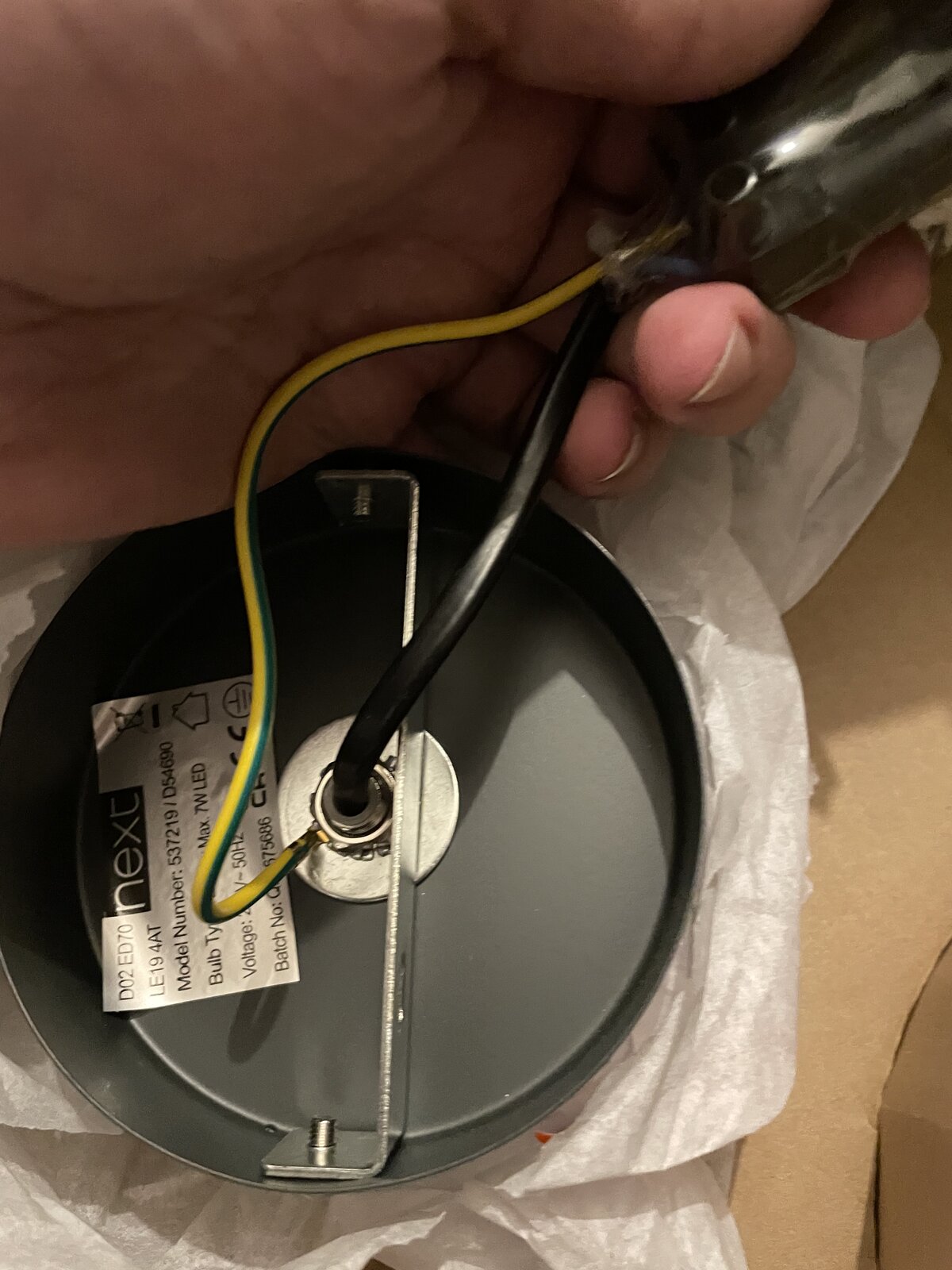

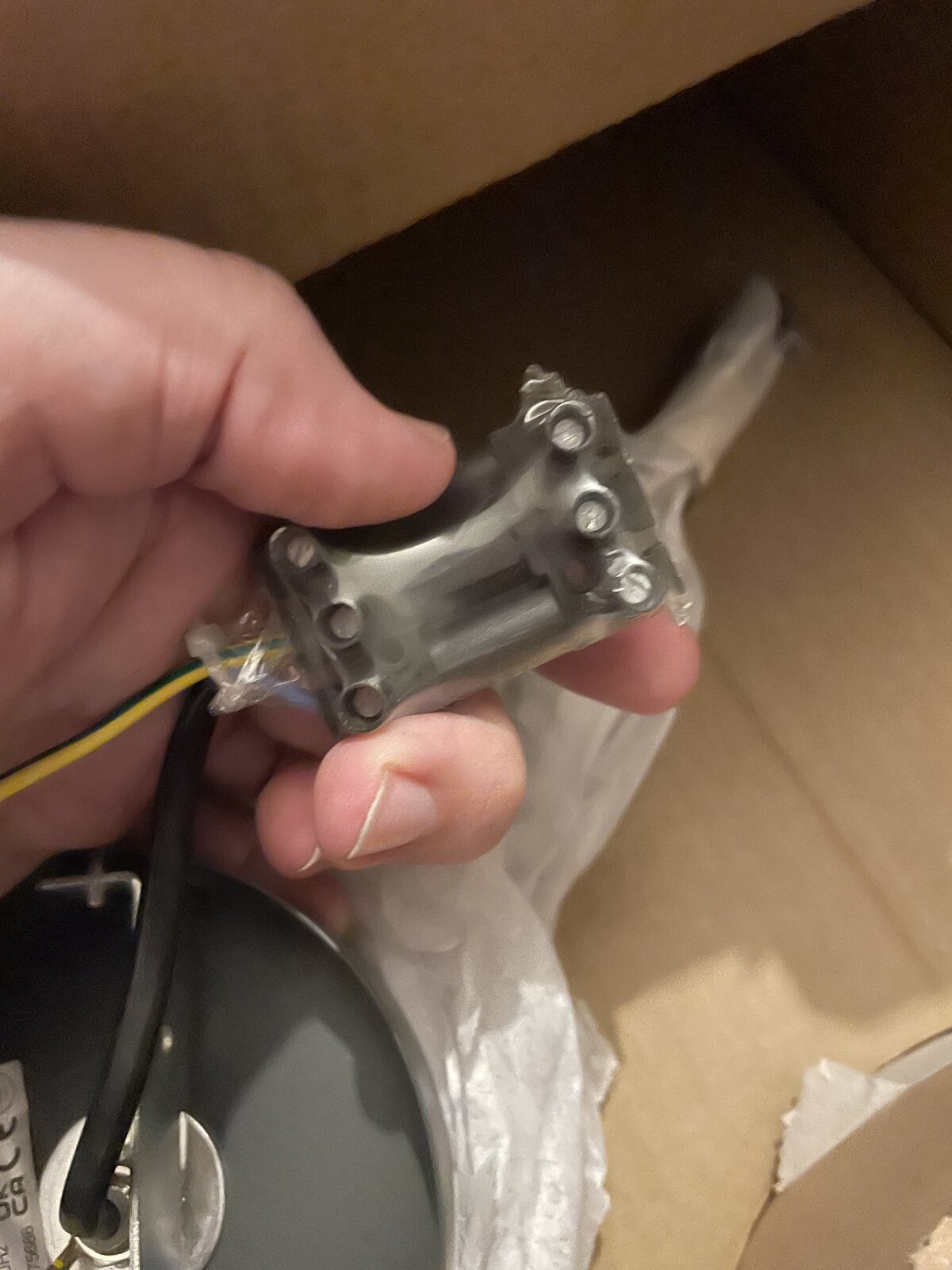

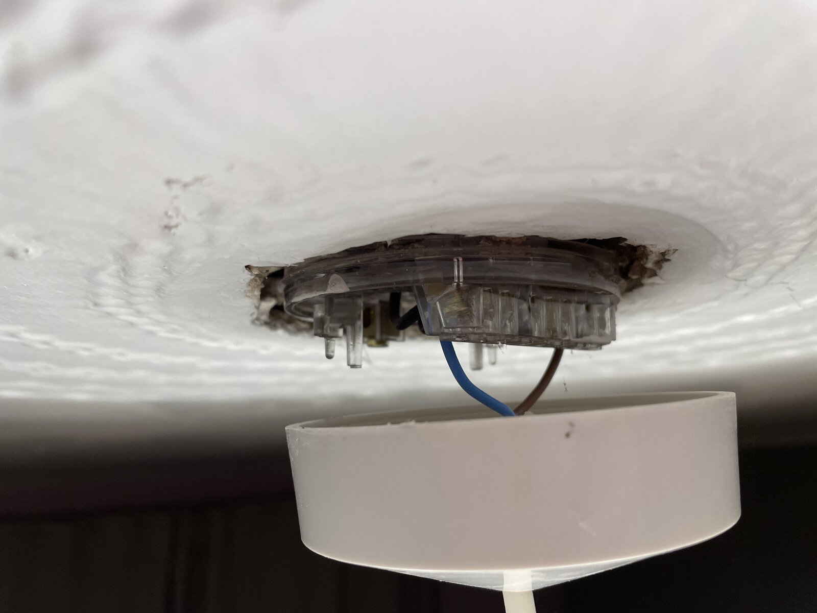

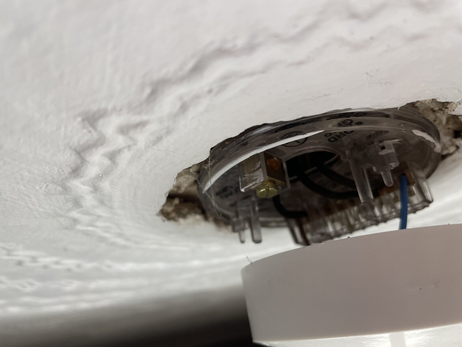

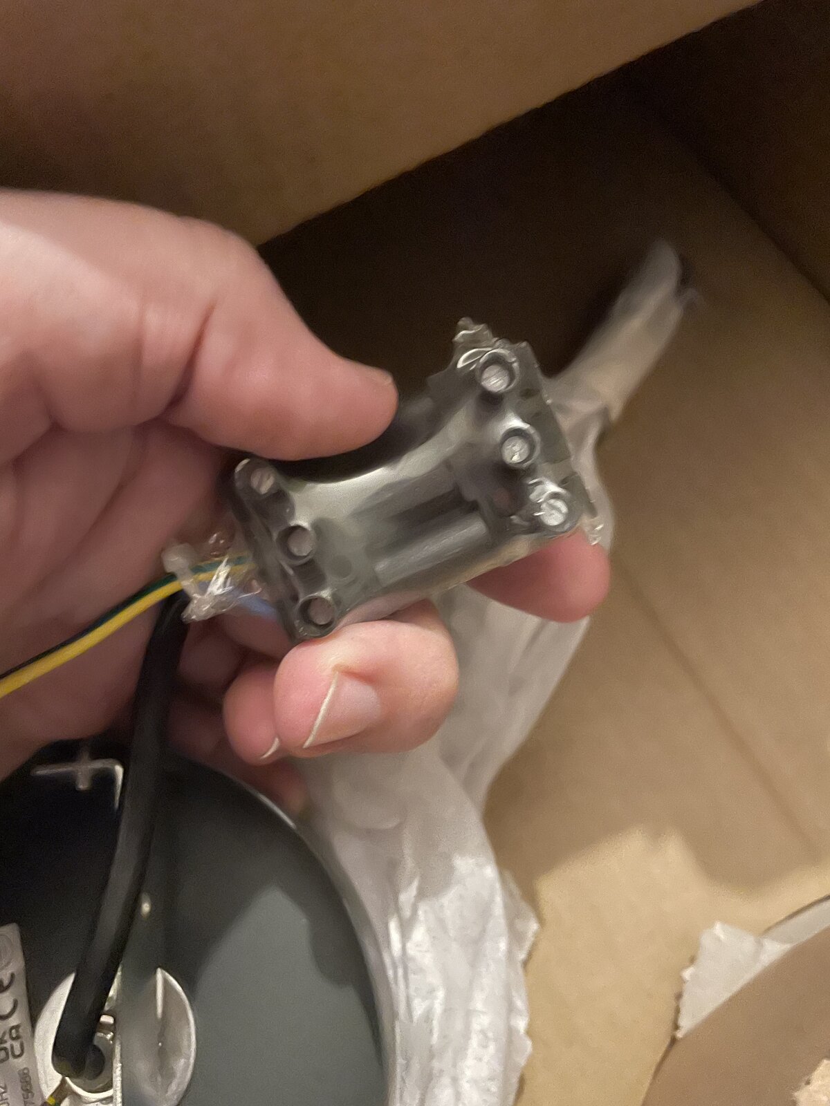

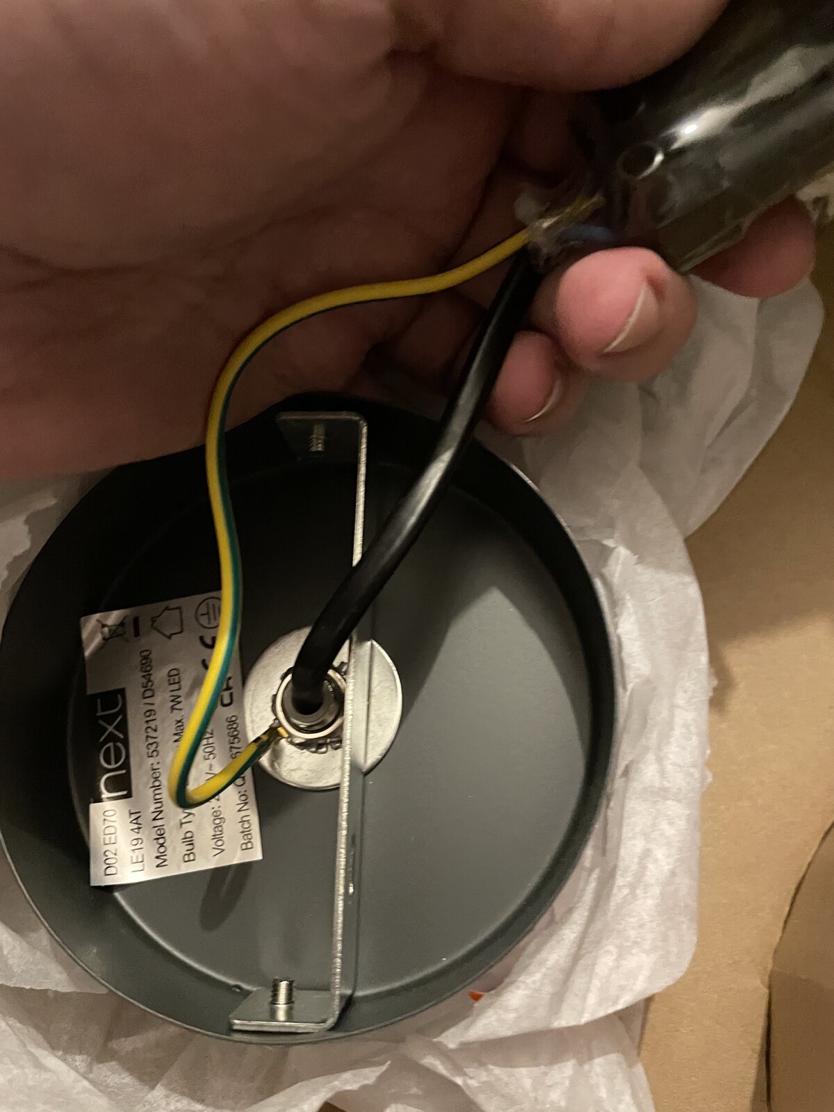

Hi All,
My partner on a whim has purchased a new living room light, we currently have the dangly kind.
I’ve taken a quick look and it appears we may not have an earth wire so might not be able to switch the ceiling light now.
Before I call in a professional to help switch the lights I’m hoping someone here might be able to confirm my suspicions and that without earthing we won’t be able to use the light.
I’ve attached pictures of the current wiring and of the new light wiring and provided a link to the light below.
https://www.next.co.uk/g792024s9/537219
It looks like a couple of black wires, a blue one and a brown one?
I really do appreciate all of your help.

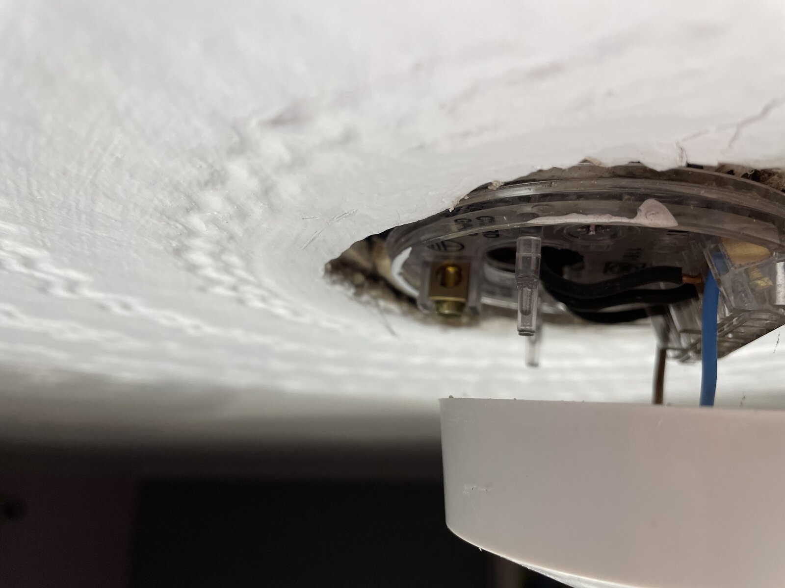

Switch off the power and unscrew that rose (leave connected and ease forward if there is enough slack), chances are you'll find the earths bent back on themseves into the ceiing along with the live loop (3 reds together in block)
When you do come to disconnect, mark (dealy with red sleeve or tape) the black that goes to the brown of the flex, you'll need to tel it apart later

does the wiring look modern enough to have an earth? The rest of the house looked like it hadn’t been touch in over 30 years!
I know the extension part of the property has earth which is solid green colour as I could change those lights (done probably in the 70s at least seems that way)

The black wire that goes to the brown is the live, and the blue wire is the neutral.
Make sure you write that last bit down. Don't try to just remember it because you will forget/get it mixed up.
The edition of the IEE wiring regs that required earths on lighting circuits apparently came in in 1966. However I don't think everyone actually followed the IEE regs in those days so it's possible an installation with no earths may have been installed slightly later.
There was a relatively narrow window in which plastic insulated fixed-wiring cables were made without an earth wire. So usually old rubber and lack of earths often (but not always) go together. Old rubber is it's own can of worms.
Sometimes it's possible to guess what material the insulation is made from from a picture, but I don't feel confident doing so from your picture.
Interestingly the rose itself looks fairly modern, I would guess some sort of fancy light fitting was fitted in the past and later removed.

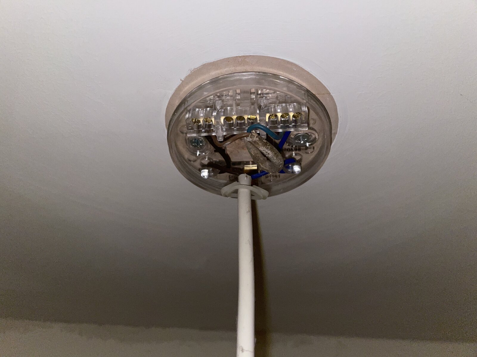

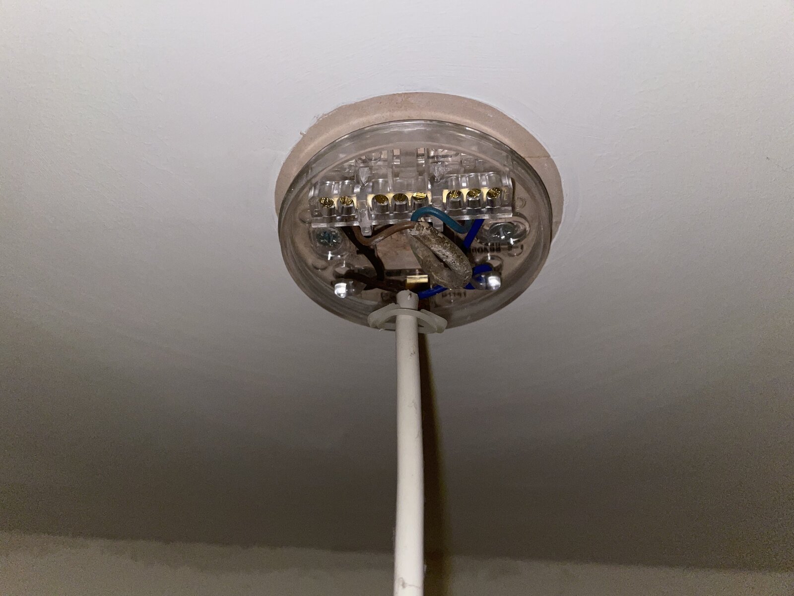

I popped open the one in the hallway next to the living room and appears to be no earth cable connected to this one either. Thinking I might just have to suck it up and have a full rewire. I’ll dig around the cavity in the living room to see if I can find an earth but I’m not feeling optimistic!
Again that fitting in the hall doesn't have any earth wires visible, nor does it have any permanent lives visible.
Also in both cases the pendant bases are transparent, I could be wrong but that is something I associate with relatively modern pendants.
This time though instead of individual wires coming into the fitting, the wiring coming into the fitting is 2 core flex. My guess is that there is a junction of some sort hidden above the fitting. Maybe even a second pendant base.
My best guess is that the original pendants were at some point replaced with fancy fittings. Then at some later point the fancy fittings were changed back to basic pendants (possibly because the owners wanted to take their fittings with them when they moved out). Unfortunately many fancy fittings do not make provision for UK style loop-in wiring, so it's quite common for people to stuff wiring up in the ceiling void when they can't fit it in the back of the fitting.

The first pics show a classic loop-in at the light and as Adam wrote I'd expect to see the reds joined above the ceiling, having previously had a different style of light fitting.
The pic in the hall looks like a twin flex to me and again quite classic of a different light fitting and some sort of junction box withing the ceiling.

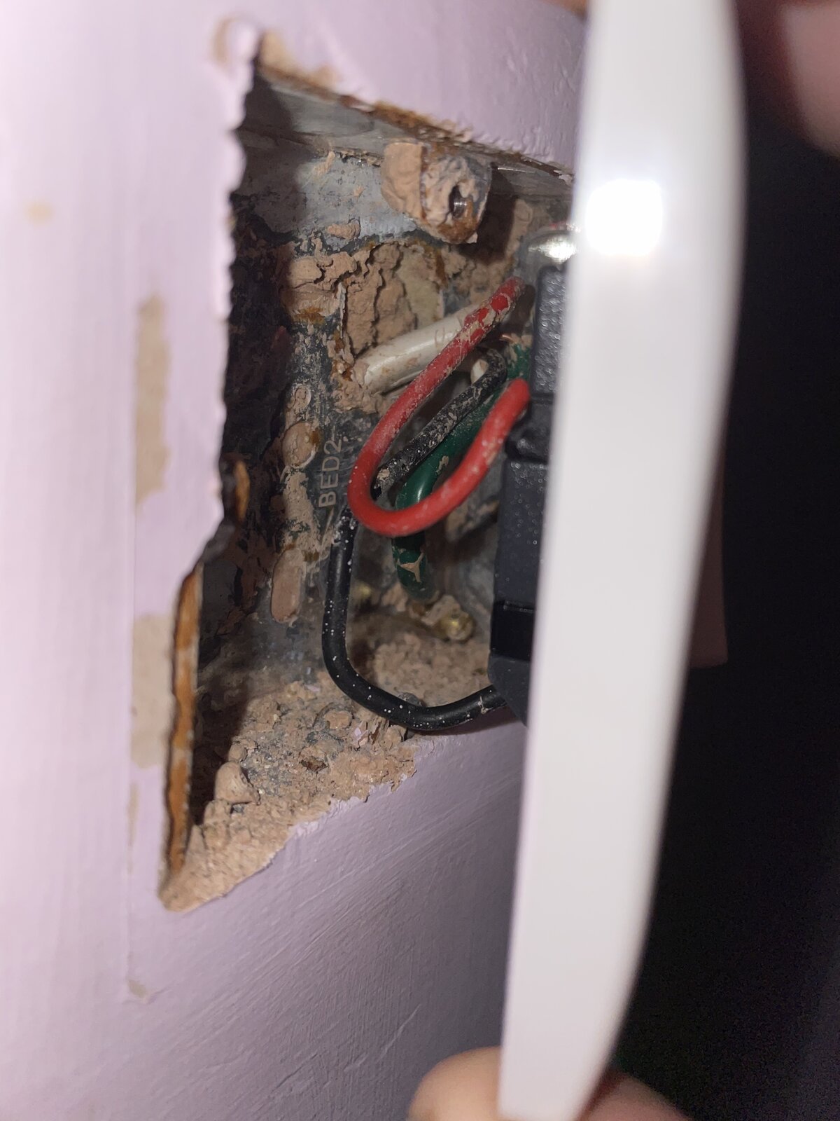

Thanks Sunray, I’ve just taken a picture of behind the switch for the living room light which we are hoping to use a class 1 light fixture on. It’s not the greatest but hopefully clear enough! The hallway switch is the same set up as this one it appears.
I think it might be T&E wires, although I’m far from knowledgeable so will leave it to experts!

That's pvc twin & earth. Very old solid green sleeving, so early 70s probably. But doesn't mean the earth core is actually doing anything.
Switches might've been moved at some point and cable added to.
The insulation at the lights doesn't look red. One of them at the light looks like could be black sleeving which seems odd.
