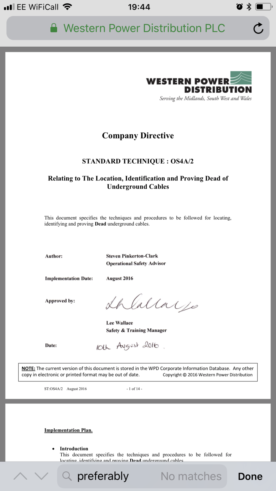

I have just read the document, Here are some facts, it told me nothing I did'nt already know, It does not contradict anything I've said.
It did show me that you have mis-read the document eg you stated that it says all HV cables have to be spiked with the exception of sheath repairs, that is not true, you have missed out the word "preferably".
Once you try to mislead everything else you say can be ignored. I've seen it a few times before with a few dishonest contractors that end up severely regretting their mistake. Because it means from that moment, all verbal communication stops and written communication starts and that means highlighting every little mistake to the whole construction team.
Sorry, I don’t quite understand how I could possibly have missed out a word that does not occur ONCE in the document.
What were you saying about misleading?
Apologies, I misquoted it says -
When a HV cable has been identified to be worked on, in all circumstances other than those set out in section 6 below or if it is fluid filled, it Shall be proved Dead before work commences; normally by spiking with an Acvoke cable spiking gun
"normally by" does not mean "always" or "everytime"
So you are still wrong
I’m aware what the document says, but I’m also not basing my information solely on said document, that was for your information.
I’ve had many a conversation with various WPD employees about jointing and they are under strict instructions to spike cables on every occasion in the field.
The use of the word normally is there because obviously, as with everything, there will be 1 occasion out of 1000 or more, where a spike is not necessary i.e. the whole cable route is exposed back to the origin and can be verified as dead.
In reality its round the other way, a spike is not normally required.

However, as I have hinted, I imagine that one exception might have to be that of an 'unknown' (unknown source and destination) cable which is 'probably live' which has been found in a hole in a road. One presumably cannot safely dissect out the individual cores, so probably has no choice but to assume that it is live but nevertheless chop it 'in one hit' (whilst 'standing back' :) ) ... or is there some other possible approach in that situation? To 'de-power' an entire area would seem a bit excessive.
Kind Regards, John
A cable can only be opened up after a proper cable id is carried out.
We can’t kustbopen up an unknown cable.
If it can’t be id’d via pulse or echo, then it must be traced - which means digging until you find the other end or branch joint etc.
