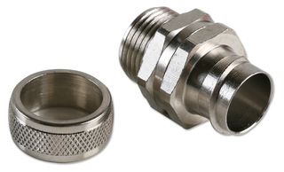

Presumably you earth it? How easy is it to get a 'reliable' electrical connection to it, and how does one do that - does it perhaps come with some sort of 'glands'? (you can tell that I've never used the stuff!)
Kind Regards, John
You use a gland like this. The coarse thread screws inside the kopex, and the other side is a standard M20 thread.
It's never going to be a guaranteed connection and could be pulled apart without too much aggression, which is why the regs don't allow it to be used as a CPC.

Thanks. Not that much different from the plastic 'glands' I have used for flexible PVC conduit, which I've occasionally used just to reduce the risk of 'abrasion damage' in places like garages and cellars!
