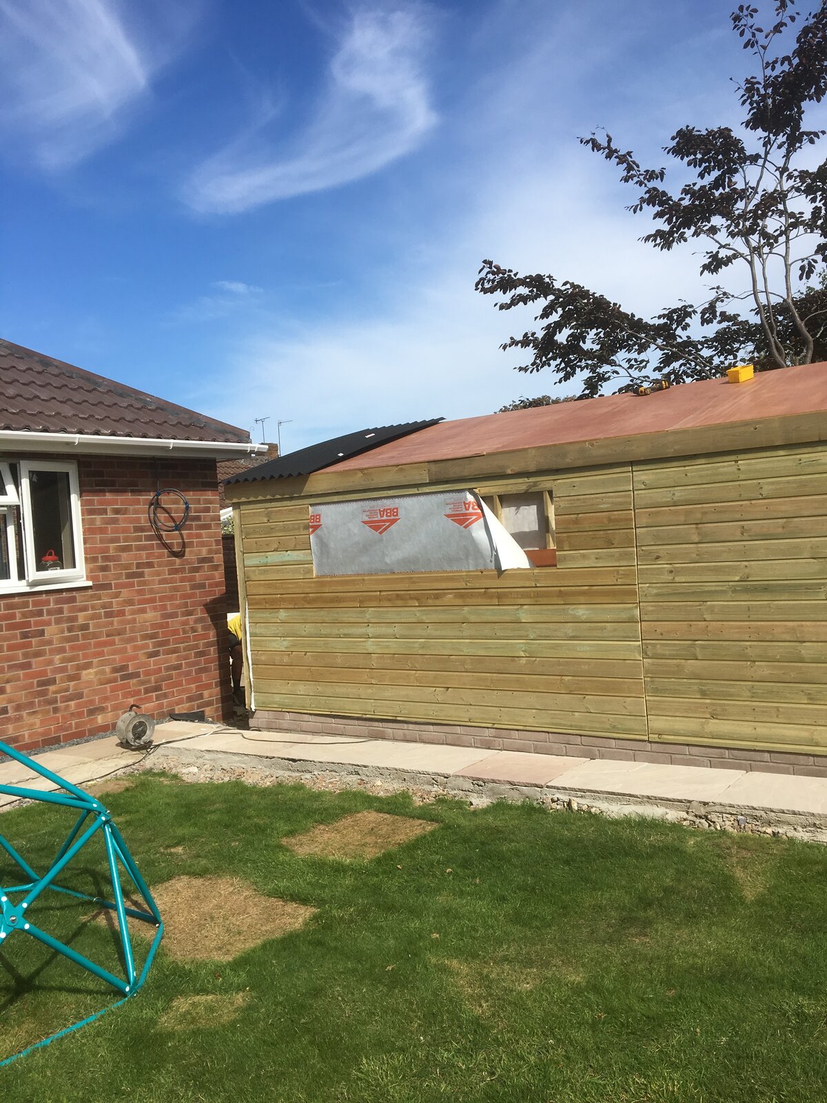

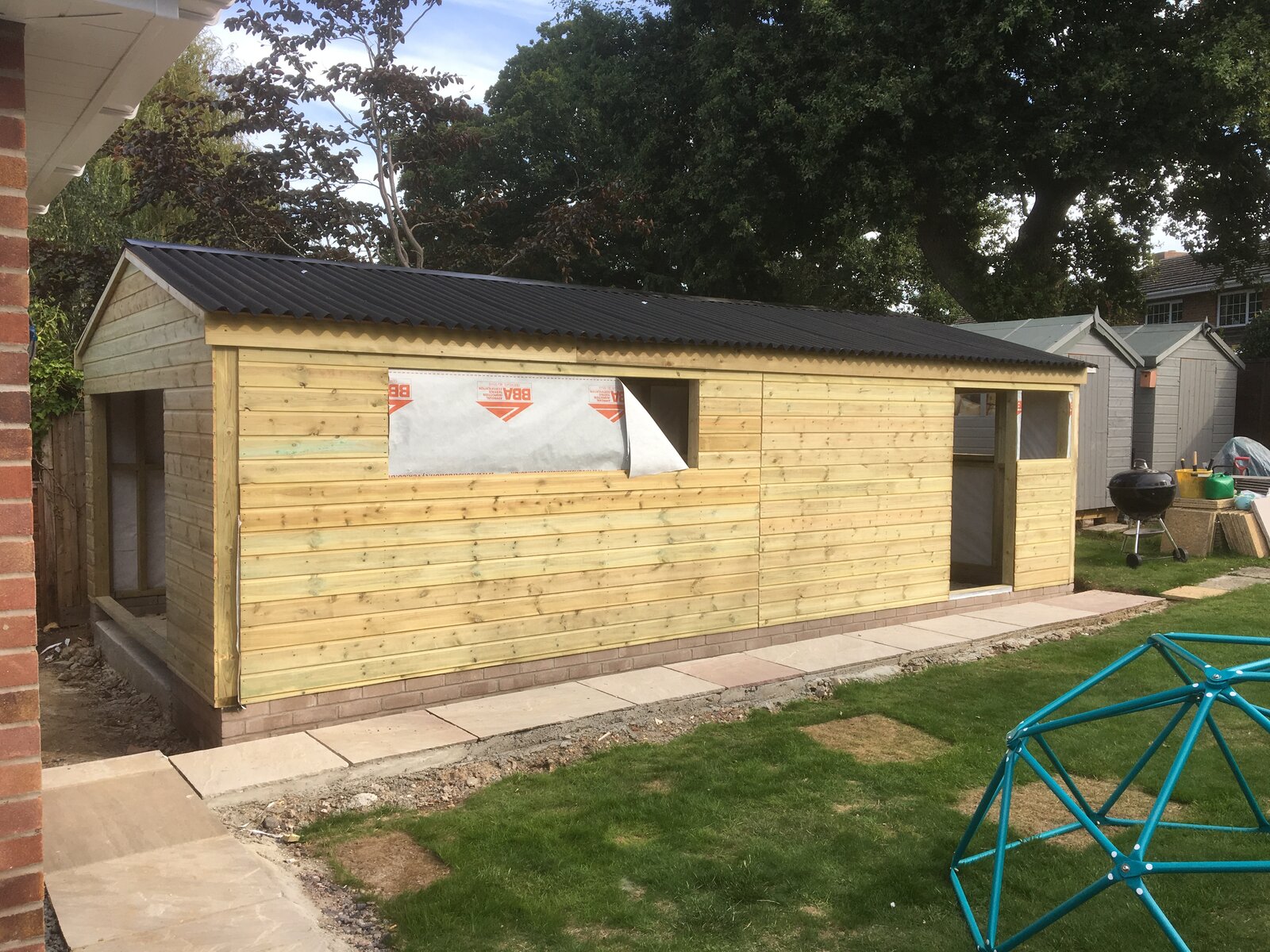

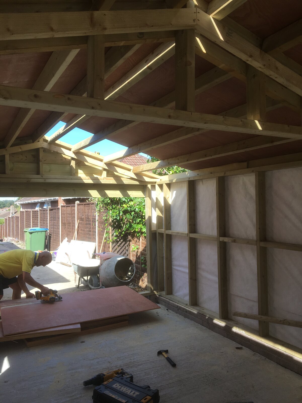

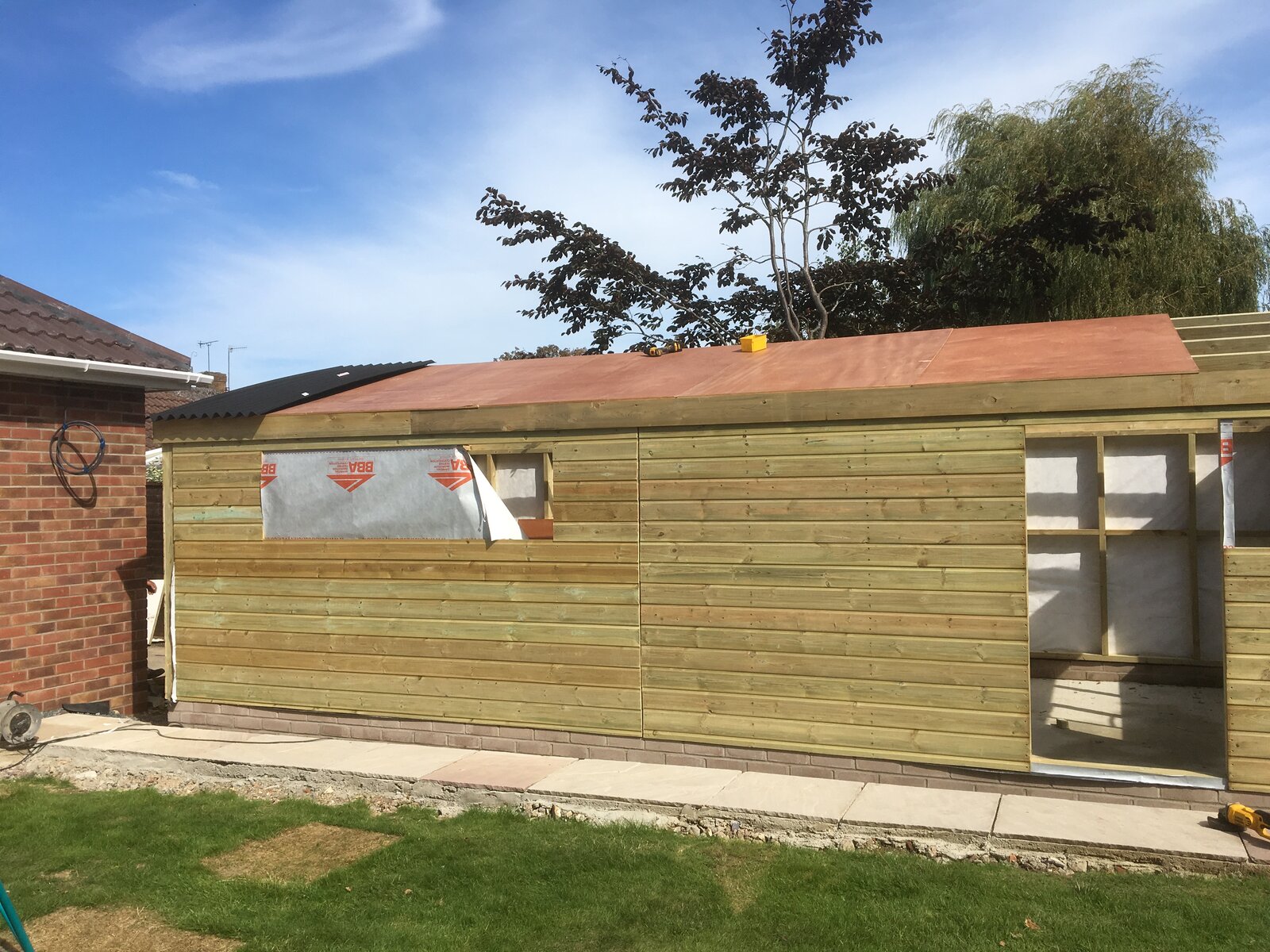

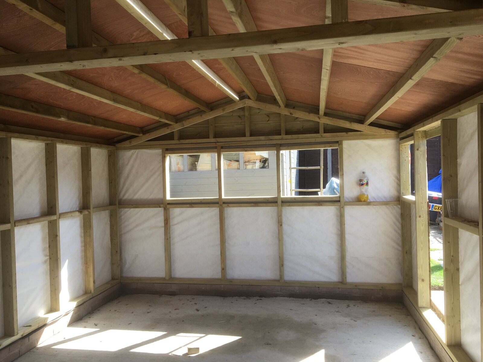

Don't go for steel use a corrugated rubberised roof. Use marine ply to form the roof and then fasten the rubberised sheets onto it and through into suitable timber supports. 9EDA206A-7D48-467A-B9E2-BD9675D7B9B3.jpegDCB0DB7E-A983-4CC2-BF08-3B7BC46BAD34.jpeg4DE999BC-AC8F-4114-8EE9-C921B6F75648.jpeg9F4FCDDA-440A-44BE-BB2E-B1224893AF26.jpeg
The rubberised sheets will keep condensation down but go limp in the heat hence the ply backing to help support. Slight gap at the apex provides ventilation.
There seems many ways to construct a roof using sheets but it's which causes least issues. If the trusses are sheeted in ply first then the metal sheets added on top, will this stop the condensation inside or will moisture just form between the ply and the metal sheet causing rot? I take it the foam fillers are added between the top of the ply sheet and the underside of corrugated sheet to stop insects? Do they not block the air movement between both sheets?
@Old Salt thanks for the photos, looks a neat job. Are they the black bitumen sheets? I've attached these vertically on the back of my summerhouse and screwed on to OSB board. They've been good for 7 years so far but quite shielded.
That’s the ones, had brain failure last night and couldn't remember what they were called, lol. My roof has only been up about 18 months but seems to be wearing well. I used the foam inserts at the ridge to prevent leaves being blown under the capping into the garage. They were fitted after installation and just tucked in. They will still allow some air movement, at least they do in my garage.
@Old Salt, was there a reason you chose them sheets instead of metal? I thought metal would of lasted a bit longer. Have you not had any issues with the wind blowing rain back up and it leaking in from the ridge?
I priced up doing it all in bitumen and it came to £900, slate would be £1000, but then I'd need a lot more trusses plus the fitting labour.
Metal sheets will be really loud when its raining. Rust over time and look sh1t. The capping overlaps about 150mm each side of the apex and I have only ever had leaves blowing in hence why I fitted the foam corrugated fillers
