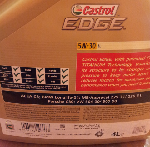

I use and like Castrol EDGE 5W-30 LL. But, castrol does not recommend this oil for a micra k12. The following is the nissan oil spec for the car. Anyone knows why I shouldn't use the LL oil? Castrol recommends edge 5w40 instead. I want to harmonise the oil for the couple of cars I am playing with.
How many miles does the engine have on it? As others have said, 5w30 is a bit thinner than the 40 when hot. Personally, I'd use the thicker stuff unless the European engine was specifically designed for it, and if the engine is fairly worn, I'd use the thicker stuff anyway. However, it's really down to how much you want another fraction of a mile per gallon from the thin stuff, compared to how much you want your engine to last a long time.

Anyway, it turns out there are a lot of BS in oils. For the same oil name and 0w00, the oil spec changes over time. The only guaranteed spec you have is what is actually printed on the bottle. The identical looking bottles can have different specs on them, depending on what years and location of manufacture. The oil I need is ACEA A3/B4. The latest Castrol Edge 5w30 and 5w40 are ACEA C3. C3 is slightly worst for petrol engines with weaker endurance. But, for low mileage/duty cars, it won't matter.
Strange that you're willing to believe what the oil manufacturer prints on the can, but not what the car manufacturer prints in the handbook?
I have used the thinner 5w30 (although with correct spec) with no problems. The engine will last because it is low mileage driven - not low mileage in total. I briefly tried mobile one 0w40 long ago. I did not like it. It made my engine sounded like marbles in tin can. The micra is low mileage in total.
You need the correct spec and the correct viscosity. You can take tens of thousands of miles off an engine's life by using a viscosity the engine was never designed to use. Sometimes, for older engines, the correct spec is no longer available, in which case, the manufacturer's service info will be updated with the next most appropriate spec to use.
