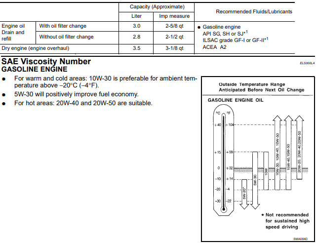

I use and like Castrol EDGE 5W-30 LL. But, castrol does not recommend this oil for a micra k12. The following is the nissan oil spec for the car. Anyone knows why I shouldn't use the LL oil? Castrol recommends edge 5w40 instead. I want to harmonise the oil for the couple of cars I am playing with.

the Nissan spec looks like it is written for the US market
The SG/SH/SJ specs are old versions for petrol engines, without friction reducers.
They were (are?) necessary for bikes with wet (oil bath) clutches, engine oil shared with gearbox
I wonder why Nissan specs them?
Is it a very old handbook for an old model?

It's a factory service manual I found on the internet. It's definitely for k12. The car is 2004, quite old, but lightly driven. Regardless, this engine seems able to take a wide range of oil. What is the effective difference between 5w40 and 5w30?
the '40 is a bit thicker when warm
the handbook will probably show you the grades recommended for different operating temperatures, and the two oils you mention will probably overlap and both be suitable in temperate European climates.
As you move to unusually cold (or hot) conditions you may be operating in temperatures where one is more suitable than the other.
A thinner, low-friction additive oil will save a bit of fuel in a modern engine in good condition.
