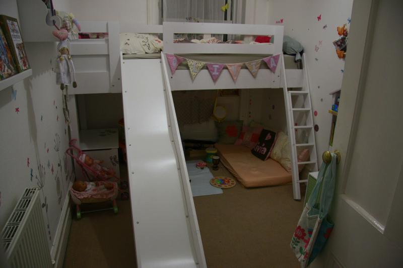

Hi!
I finished the bed some time ago and I would like to show you the effect of your much appreciated help.
I am still going to do some lights and possibly design a different ladder.
Thank you very much for your help!
