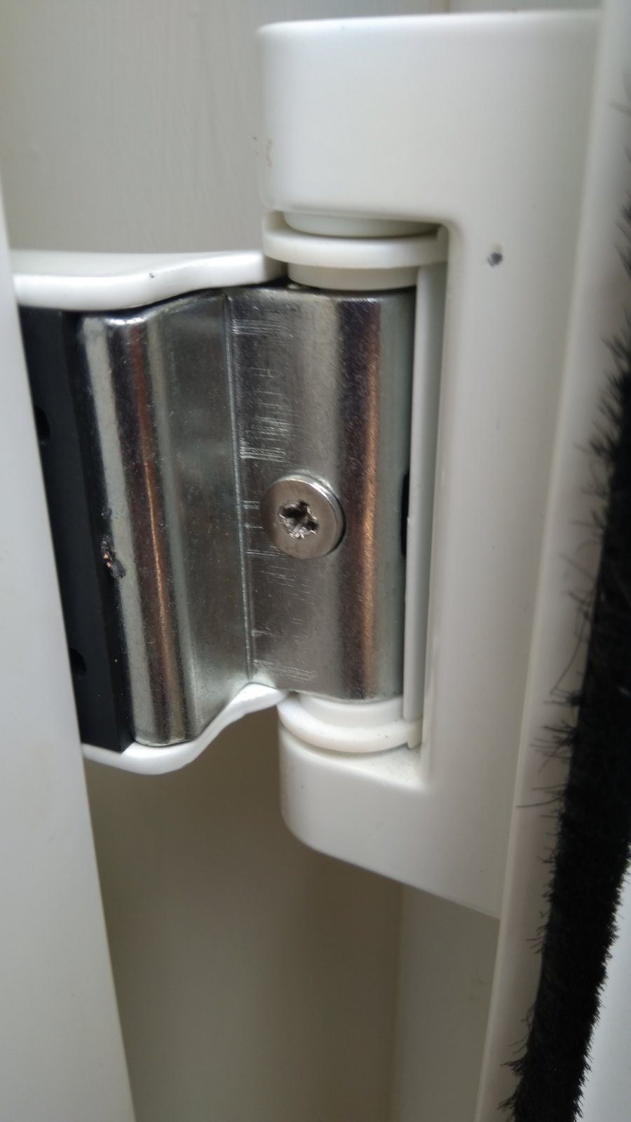

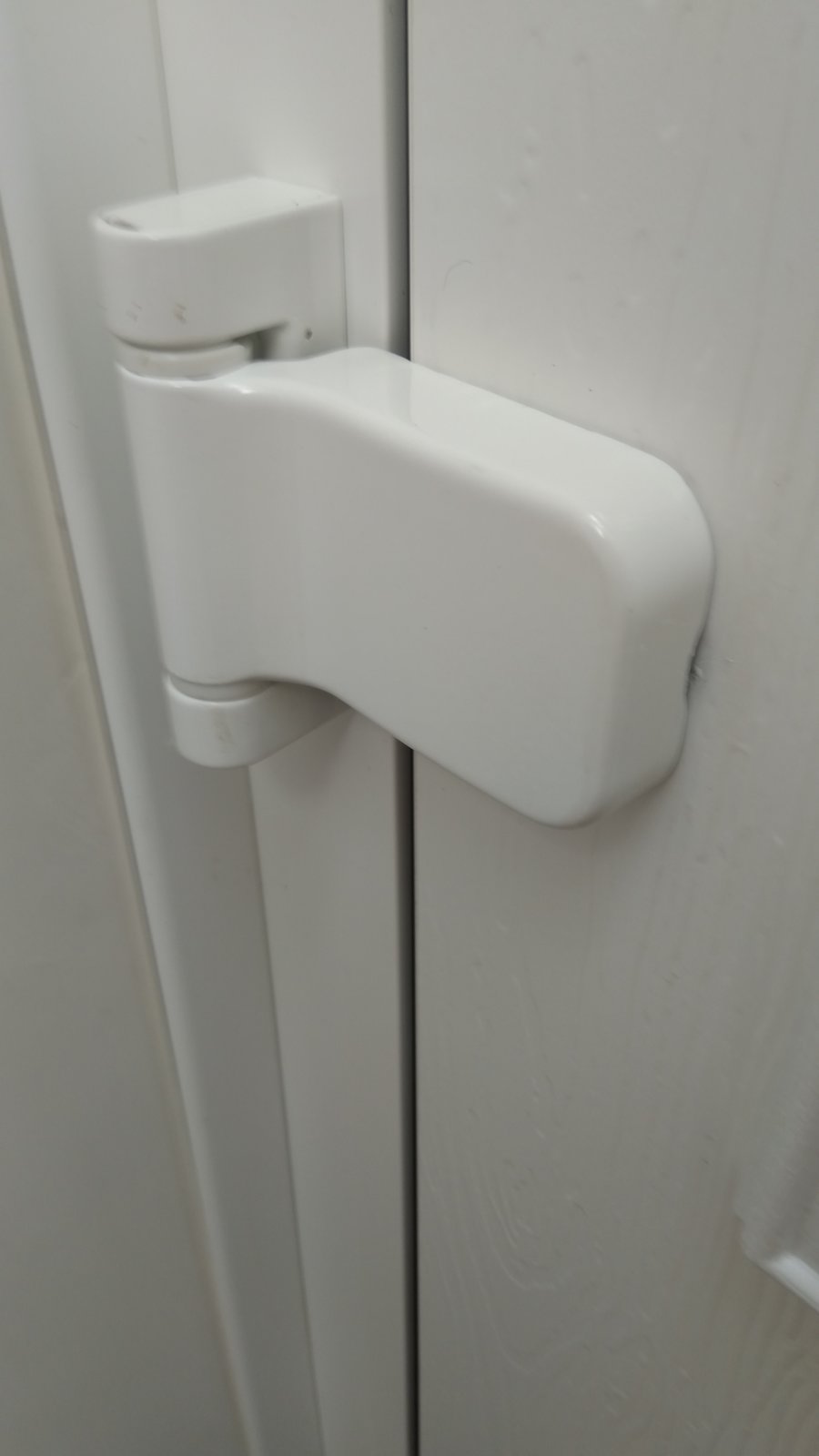

Hi all
Had a composite door fitted a year ago and it appears to have dropped on lock side..catching frame slightly above handle. I'm a novice but it looks like a flag but hinge. I'm assuming I need to adjust laterally but I cannot get the hinge cover off!
Removed security screw visible from outside when door is open and then supposed to put 5mm screwdriver in small slot in hinge cover twist it to remove.
It is very stiff worried it will damage door or hinge. Any tips gratefully received.
Will try and upload pic but not hopeful, my last attempt was a dismal failure.
